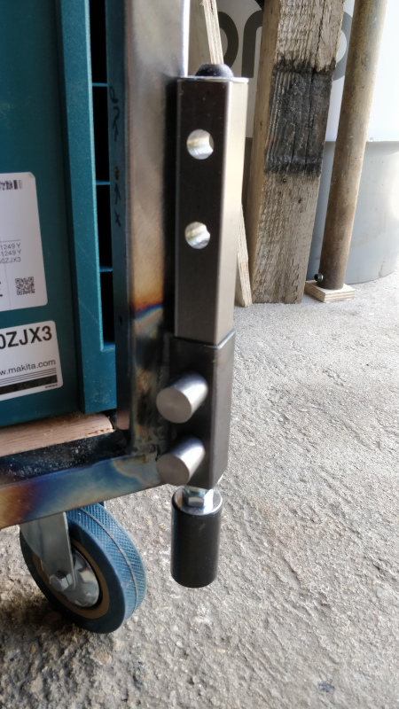

Nice welding, but what was the direction of travel?Job for the local skip man laser cut profiles welded with 2.5 root run and 3.2 dual pass not under much pressure in use but drivers always manage to make it rough View attachment 230826View attachment 230828 View attachment 230829 View attachment 230827
It looks to me like that hook assembly is on the tilt.
If you welded even slightly downhill you can have some issues.
Obviously it is electrode and amperage dependant, but you can suffer from slag entrapment or porosity, particularly with 7018s.
I had to redo about 3m of welding, three pass, grind all the old weld out 40ft above the Thames. All on the ropes.
