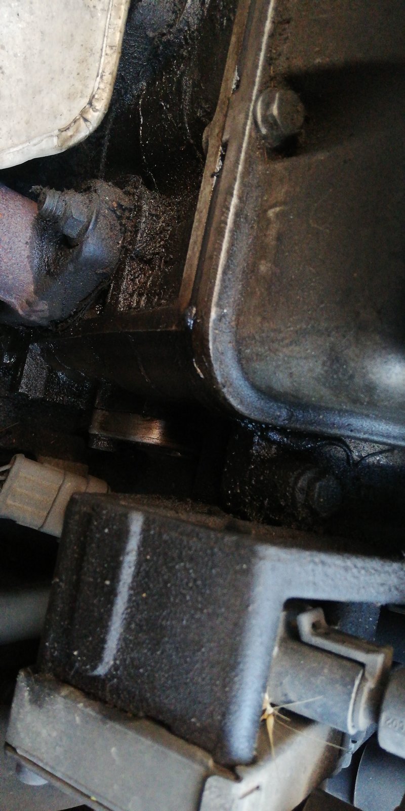

I've discovered a loosen bolt on the rocker arms cover .
It's hard to me to believe that in 180km ,2.8 litres of oil could have leak out from there

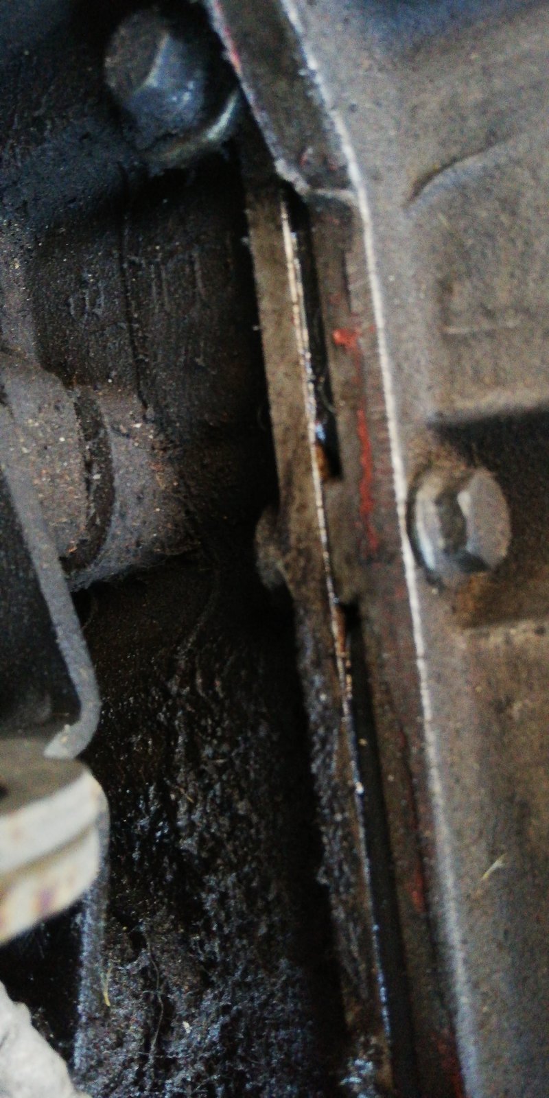

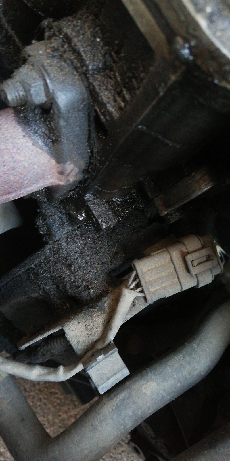

The engine is covered with oil ,I believe that the head cover gasket is gone .
There were few loosen bolts on this cover ,I hope that's just this .
Rocker arms cover ,I've written the correct name before but was too long name .I suspect you mean the rocker cover gasket [right on top of the engine] had slack bolts - if so, remove the cover, clean everything thoroughly and refit, using a new gasket.
If the head gasket had blown, the engine would be down on power/losing coolant/in small bits or any combination of the foregoing.
Can you post a pic or video?
Looks just like when I had a rupture on the oil cooler hose, sprayed nearly 8 litre engine oil on the exhaust
I missed the bit where he said 180km, that would be thick blue smoke!!
Pictures hereRocker arms cover ,I've written the correct name before but was too long name .
Bolts were not tightened
I'll buy the gasket later
Picture will arrive later
