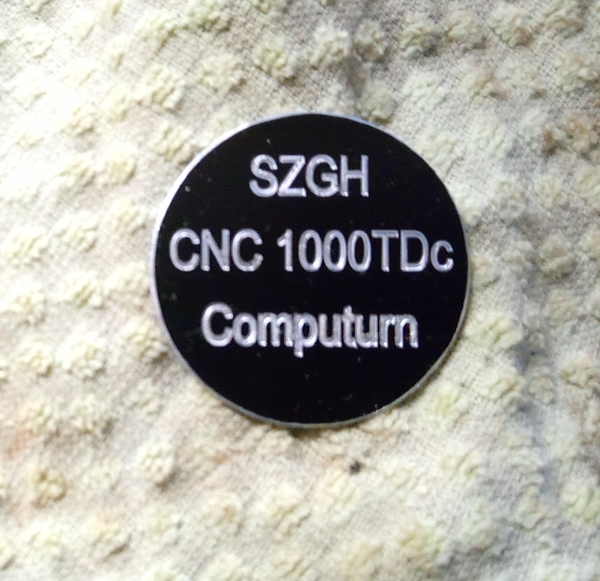

) It is for the pendant I am making for my CNC Lathe.Just done the disc for the centre of the MPG, better go and get on with some real work now
It was a v cutter, the nine9 one I use for some stuff. Just did the one pass so that is a good tip for futureAre you doing that with an end mill, or a v cutter?
Standard practice with engraving is to make two identical passes. You would think it would make no difference, and i wont argue the logic, but it works. Its said that the first pass does the cutting, and the second does the cleaning.
Again, identical passes, no change in anything.

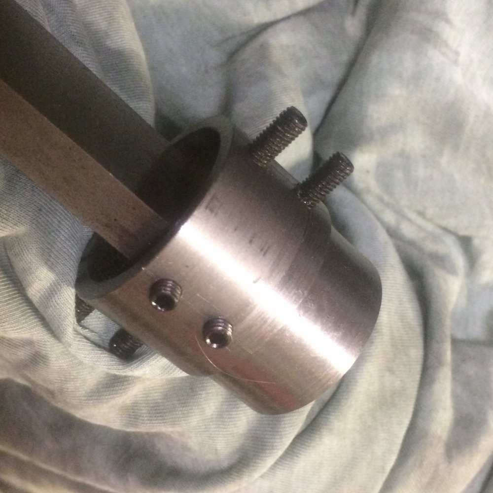

That looks useful. I had to google it though, never seen one before!Made a small cat's head, a bit too thin walled but it is about as large as I can fit in the steady for scale the bar it is around is 25 x 10mm
Thanks just use the grub screws to clamp the workIt's a fixture for holding odd-shaped pieces that you would not be able to hold in a conventional chuck.
My plan is to turn between centres using a dog with the cat's head in the steady, anyone would think I don't like animals.It's a fixture for holding odd-shaped pieces that you would not be able to hold in a conventional chuck.
Yes, all being well I'll post pictures tomorrow.Thanks just use the grub screws to clamp the work
Need pics deffoMy plan is to turn between centres using a dog with the cat's head in the steady, anyone would think I don't like animals.![]()
