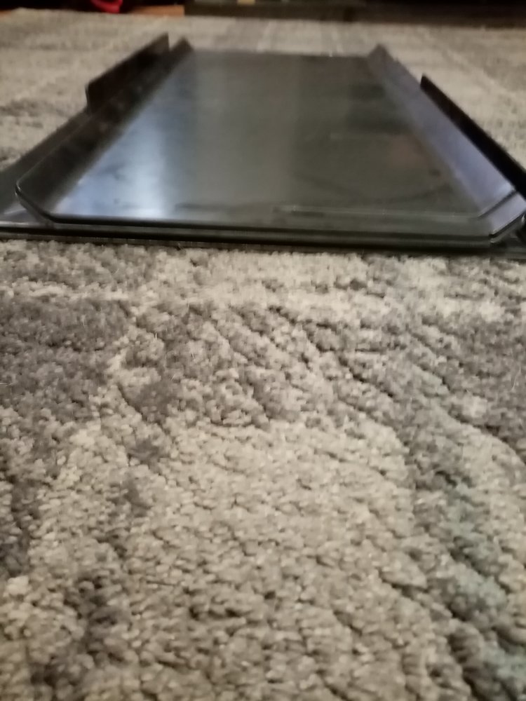

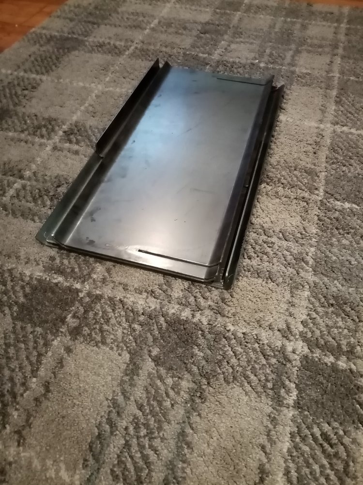

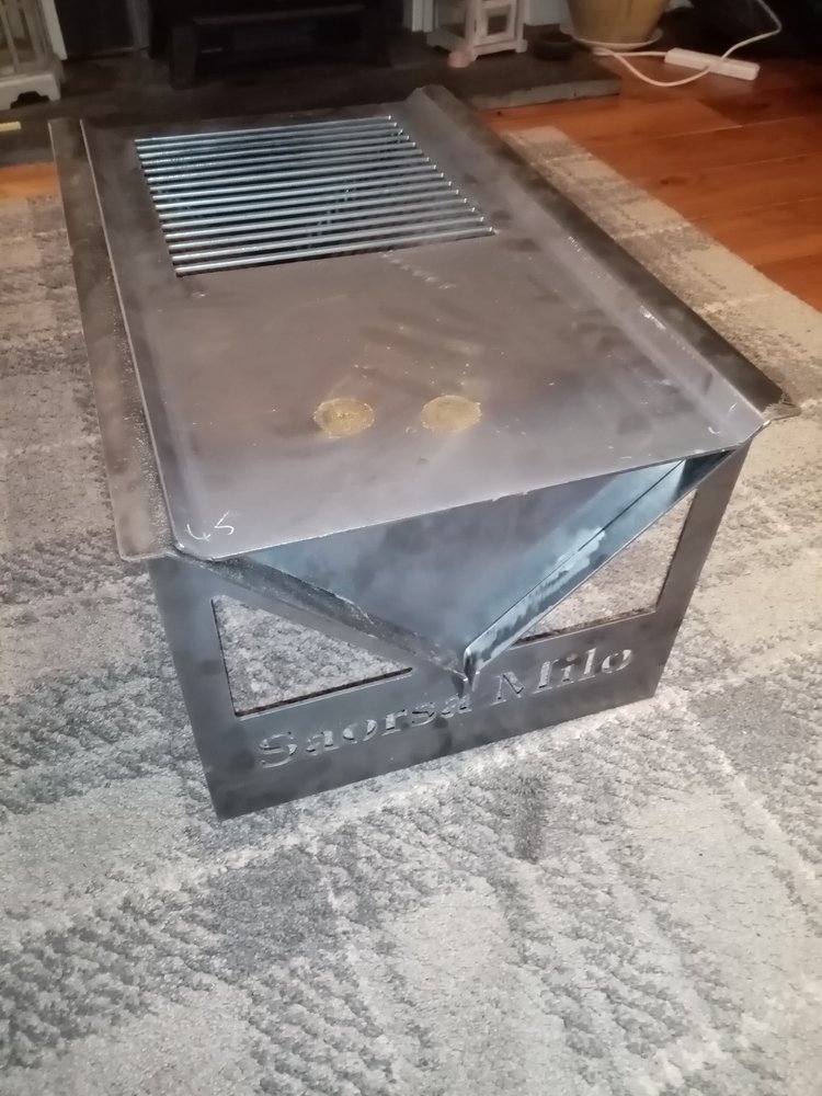

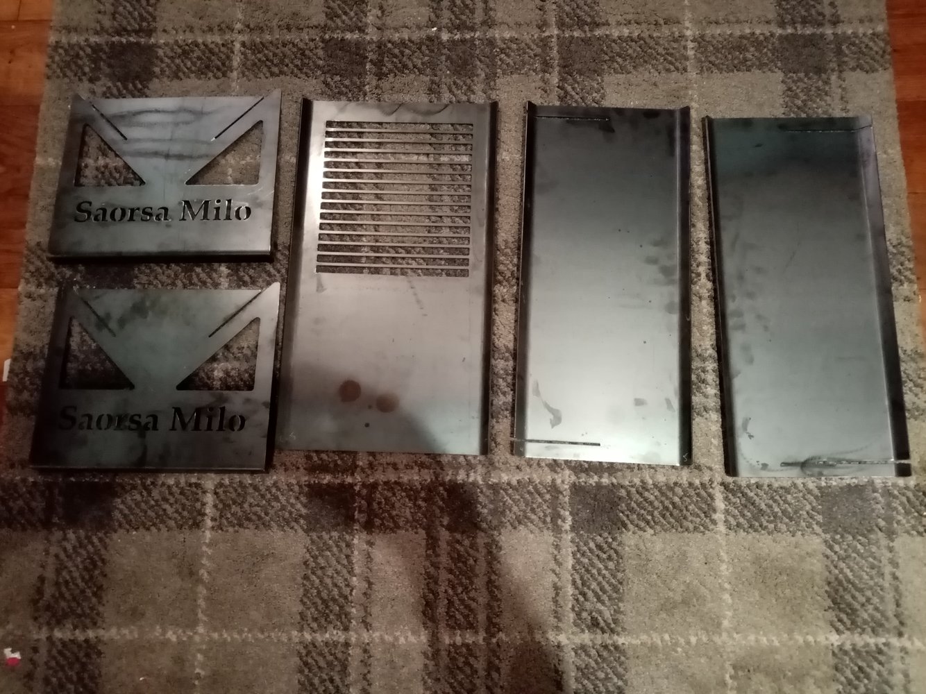

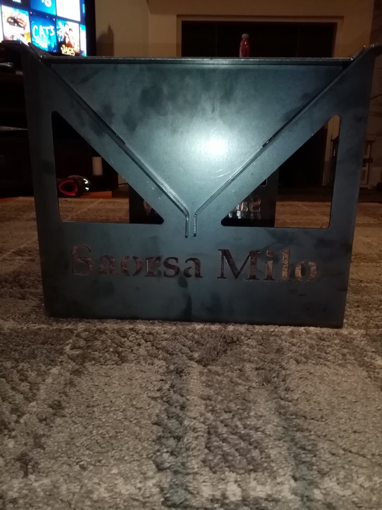

great for camping, like the flat plate too perfect for bacon and egg buttiesCan't remember if I posted this when I made it, flat pack bbq/firepit.
View attachment 279991View attachment 279992View attachment 279993View attachment 279994View attachment 279995
