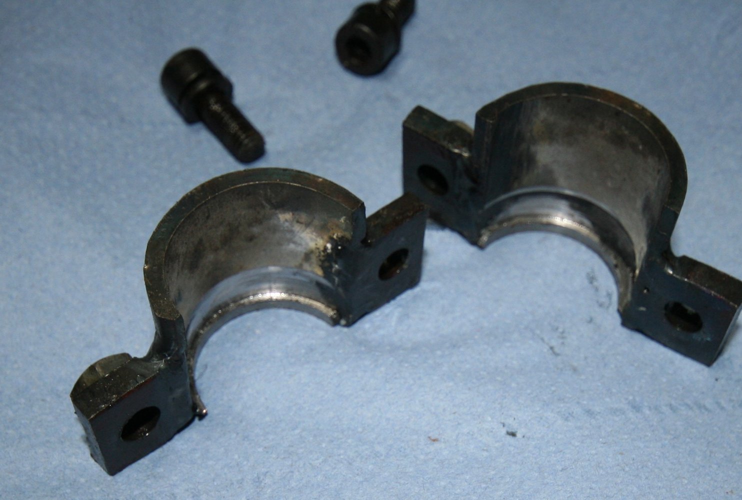

It’s a 4 bolt compound slide clamp for the 920 mini lathe. The standard 2 bolt affair is said to rock somewhat, although I can’t say that I’ve ever noticed it on mine. Anyhow, it’s supposed to be a very worthwhile modification, so I thought I’d give it a go.
I screwed up a little at the end, as I didn’t notice that the bandsaw bow was off square slightly, so after it was squared up in the mill, the graduated swivel is a little more exposed that originally expected, but it won’t affect the way if functions at all.
This is the 2 bolt original clamp:
And this is the new one:
View attachment 280033View attachment 280034View attachment 280035View attachment 280036
It's made from a bit of plain 15mm mild steel, so I was quite pleased with the finish I got. It was the first time I'd 'properly' used the mill so it was all a bit of trial and error and guesswork with regards to feed speed and tool speed, and I also discovered that a higher spindle speed on the lathe gave a better surface finish, so all in all I learnt quite a bit on this job! Happy days!
Next up I need to make a couple of new T bolts for it, as I'm just using ground down M6 screws at the moment, and I think they need a little more surface area to prevent the heads digging in to the T slots.
Also judging by the photos it looks to be sitting a little ****** on the cross slide, so I'm hoping that it will square up when I get it screwed down properly.
That looks like a very interesting site - I’ll have a good look later on.Did this very same mod to my lathe. I also made a solid post to replace the compound slide. I only put the compound slide on when needed now. Which isn't very often. Both mods were from journeyman's workshop website. I also did the mod to disengage the banjo that carries the change wheels, so they only run when needed, this is a great modification.
The bolts were converted into Grub screws, loctited into place and preened over the make sure they don't come loose.

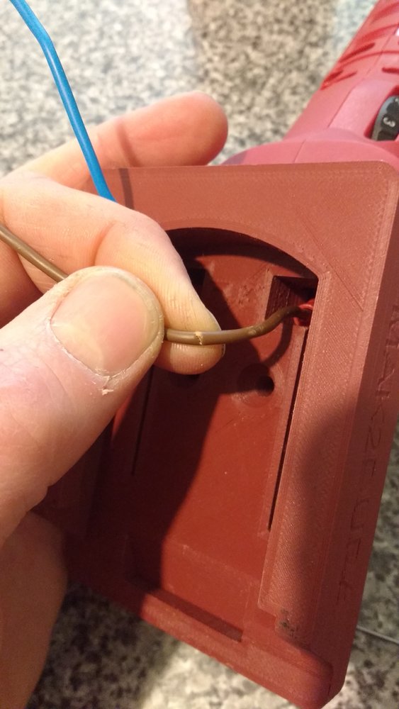

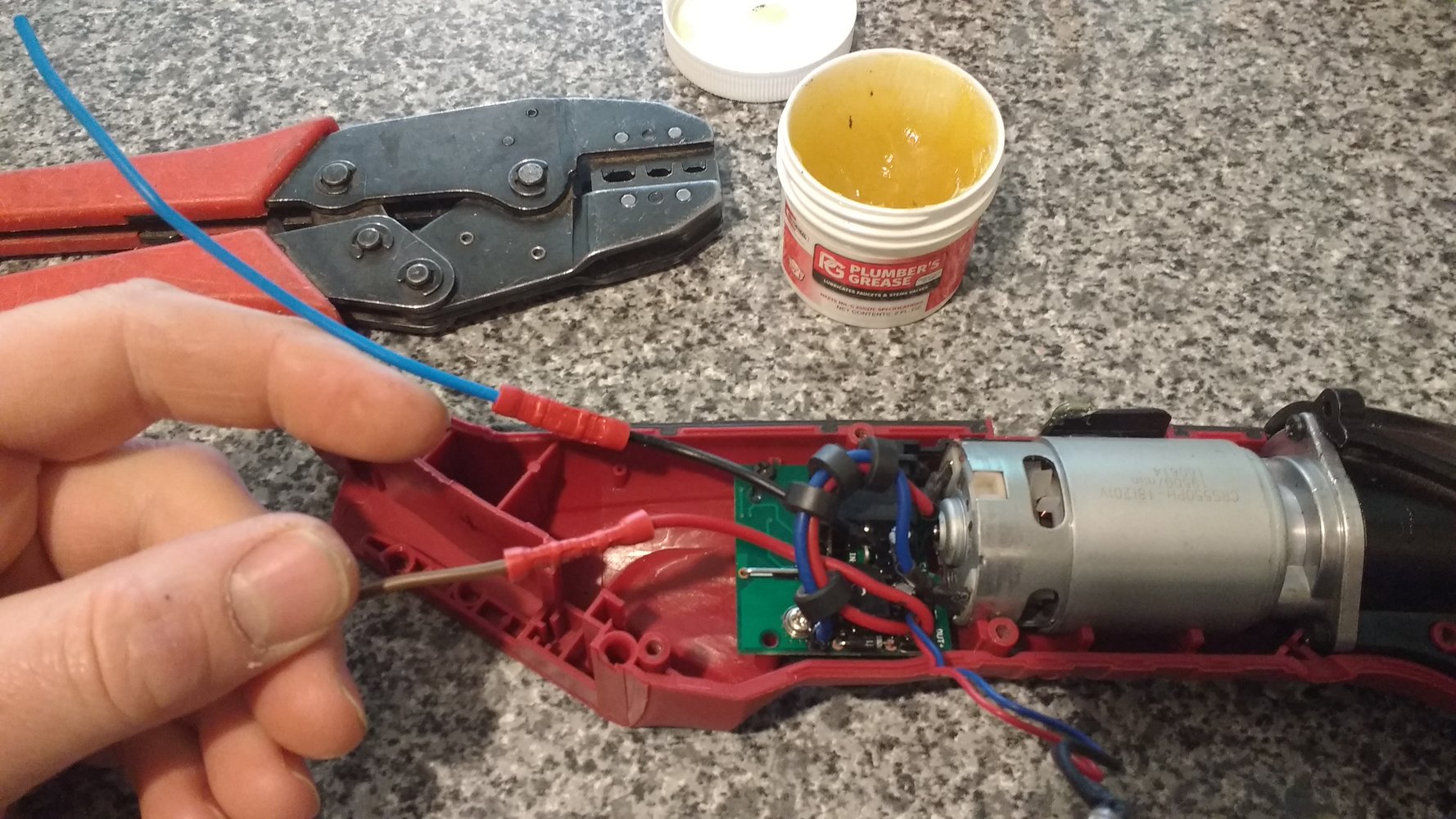

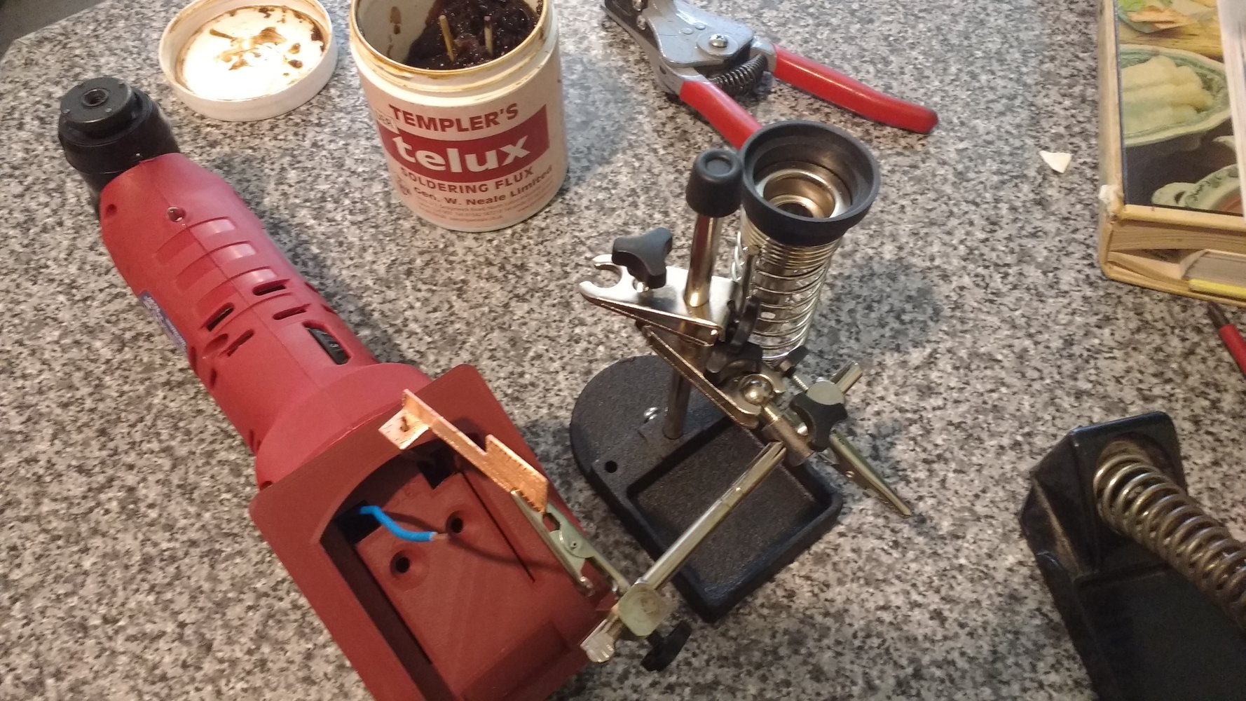

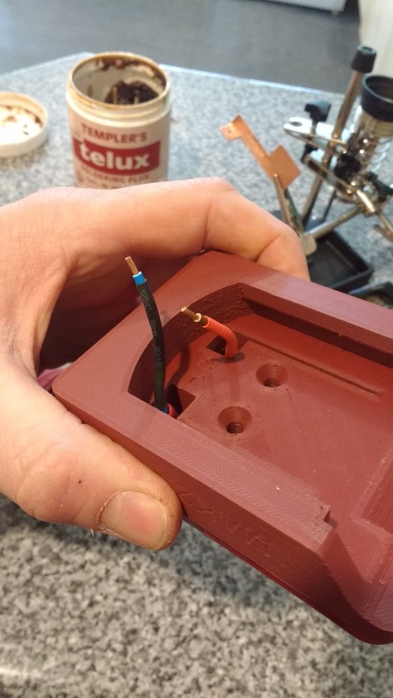

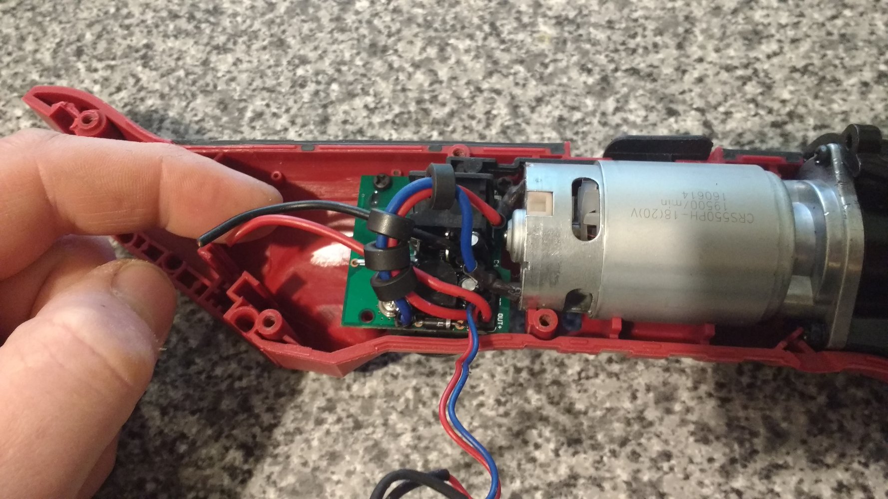

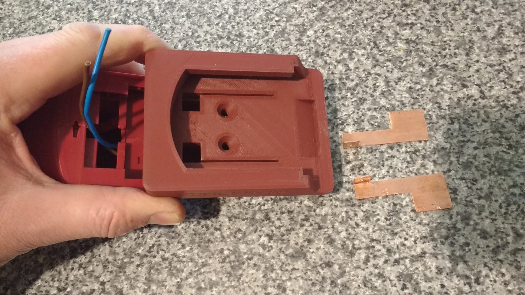

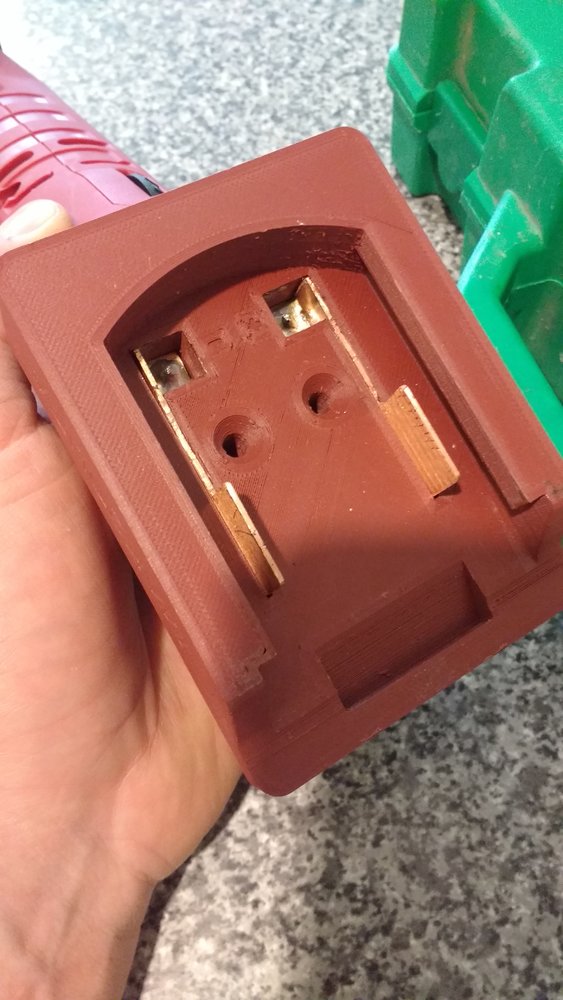

the bigger ah square base battery wouldn't suffer as muchView attachment 280077
This little saw is excellent. The tiny battery struggles with sag but with a cut from each side 38mm boards are no problem. It will be sanded smooth and be a garden table.
I used to work for a guy who called them ‘micro solutions’I prefer to think of it as an ad-hoc engineered solution.

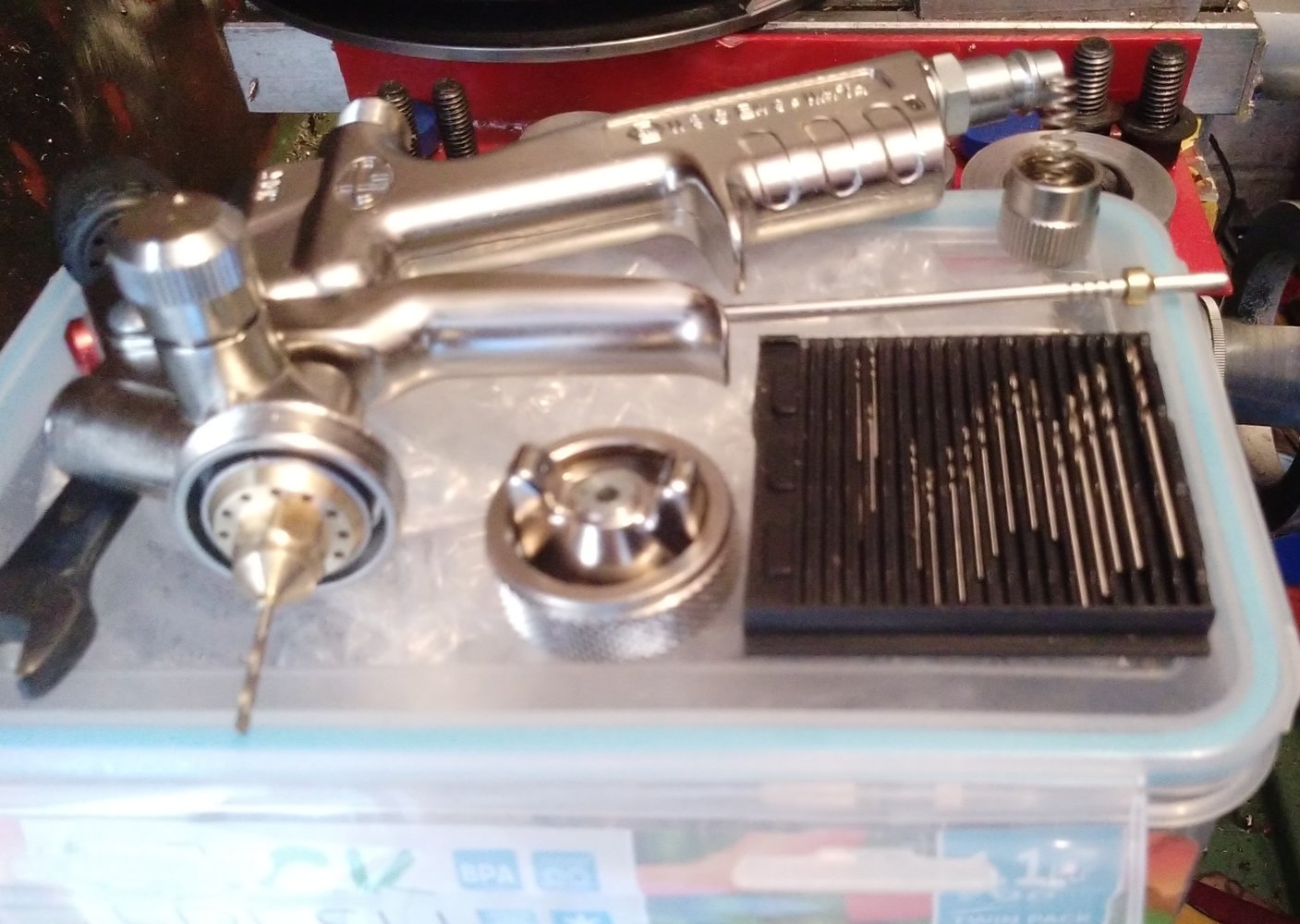

in the sensor not the hoseThe bore is already only about 3mm at the torch.
Yes that wouldnt sag much if at all, but I have a nice 12v 5Ah rc lipo I will eventually use as soon as I make the adaptor, but as it works well enough going slow I havent found the need to do it yet.the bigger ah square base battery wouldn't suffer as much

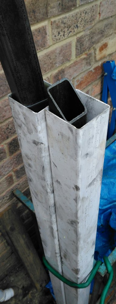

Derusting some tubes. Spent much of the day waiting for the water to heat up on my little hob/pan. I might get a new kettle for kitchen and keep the old for citric. Quite pleased that neither tube leaks.
