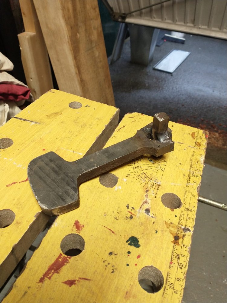

Dough mixerSheared at the bearing? That took some force! Whats it for?
Or simply an uneven, oscillating load over time . . . fatigue just as good as exceeding maximum load.Sheared at the bearing? That took some force! Whats it for?
That’s what it was.Or simply an uneven, oscillating load over time . . . fatigue just as good as exceeding maximum load.
Misalignment too - due to crap design and trying to mount three bearings on a shaft in close proximity, one of our machines bust a 5" shaft in a similar fashion.That’s what it was.
This should only have two bearings this shaft as far as I knowMisalignment too - due to crap design and trying to mount three bearings on a shaft in close proximity, one of our machines bust a 5" shaft in a similar fashion.

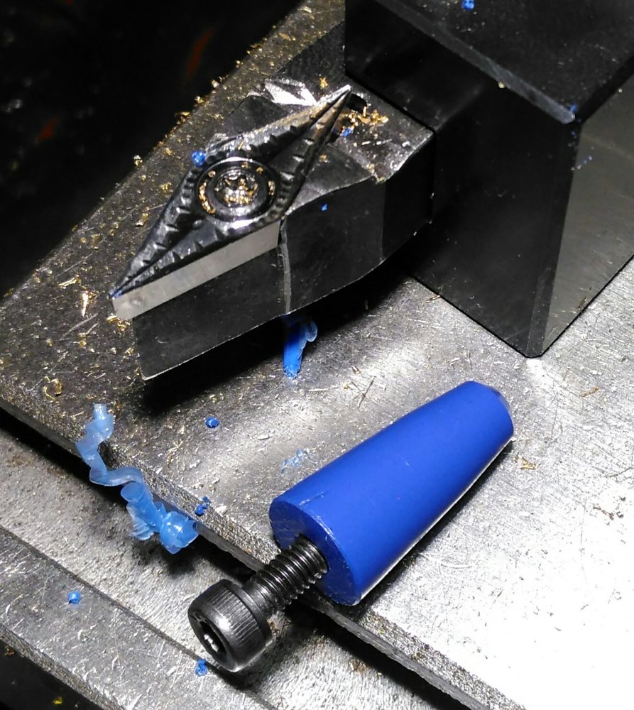

Can you explain or point me to a tube clip please?Flood.
Flood coolant, don't think I have a youtube of the Triumph using Nylon but this is the CNC when I first fitted the SZGH controller to it.Can you explain or point me to a tube clip please?

Ah ... That's cheating using a posh machine and cutting fluids .. I have the antique Sphere cira 1943 so don't have a wet set up ( not likely to either ) I usually cut everything dry or or use a spot of compressor oil on an artist paint brush or use WD40 through the tube attachment if I need lube. Might try and do that and see if I can get a better finish instead , it never occurred for me to use lubrication ..Flood coolant, don't think I have a youtube of the Triumph using Nylon but this is the CNC when I first fitted the SZGH controller to it.
You need to keep nylon cool and I would think that more important than actual lubrication but...Ah ... That's cheating using a posh machine and cutting fluids .. I have the antique Sphere cira 1943 so don't have a wet set up ( not likely to either ) I usually cut everything dry or or use a spot of compressor oil on an artist paint brush or use WD40 through the tube attachment if I need lube. Might try and do that and see if I can get a better finish instead , it never occurred for me to use lubrication ..
I think it would likely turn quite nicely don't fancy your chances of keeping any kind of tolerance on it though Unless of course you are going to keep it in the freezer after you have made the partThanks very much . In that case any idea if -23 oC deep frozen nylon can be turned ?
