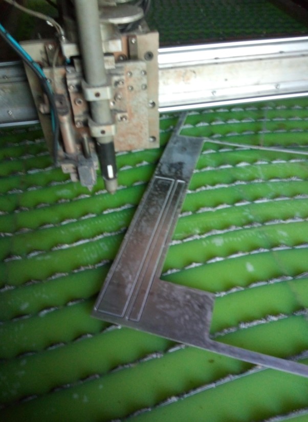

Also wrote a macro for rotating the toolpath on the plasma, never really had a need for it but might come in handy one day. One issue I have found though is the CSMIO controller I use does not work in Jog as Mach with the parallel port would. It still jogs along the conventional X and Y where with the parallel port it would run along the rotated X or Y when jogging, so that is not so good
Still it can still be used fine from G Code as can be seen from the two bits I cut in a plate that was angled about 45 degrees to normal.

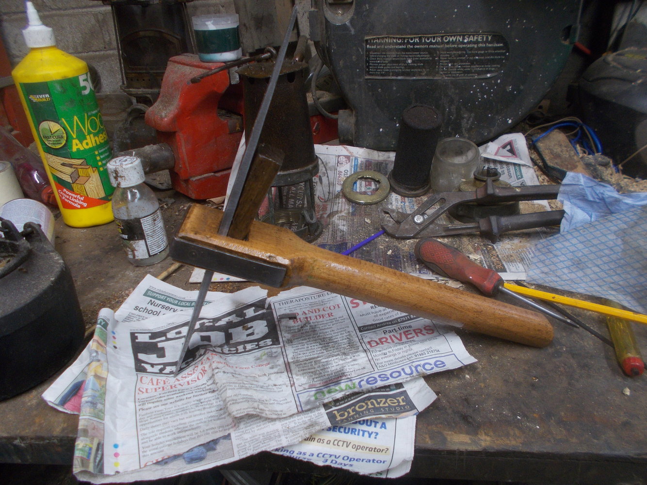

This J Tyzack Millwrights Dressing toll arrived in this condition. Complete, dirty. but with the dirt of age. The tips had been badly dressed over time.
The wedge was swollen with old wax and oil.
The manufactures name was revealed in the cleaning and dressing of the edges.
The cleaning showed a name stamped into 2 places on the wooden handle, the wedge and the blade.
R. L. Hickman.
The metal was cleaned with wire wool, White snake. Then warmed on the stove and wax polished in.
The wood was cleaned up with "Meths" and wire wool. This showed up the grain of the beech. The wood was finished with a custom shaped cabinet scraper.
The wedge, is Oak. It needed to be reduced in width. But removing the excess would show up as new wood.
So, clean with "Meths" and wire wool. But keep the dirty "Meths".
Dress back the wood with files, on both sides. Then key with course sand paper.
By this time the dirty "Meths" should of reduced and left you with a dirty sludge. Add some soft wax to make a paste. Then using a fine wire wool stain the exposed new wood.
Sanding sealer and Polish.
The polish is home made, dissolve shellac with cheep nail varnish remover and apply with a soft cloth.

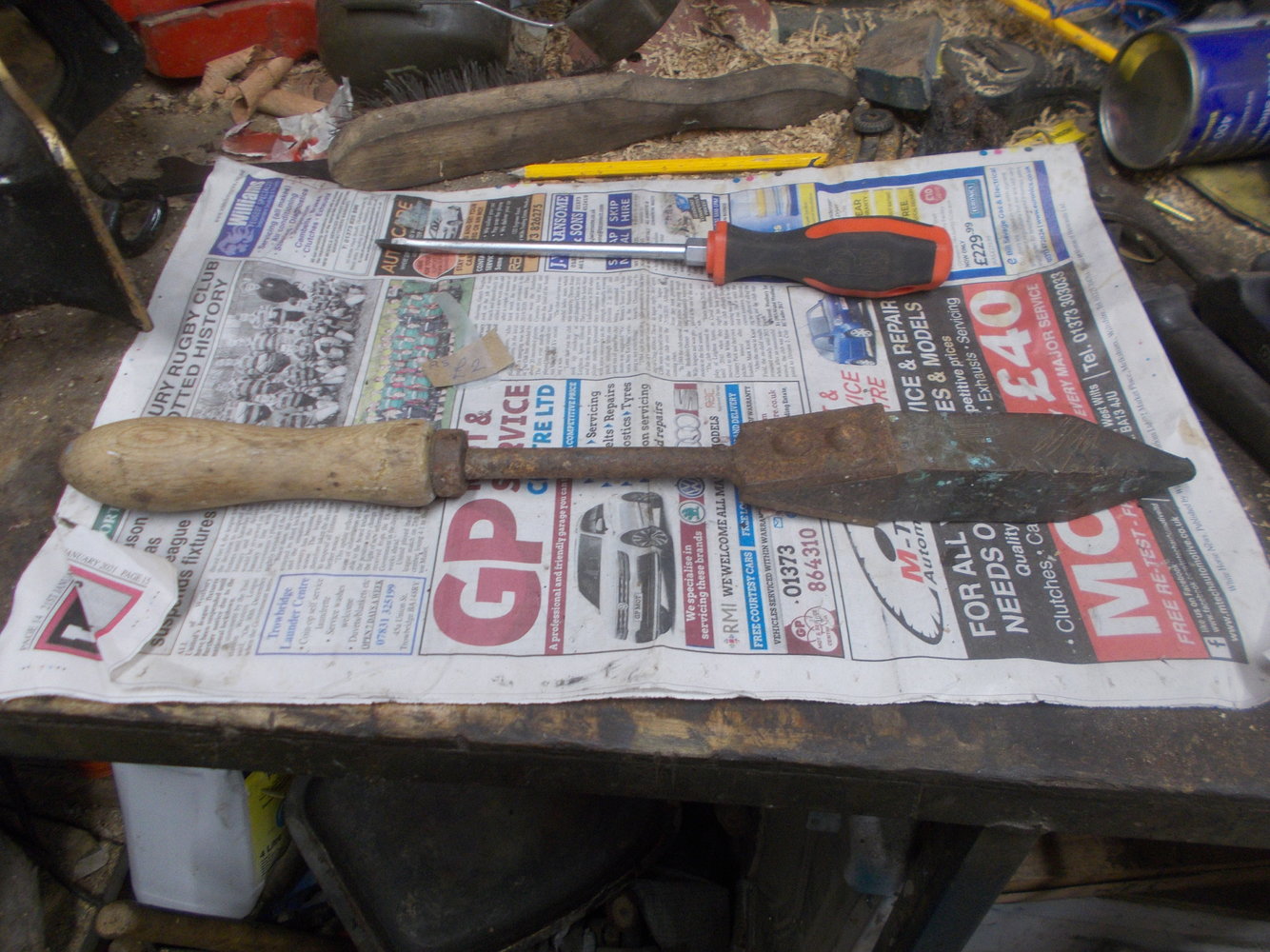

The other item I managed to get some time on was this 2lb Copper soldering iron.
The handle is stuck on with rock sulphur and was not going to come of with out a fight and noise.
The tip had been droped at some point and was burred over. One rivet was loose.

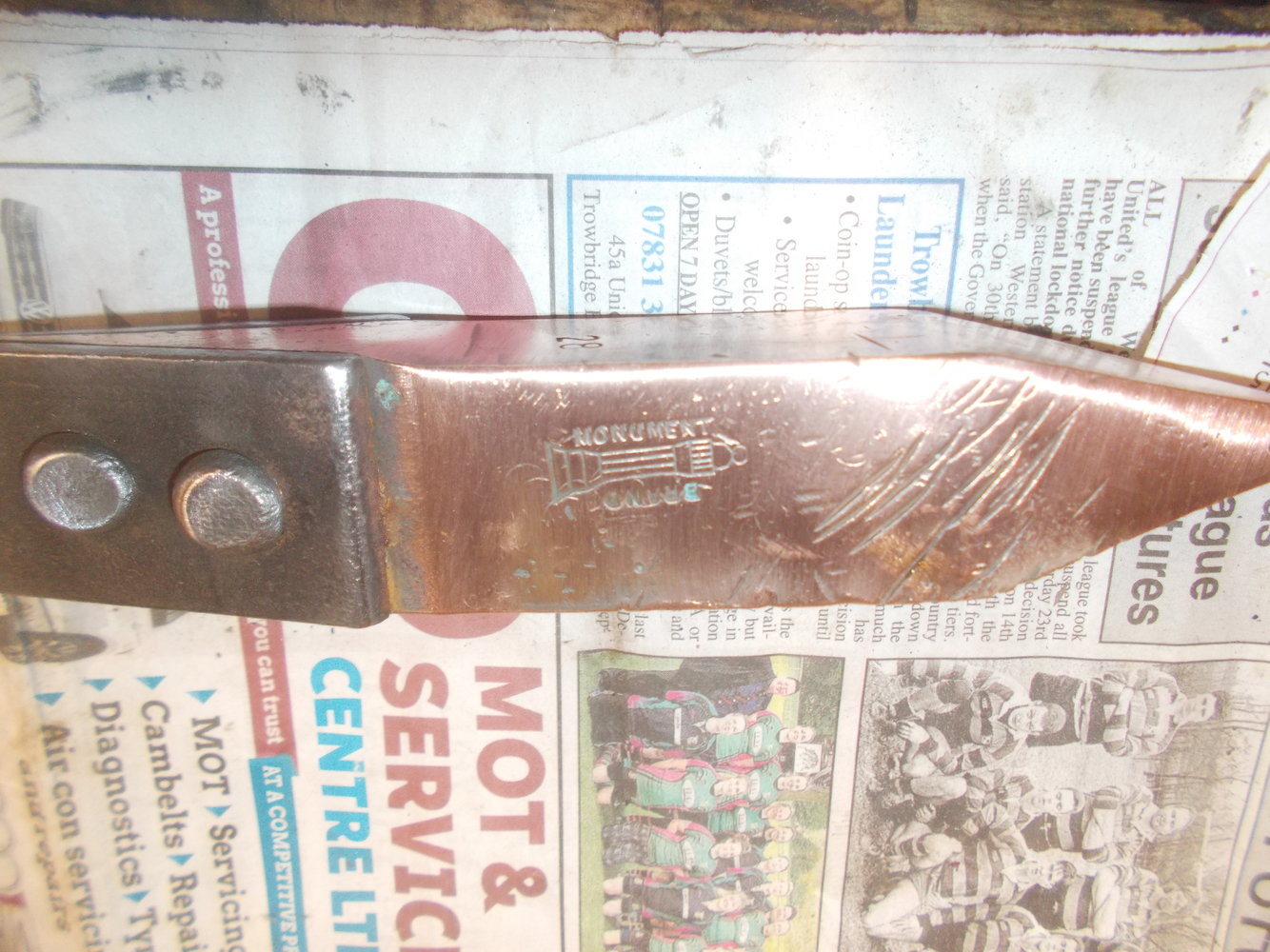

Cleaning up showed a manufactures name.
Monument Brand.
Plus the Number 28 on the other side.

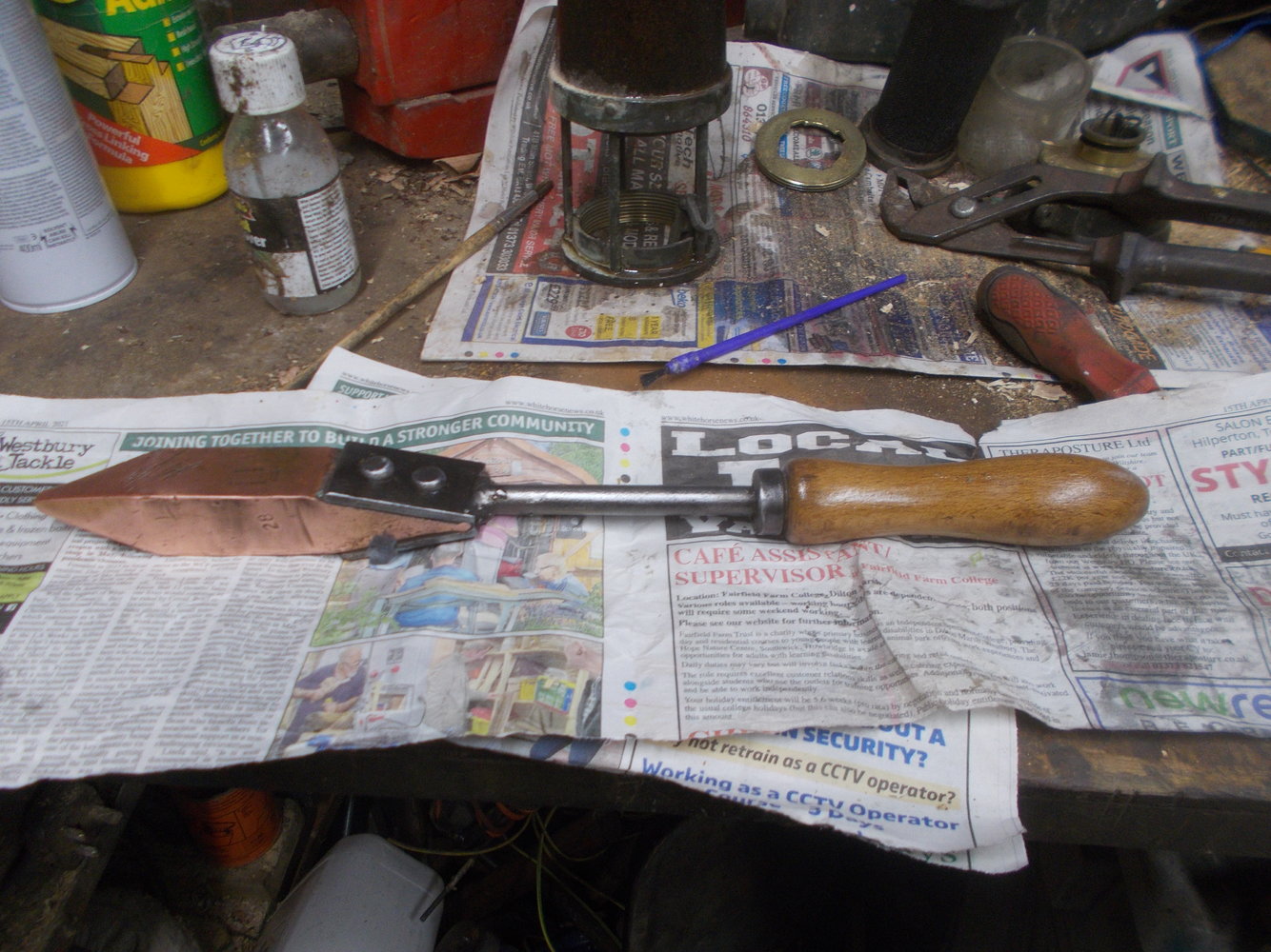

The tip was dressed to give 1 square edge and the other 3 are radius to different amounts.
Cleaned, polished and waxed.
The rivet was made sound by heating and pressing it in a vice.
The handle has been repaired at some point in it's life, you can see the welds on the bar to head.
The on line catalog showed two types of monument brand 28oz heads.From my apprenticeship tin bashing days over 50 yrs ago ..... IIRC 28 on the stamp usually means a 28 ounce head of copper , On that particular Tinmans 28 oz iron all edges on the pointy bit should be clean sharp edges & flat faces so you can easily sweat solder along seams or tin plate patches turning the iron as needed . Do you ever get any of the old Tinman's axe head irons for seam soldering ?
