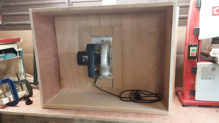

Made serious inroads on my home-made table saw this weekend. After pricing up a new one I came across lots of "how to make a table saw from a circular saw" videos on YouTube and as I had a circular saw sat doing nothing and plenty of 3/4" board, I gave it a go:
Still have to finish the rip fence, make a mitre fence, rout 2 mitre slots in the table, fit an on/off switch and a port for dust extraction, possibly cut 2 holes in the front for storage, then give it all a good sanding and put some wax on the table, but I'm very pleased with it so far.
Spent some time squaring the blade to the front of the table before bolting the saw tight then ripped an old piece of board through it using a clamped on temporary fence squared up by eye, and over 24" the width was 4 thou' out so I'm happy enough with that .

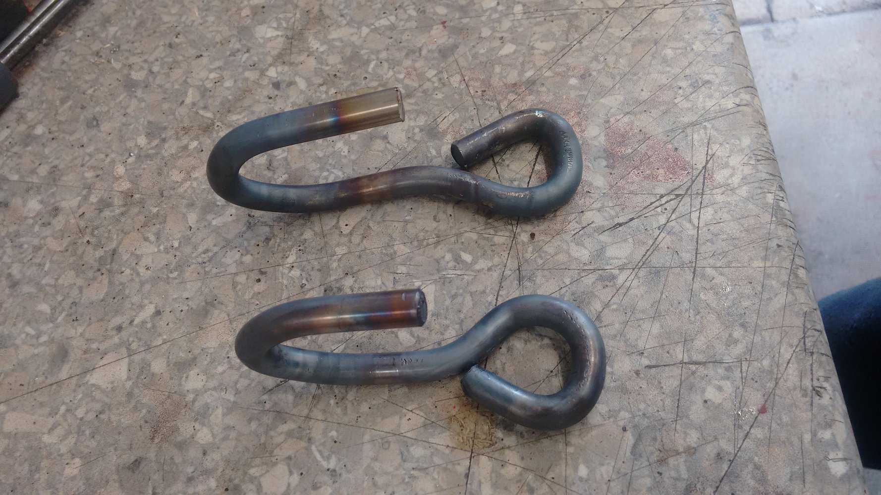

They look really substantial and better than any I have seen for that applicationSome hooks, made from 10mm 316 stainless.

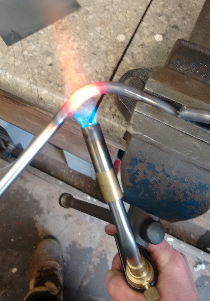

Wasn't getting very far with a propane torch so bought some MAPP gas. Much better!
Even heated up cherry red it needed some serious leaning on.

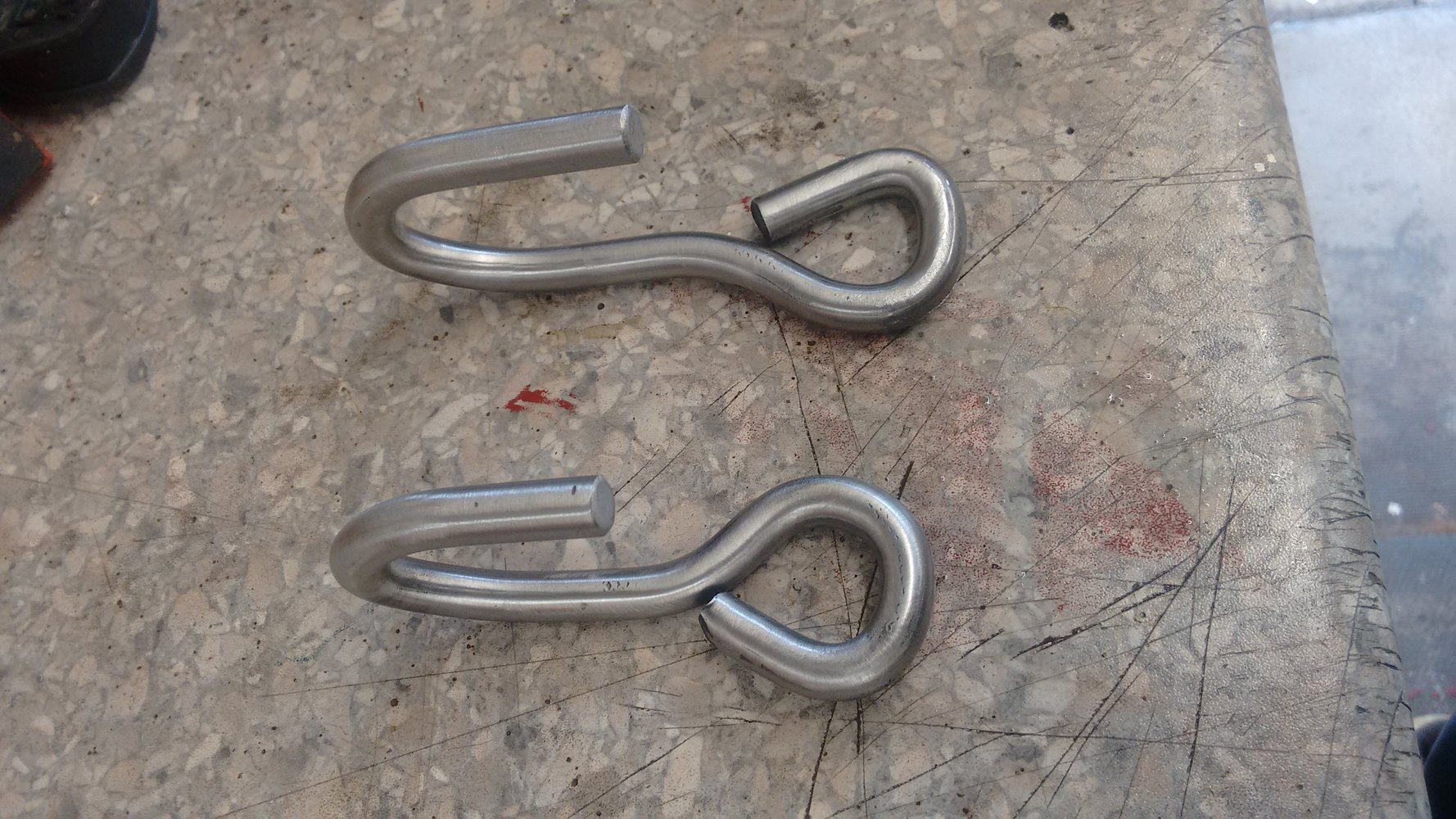

Cleaned up OK.
Test fit. Think they'll do the job. Sod's law, that instantly brought on the rain...

Yes a running joke in our house is that I tend to over-engineer things. But build one thing that collapses with weight on it and I'd never hear the end of itThey look really substantial and better than any I have seen for that application

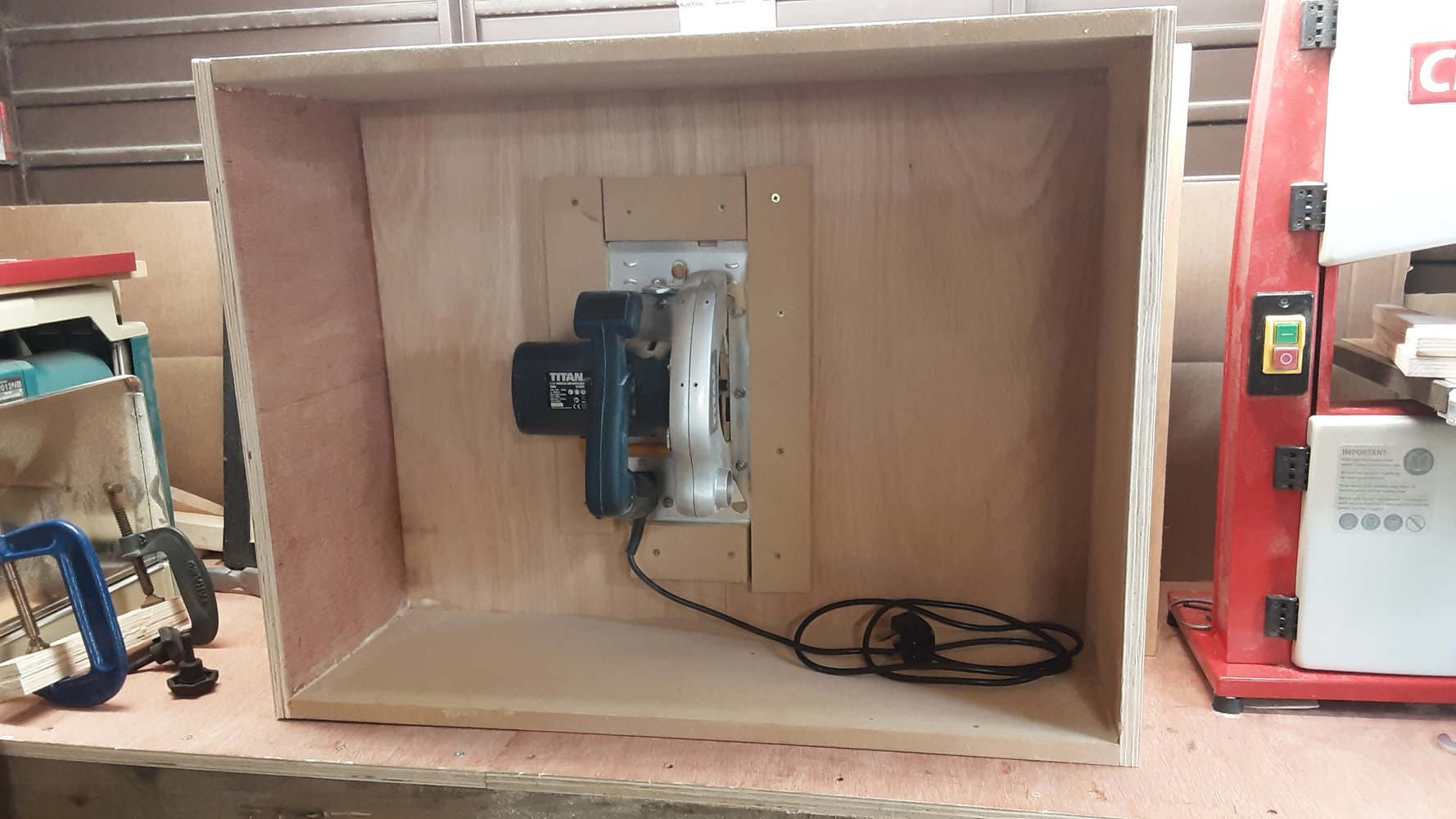

your going to have some fun with that model and yes ive seen it just didnt want that typeMade serious inroads on my home-made table saw this weekend. After pricing up a new one I came across lots of "how to make a table saw from a circular saw" videos on YouTube and as I had a circular saw sat doing nothing and plenty of 3/4" board, I gave it a go:

I saved the riving knife from the circular saw and it won't be too much work to fit it back on if I extend the slot for the blade.Looks nice! Are you going to add some sort of riving knife/splitter?
