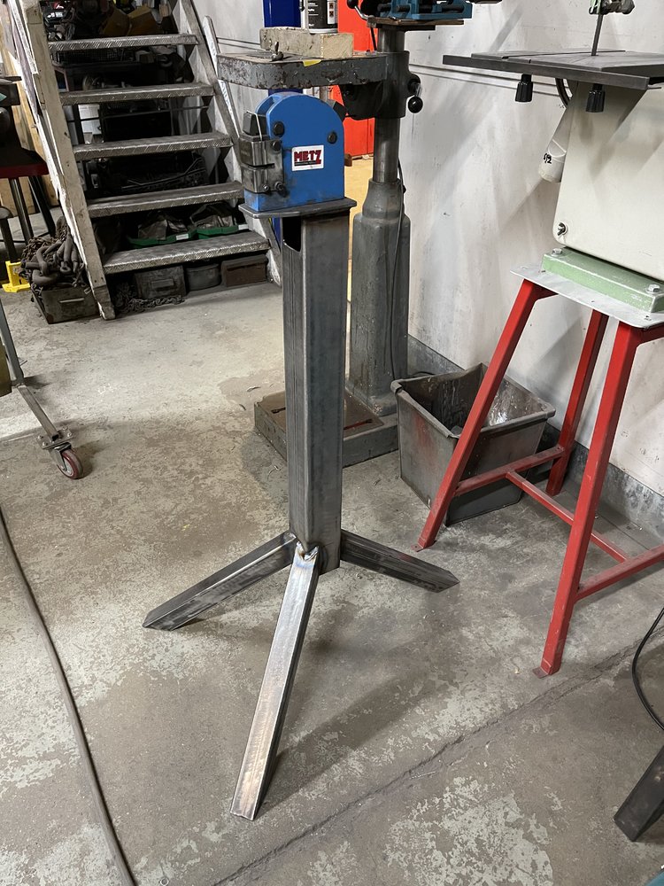

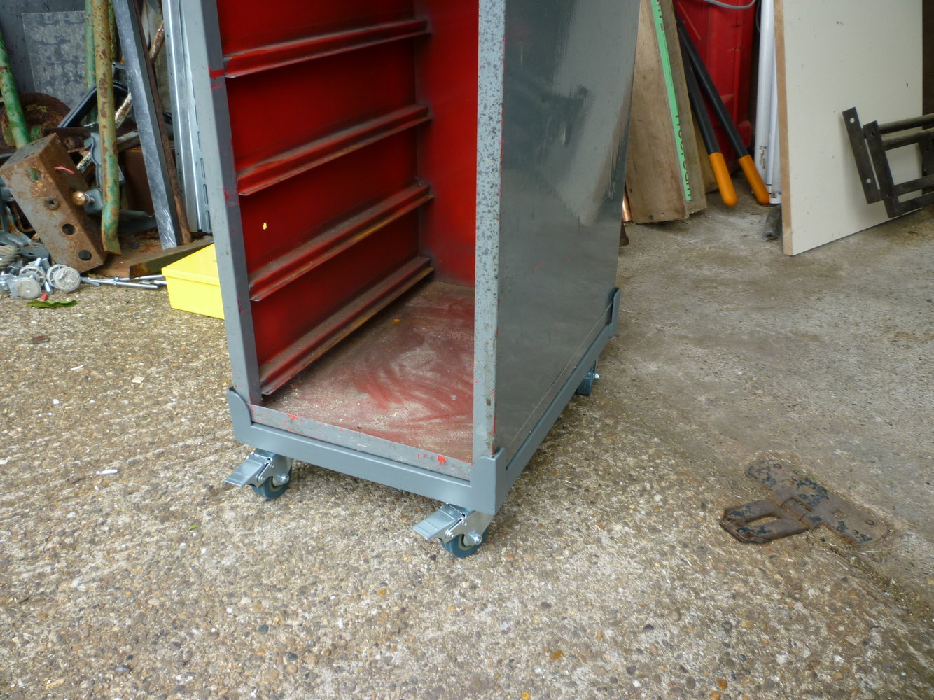

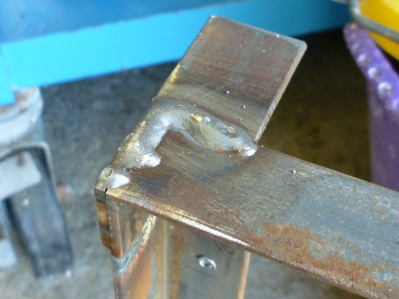

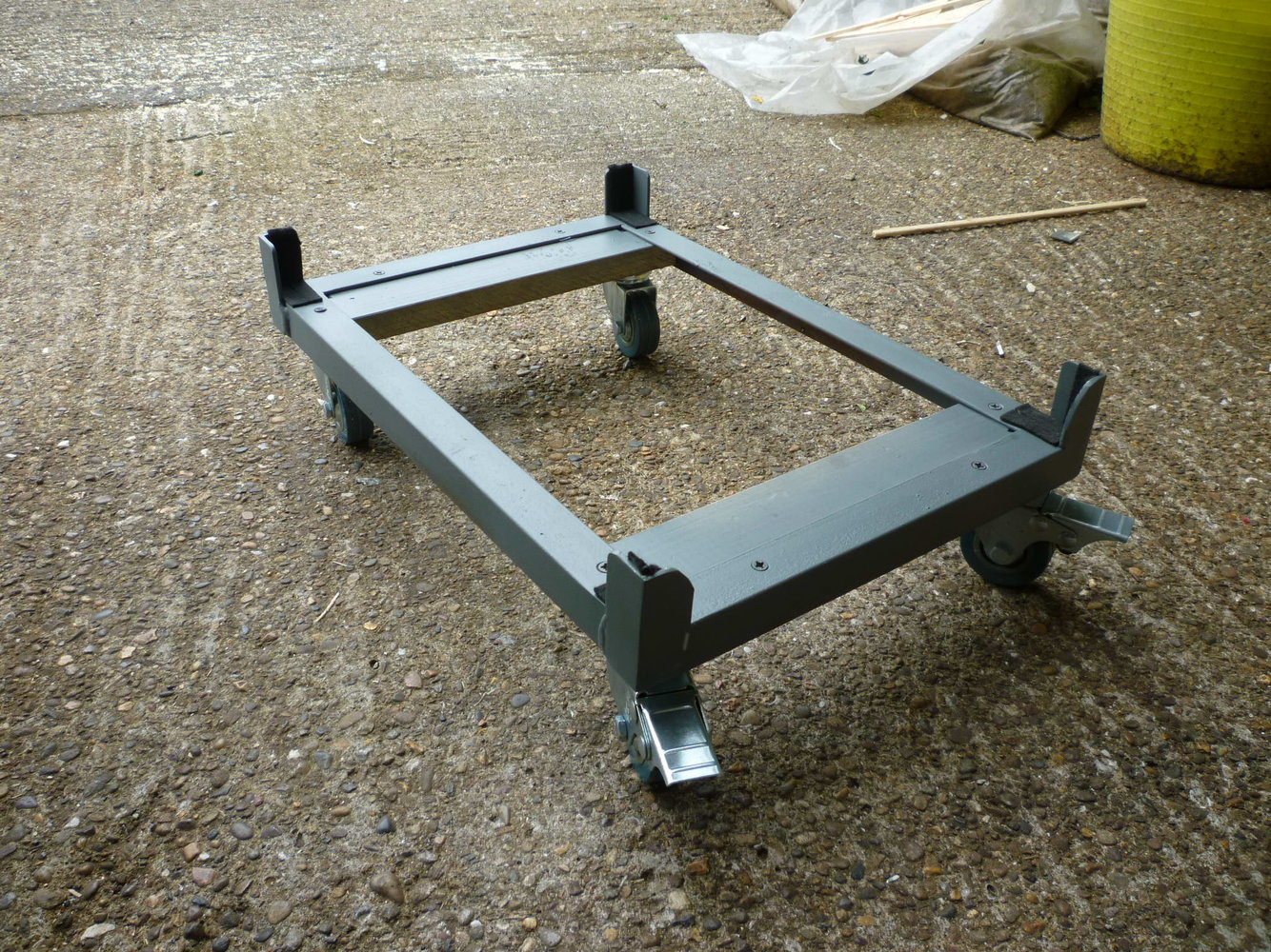

Ahh, fallover feet....I’ve ended up with another shrinker stretcher body so I started on a new treadle stand for it this afternoon.

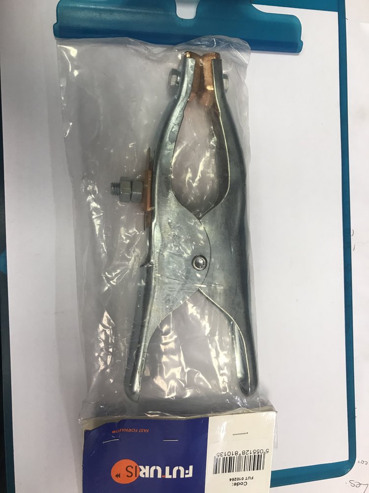

I really need a new high quality earth clamp. My Lincoln 200A one has burnt the braid out, the brass pads are in good Nick but I’m getting arcing. @Jim Davey do you sell any heavy duty spring clamps suitable for 200A?
actually I should probably tag @andymdavey82 too
I keep looking at the tweco ones but ESAB products have gone to crap
