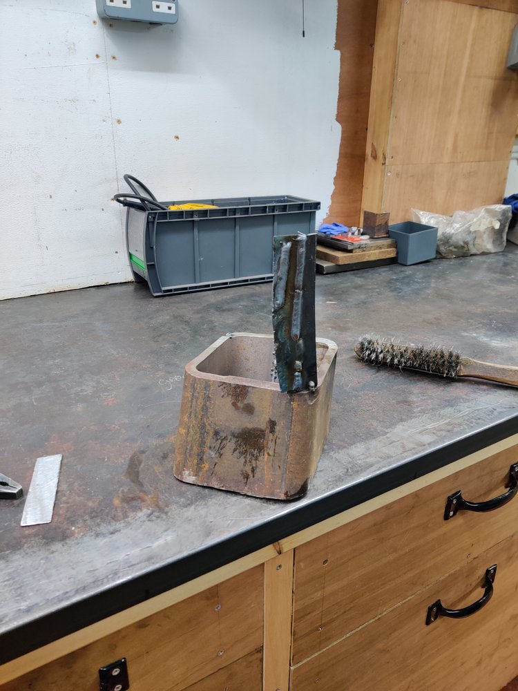

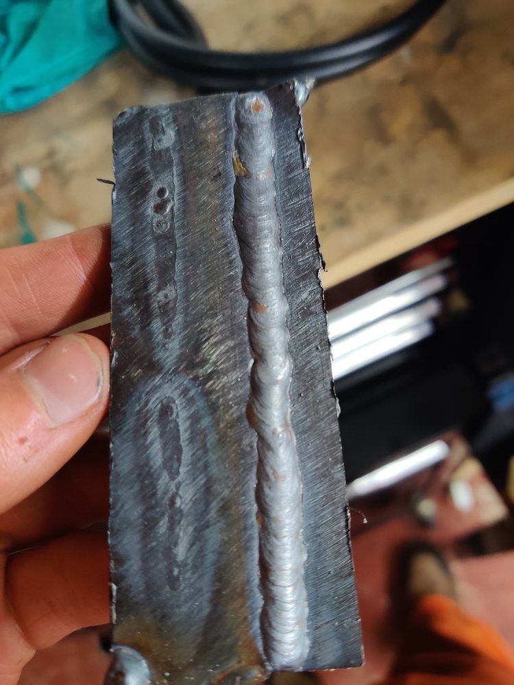

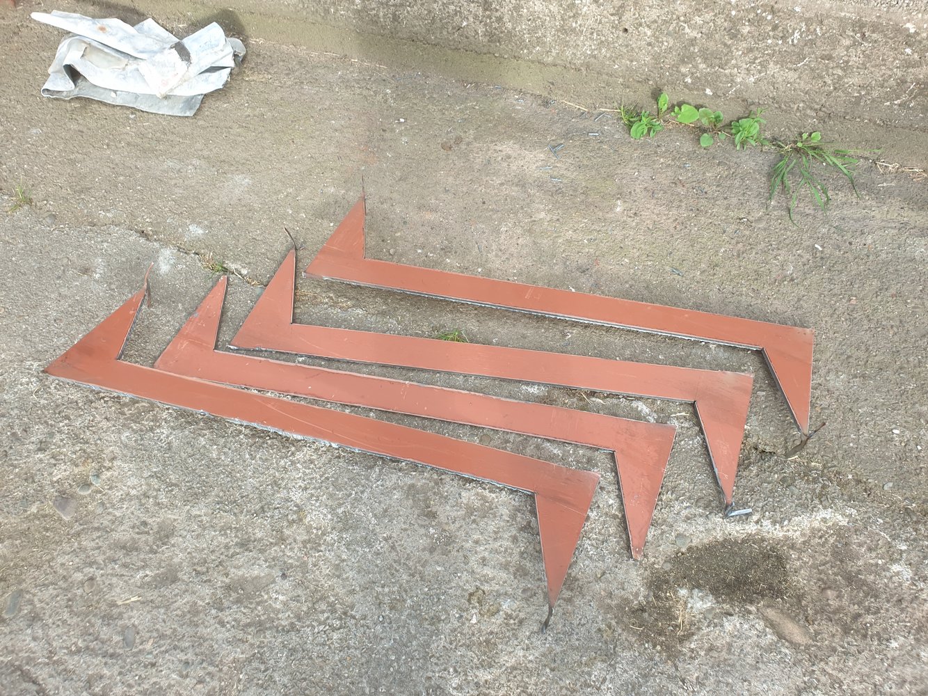

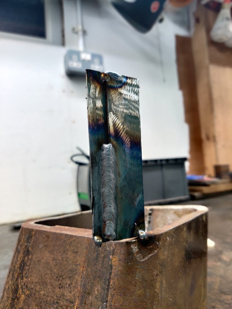

Thank you for describing your techniquePractising some downhill mig for a door I'll be welding later , 1.5mm plate lap weld at about 15V , 3.7m/m
Quite happy with the downhill results and seem to get good penetration coming through back of plate.
Went for a repeating U pattern downwards and seems to have okay results.
View attachment 297394View attachment 297395View attachment 297393
You fair like your orange paint
It's the only colour I use...You fair like your orange paint![]()
