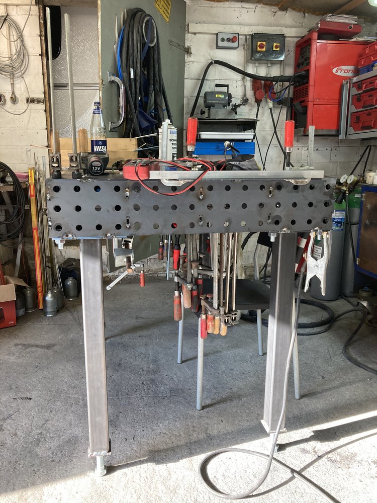

Nice welding there Brad - You'll have to give me a lesson one day!

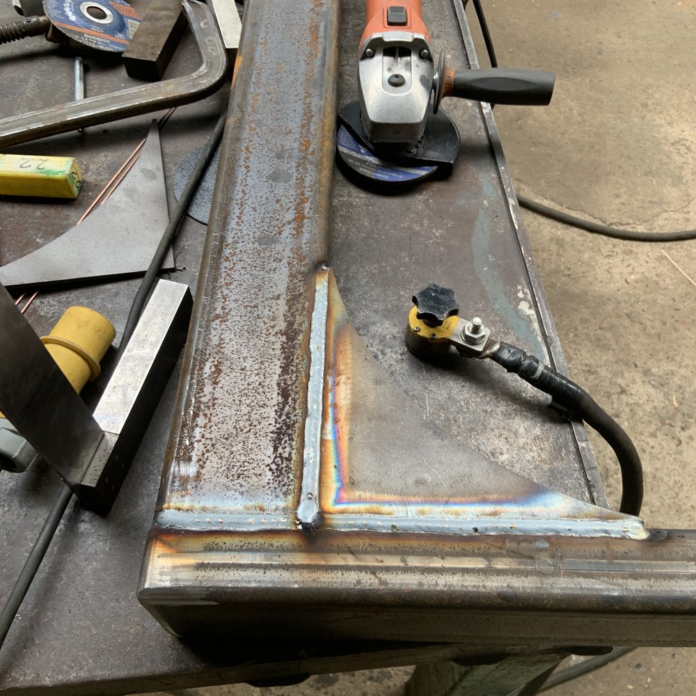

What's the mag return clamp like i have the same one here never wired it up.
CrapWhat's the mag return clamp like i have the same one here never wired it up.
I knew there was a reason I never wired it up!Crap
I never seem to get them to work with the stuff I doWhat's the mag return clamp like i have the same one here never wired it up.
well it will stay stuck to the filing cabinet where it has been for the past 3 well maybe 4 or more years!I never seem to get them to work with the stuff I do
Might have something to do with the "stuff I do"well it will stay stuck to the filing cabinet where it has been for the past 3 well maybe 4 or more years!
wasnt cheap either!
yeh ali aye! it dosnie stick i know what u was getting at! fisshie reeling ya in!Might have something to do with the "stuff I do"
They're alright they just get red hot, this little 200A one isnt actually that strong now, it spends most of the time on the floor and its always sparking and crap. Have used the big 600A one and they're worth having but theyre £100s

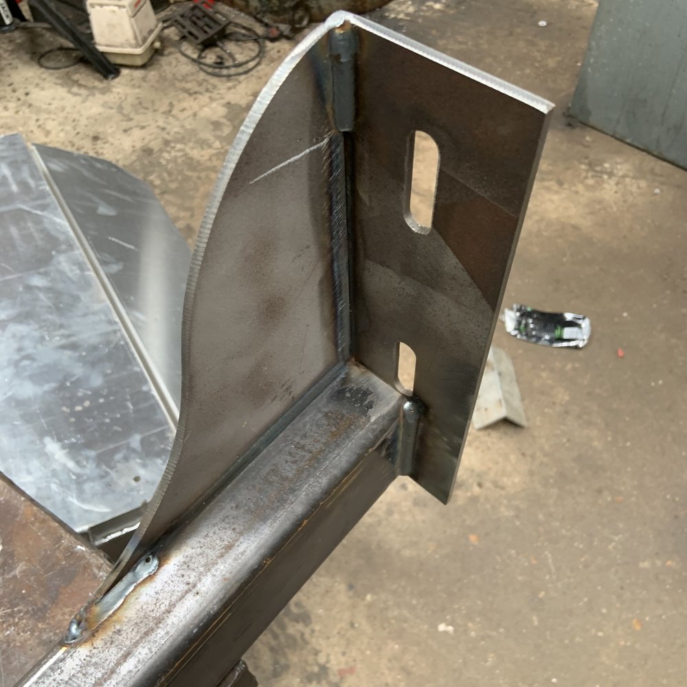

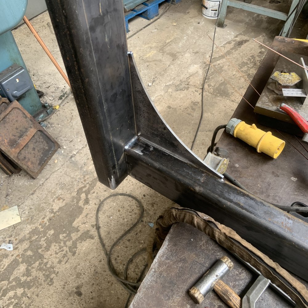

Now that's where gussets should go - onto the strongest part of the hollow section!
Something similar to thisDepends what you think I'm doing. This one won't be galvanised as its an experiment, if it works like I hope the next one will be.
I have one, I think a 500amp rated one and use it for the playground equipment builds. It's OK does get hot though when the Esetti 350 is cranked flat out (380amps). The insulation has melted back about 20mm from the attachment bolt, this will need redoing in the not to distant future. However overall it's ok. One thing to watch is that the steel is clean and not rusty.What's the mag return clamp like i have the same one here never wired it up.
Aye, no point putting them in the middle, try and fully weld them in the middle of the box and it will just distort all over the place. This is well overkill for what it is but the customer is looking for a rustic/early 1900's look.Now that's where gussets should go - onto the strongest part of the hollow section!
