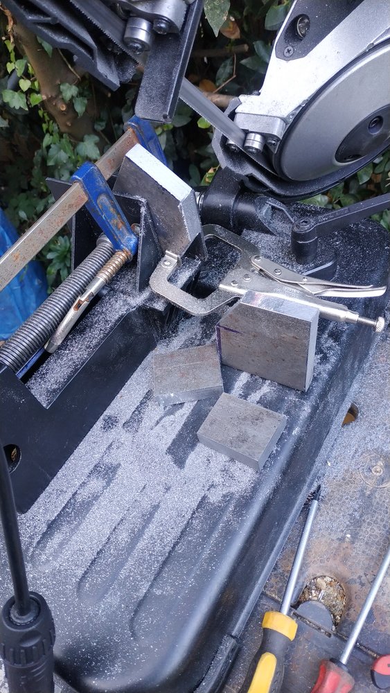

If it's blunt it's blunt, however they like a bit of pressure and if the are not making swarf they are just spinning and overheating.Lots more decorating, almost done, but only have a few days as carpet is being fitted.
Bandsaw some plate
Tried the big slugger, no chance. Too many flutes or blunt? Just got lots of chatter, belt slipping and a million tiny splinters!
The baby 26mm went through nicely.

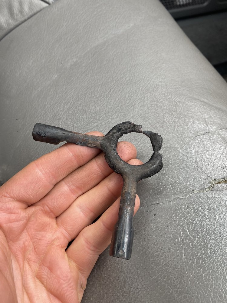

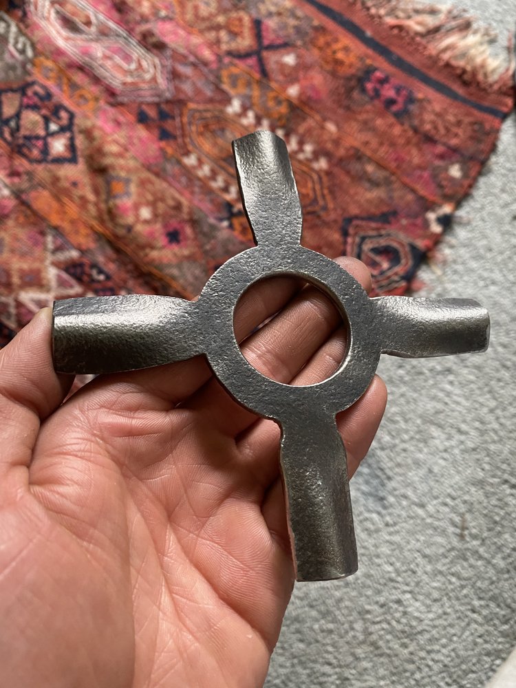

glad it wasnt a sykes picavant one would have choked on me beer if it had beenModified this tiny cheap bearing puller with an angle grinder in order to remove the bearings and shafts from the Favretto balancer. Even had to make a little extension piece for the screw. 8mm shafts and 24mm housings.

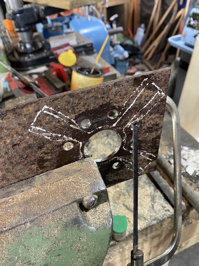

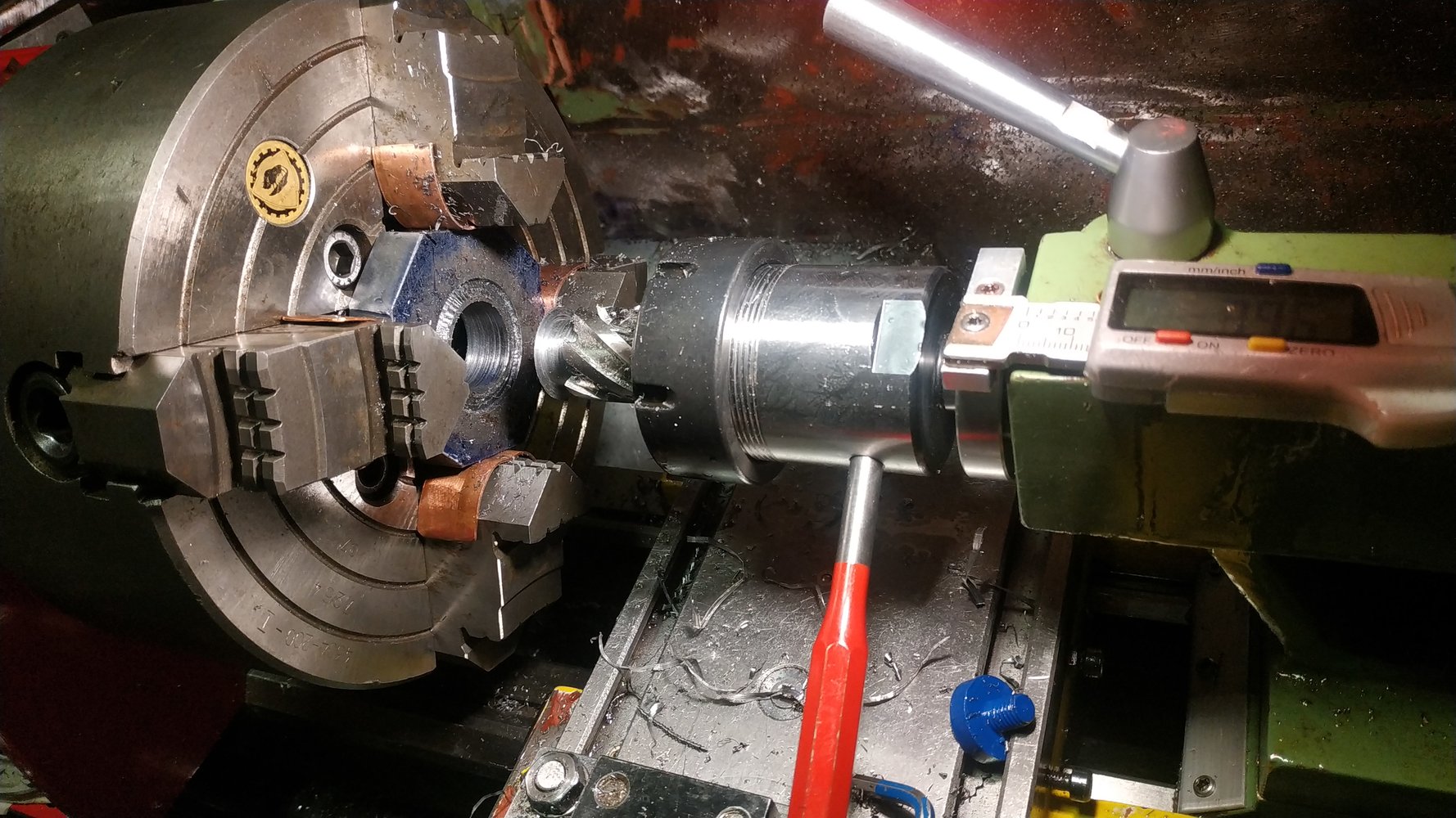

Bandsaw some plate

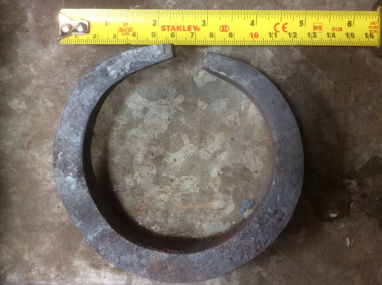

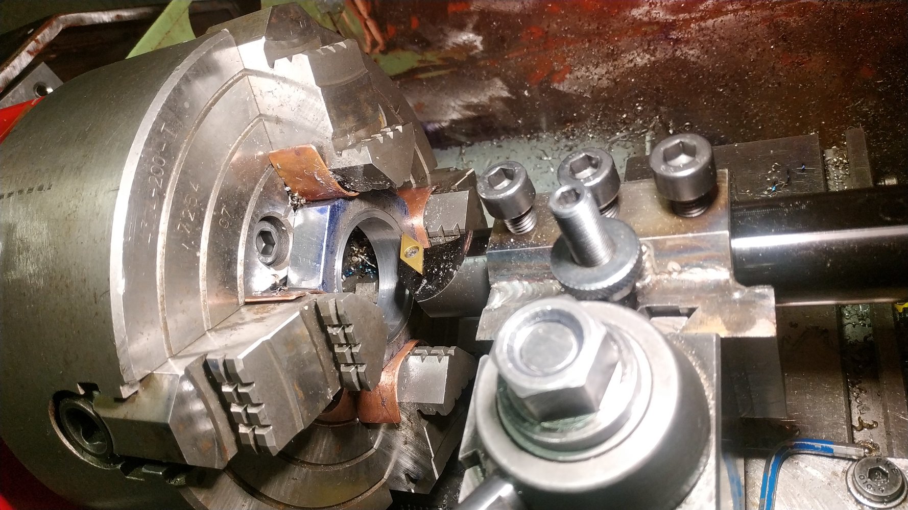

First one roughed out.

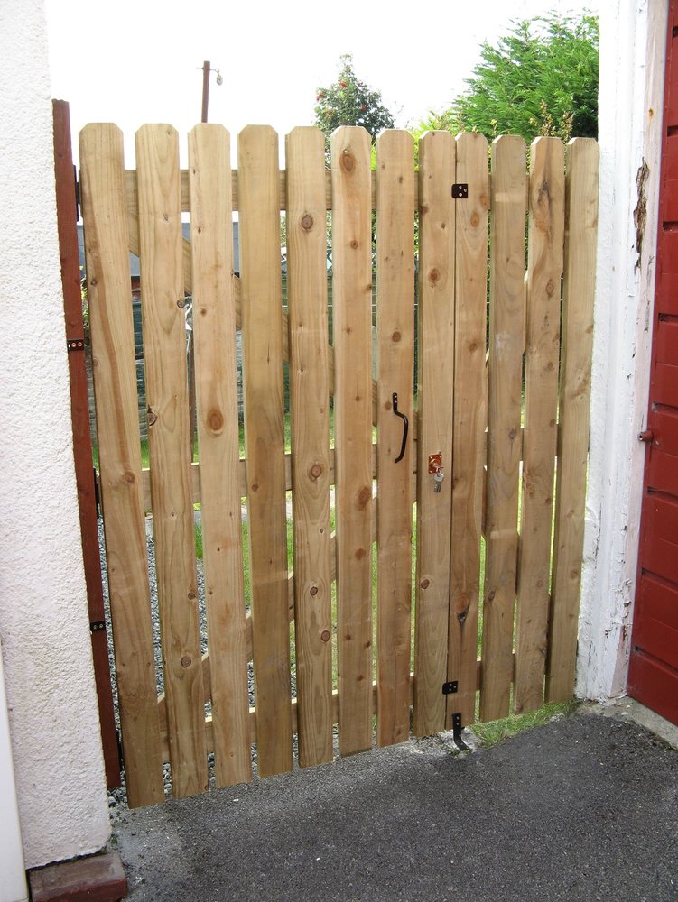

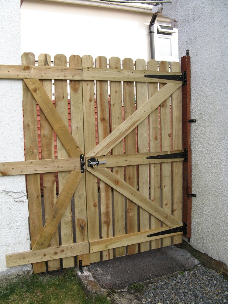

I'd be giving it a touch more clearance between gate and panel - a few days of rain and both expand towards each other . .I don't have a particularly good relationship with woodworking but, on this occasion I've made something I can be proud of - a gate for my neighbour's back garden. She works most days and there have been one or two suspicious characters wandering round the back recently. Just a bit of sealing here and a couple of covers to protect the rolling bolt from the worst of the elements to do. Bought in some 4" x 3/4" timber and added a length of 3" x 2" for a post plus the hinges which have been knocking around in my workshop for ages. Kept me well occupied for a while which is why I haven't been online of late.
