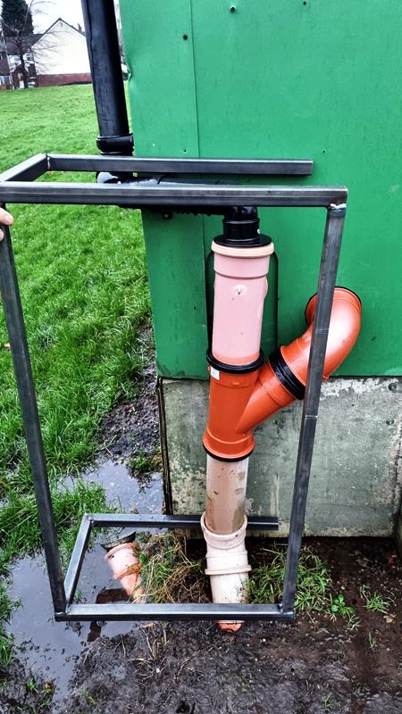

I’ll probably be down on Sunday, I’ll drop you some more inStarted to make a cage for the Soil pipe at a local Scout hut. The scallies come along and kick it to bits covering the field in waste so not good, I am trying to put something around it to protect it. I am going to hammer a couple of lengths of rebar into the ground and weld it to them, we will see.
It needs some tabs for anchor bolts welding on:
I can get power to the area so I will take the set and use a couple of those nice Fincords I nicked from @Tinbasherdan to weld the RHS on and the rebar "legs" They are nice rods Dan. Bring more!

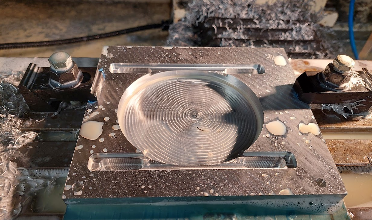

Only one cutter was harmed in the making of the swarf (pesky clearance/retraction heights in F360!), and it fits.
Just need to countersink the bolt holes from the opposite side, trim the two oversize sides, machine up the bars for in the slots, and I might get the first servo motor bolted onto the big lump of iron that's been sat in the workshop for the past year or ten...

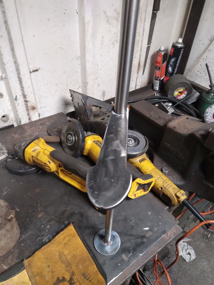

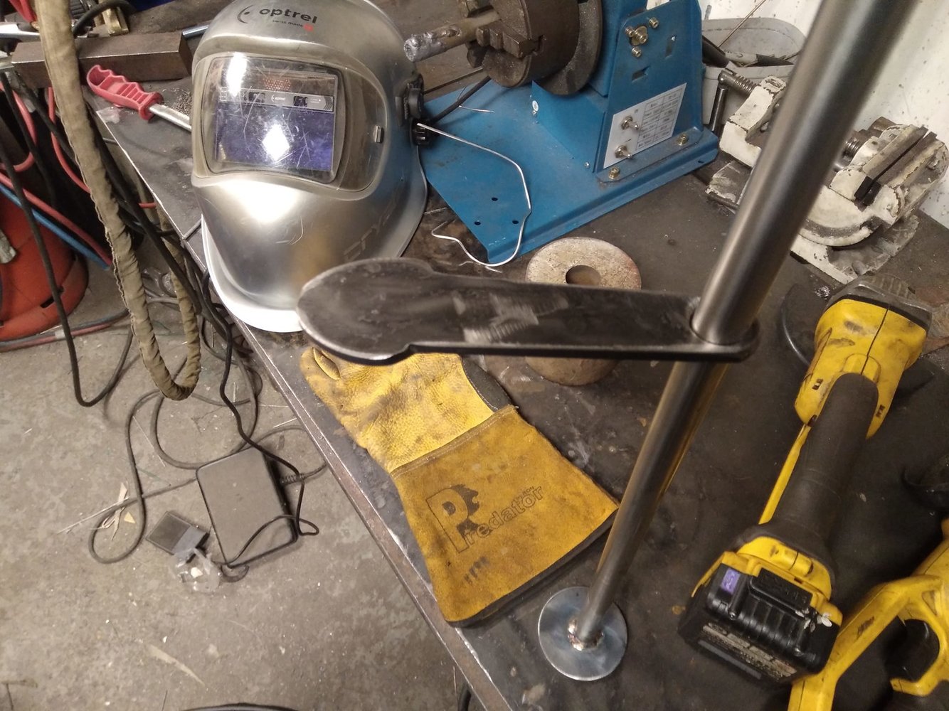

I then adapted the quick and dirty rod bender I made years ago for a specific job so that I could make a U loop in some 8mm stainless. The adaption was to put a socket over the bolt so that I got the correct radius
Worked well, really should make up a better one some day.
I then bent some 60mm x 5mm 316 stainless in the new press and welded the loops to them.
