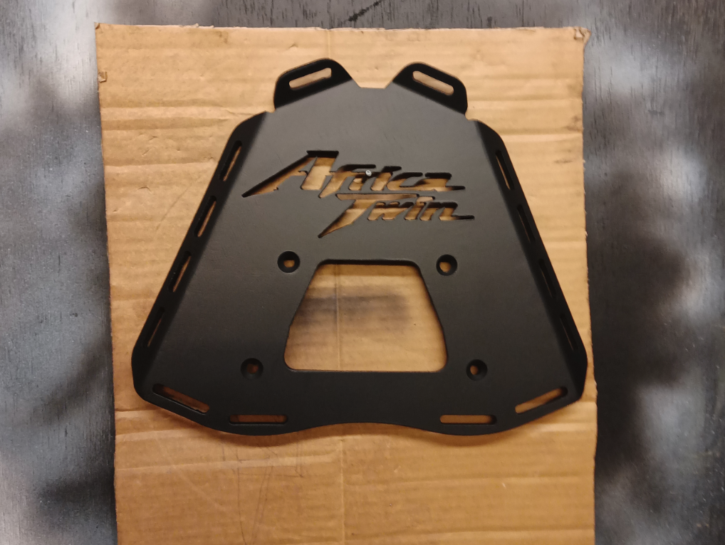

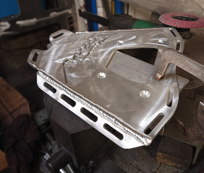

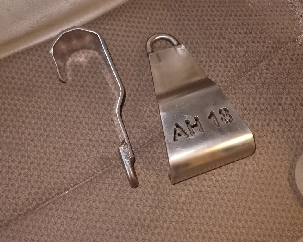

What about a dashed line to bend on? I’ve done that quite successfully a few times.Nah, if I could bend instead of welding then possibly but I can't so...
Would still need welded up I think and that may look crap unless I did better inside grinding.What about a dashed line to bend on? I’ve done that quite successfully a few times.
That is true.Would still need welded up I think and that may look crap unless I did better inside grinding.
It's not so bad, it was just the wee "a" and not the big one.Nothing worse than having the centre of your A drop out![]()
That is true.
The few bits I’ve done recently have not bent clean, just cracked. This new steel is ****e.

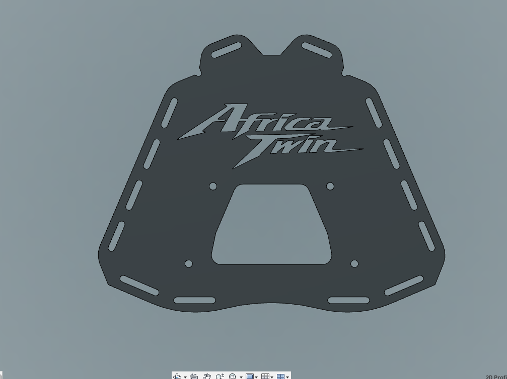

What thickness?Waiting on some glassing being done before I can measure up for an aluminium corner piece so decided to give making a rack plate a go.
Got it cut on the plasma then welded and painted.
Few cock ups though. First is I had to use the bigger nozzles as I don't have smaller ones and for the text I had to programme at 1.6mm kerf and the nozzles have a 2mm kerf hence the centre of the small "a" dropped out. The next cock up was I decided to grind the welds flush but made a mess of the ones on the upper tabs.
I am reasonably happy with it as a first attempt so I reckon I will make another, possibly just leaving the welds and also get it powder coated.
