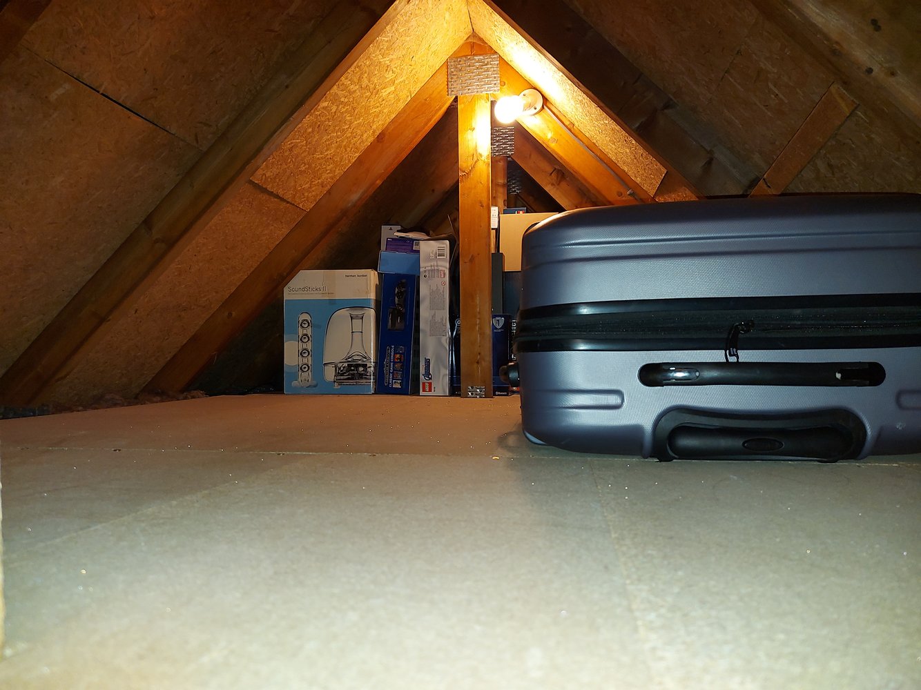

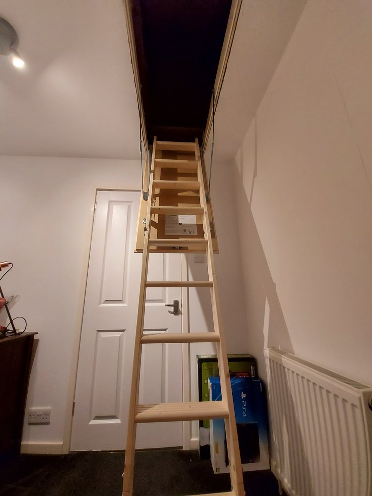

The wooden attic ladders are so much better than the aluminium efforts.Put this in after work this week. One of those roundtuits off the list finally
View attachment 322911View attachment 322912View attachment 322913

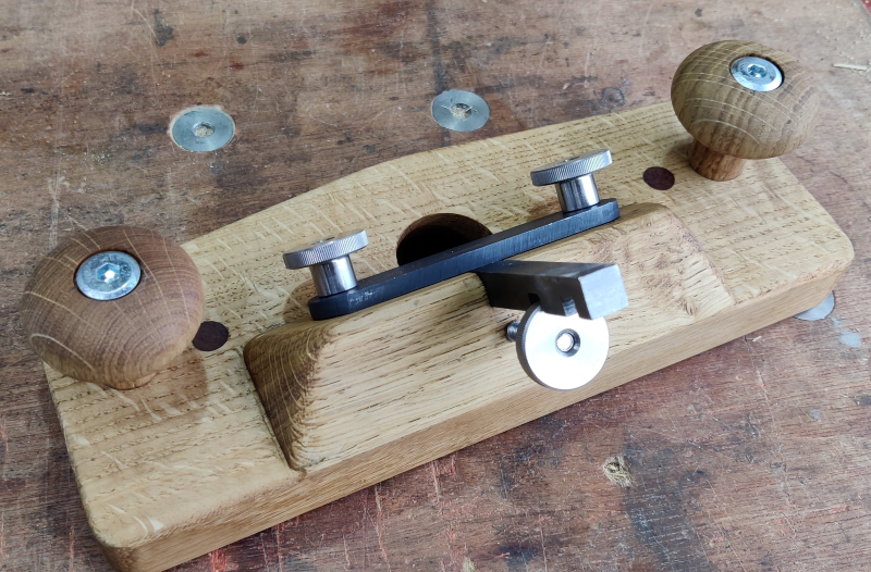

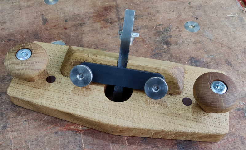

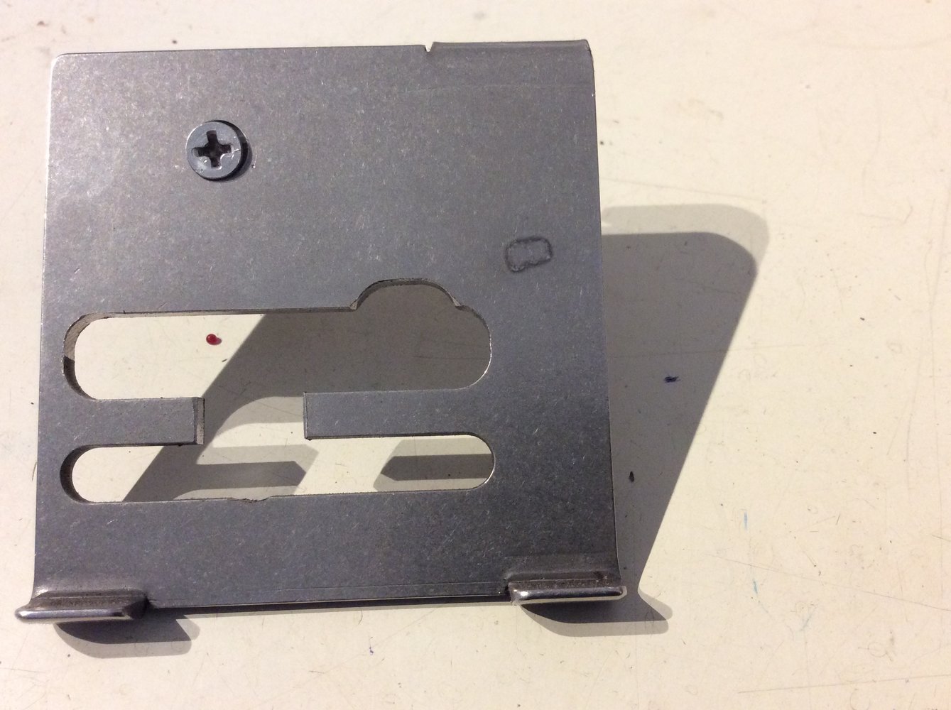

That cries out to be 3D printed in woodgrain.I made a "Paul Sellers" router plane:
Not much to say really: unusually for me I didn't change the design really, although I did make several of the bits in a different way to the approach Paul Sellers used in his video (for example I cut the bottom face of the top wood bit whereas Paul cut both top faces - doing it my way meant I could use the pillar drill to make sure the holes were square). I made two of the cutters while I was at it (I figured that, having made the angled cut for the bevel I might as well use both resulting pieces), so I've got a spare and won't have to sharpen as often! I've already got a router plane (and I used it to cut the bottom of the groove for the cutter), but two might be useful sometimes... maybe? The sapele inserts are there to make it look good of course: nothing to do with drilling holes in the wrong place or anything like that
I haven't tried it yet as it's only had one coat of oil so far; I just put it together to take the photos.
