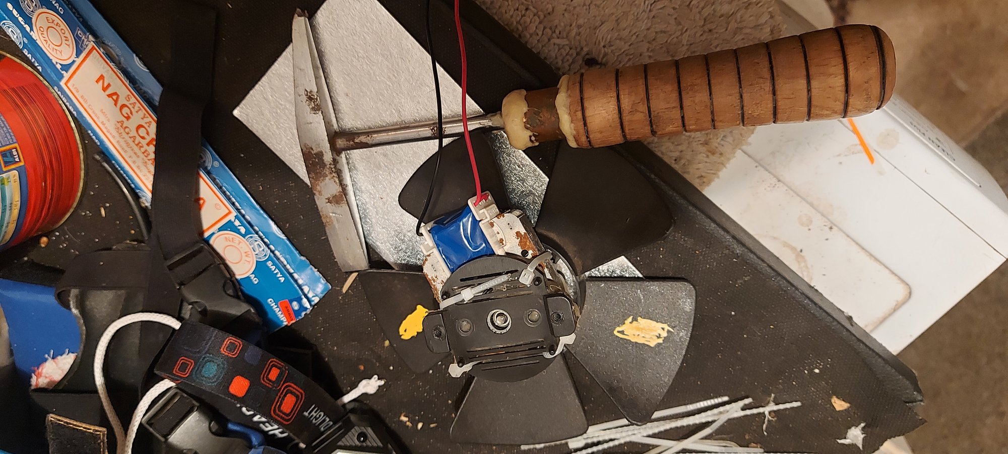

I used Gurrilla expanding glue to set the hammer into the handle .View attachment 479090
I decided to on belt and bracers approach. Found some small tye wraps just in case.
I decided to turn a wooden handle out of a oak branch for my chipping hammer to kill a bit of time while the hot glue cured.

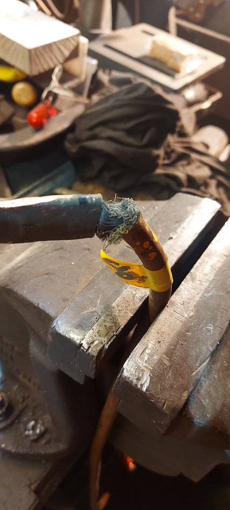

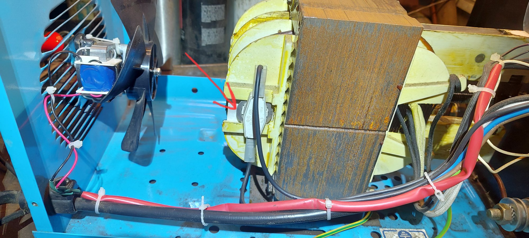

The pos and neg retaining bolts inside the welder casing had 2 seperate nuts,they were only just snug .these buzzboxes are AC
"in and out " so most likely you had a bad connection
Good to know.I stand corrected. The 6013 is a High titania potassium electrode and Potassium is usually added to stabilise DCEP. Not in the case of 6013 though which cam be used with either polarity.
Sorry about that.
Jack
Sounds like a result, then :-) It's a little surprising that the connections to the back of the welder's output terminals didn't show some signs of overheating, but that's probably because the thick copper wires from the transformer would have conducted the heat away from the terminals.The pos and neg retaining bolts inside the welder casing had 2 seperate nuts,they were only just snug .
I slackened them both off then re tightened each one in turn.
I think this was the reason for the issue .
Ark force is stronger and the same now which ever polarity the stinger is connected to .Giving a much easier strike up. Must have been loosing power due to bad connection

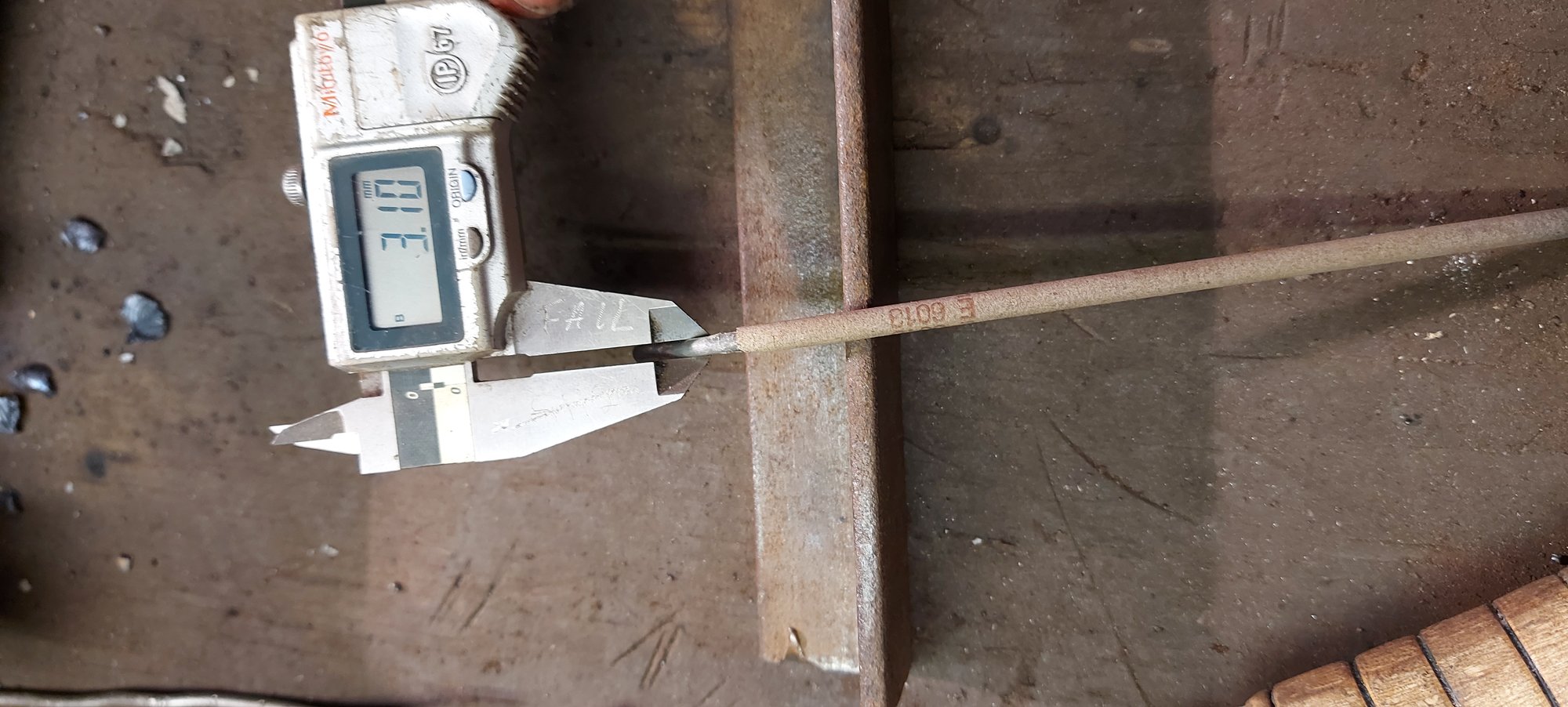

Hopefully you're measuring the metal, not to the outside of the flux. Just checking because normally they're 3.25mm (or possibly the metric equivalent to 1/8")As I prepaired to do the first test weld I realised the rods I had been calling 2.5 mm were in fact 3.7mm with Myconta caliper. so presumably 3.5mm class.
