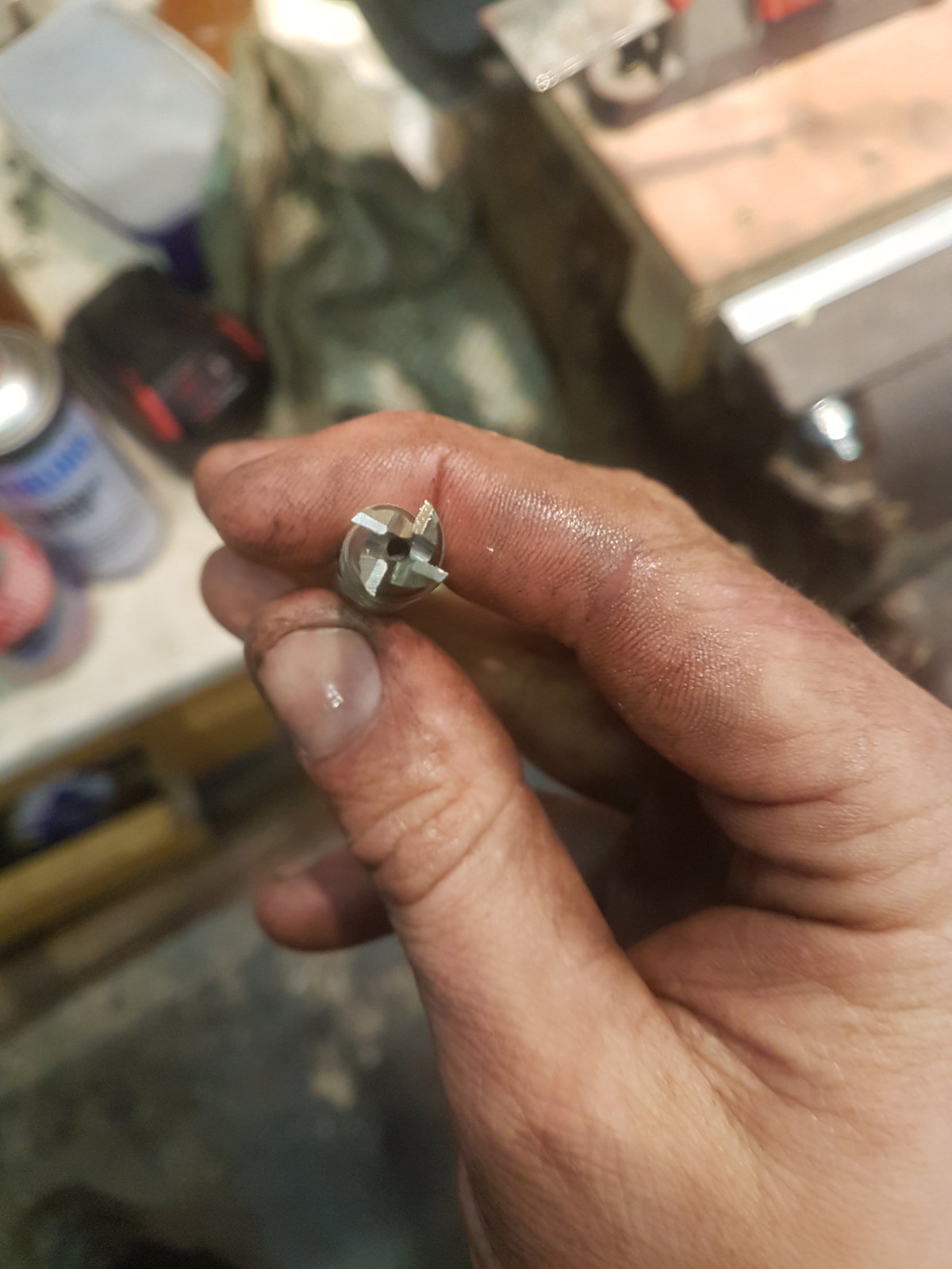

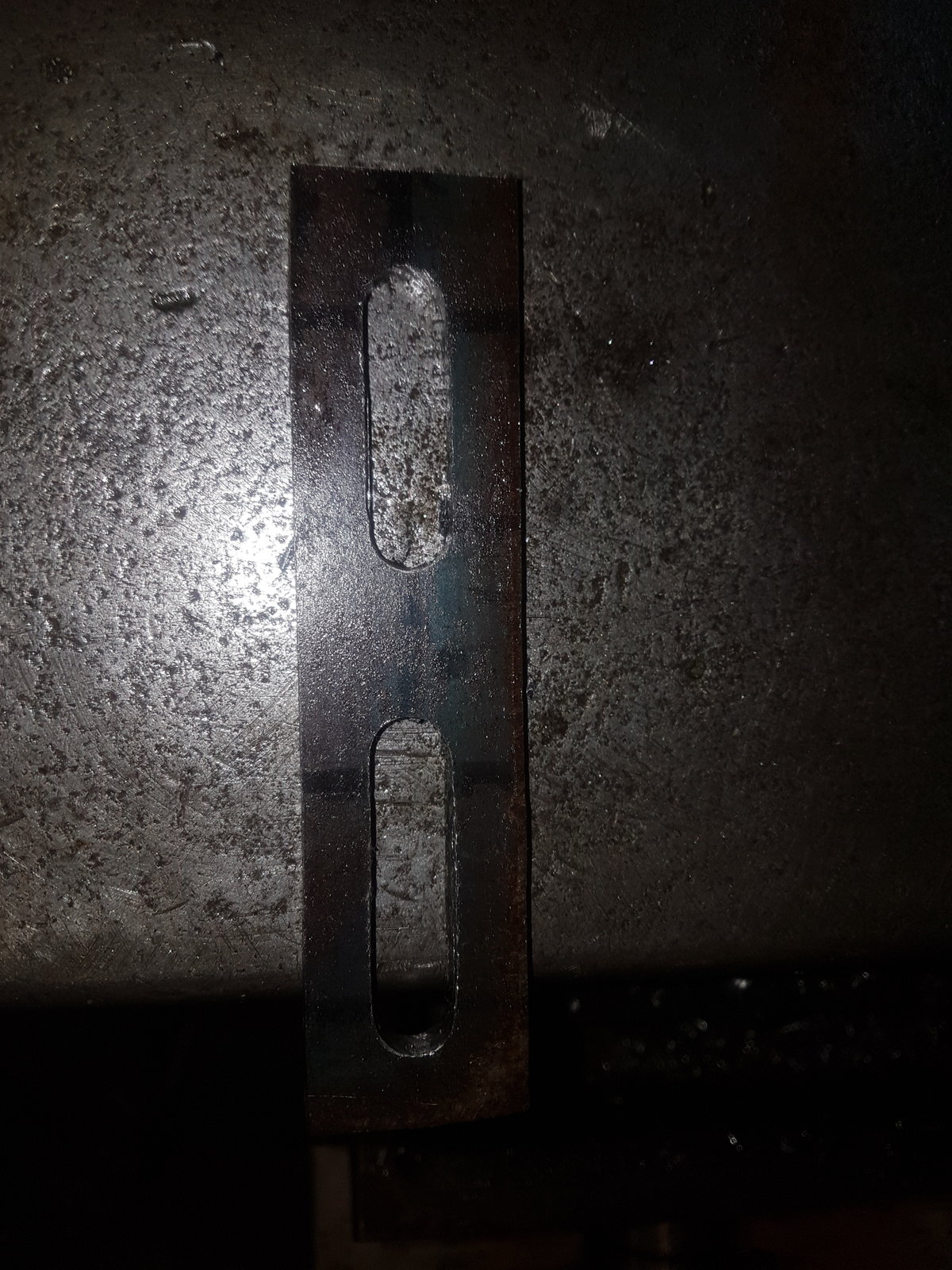

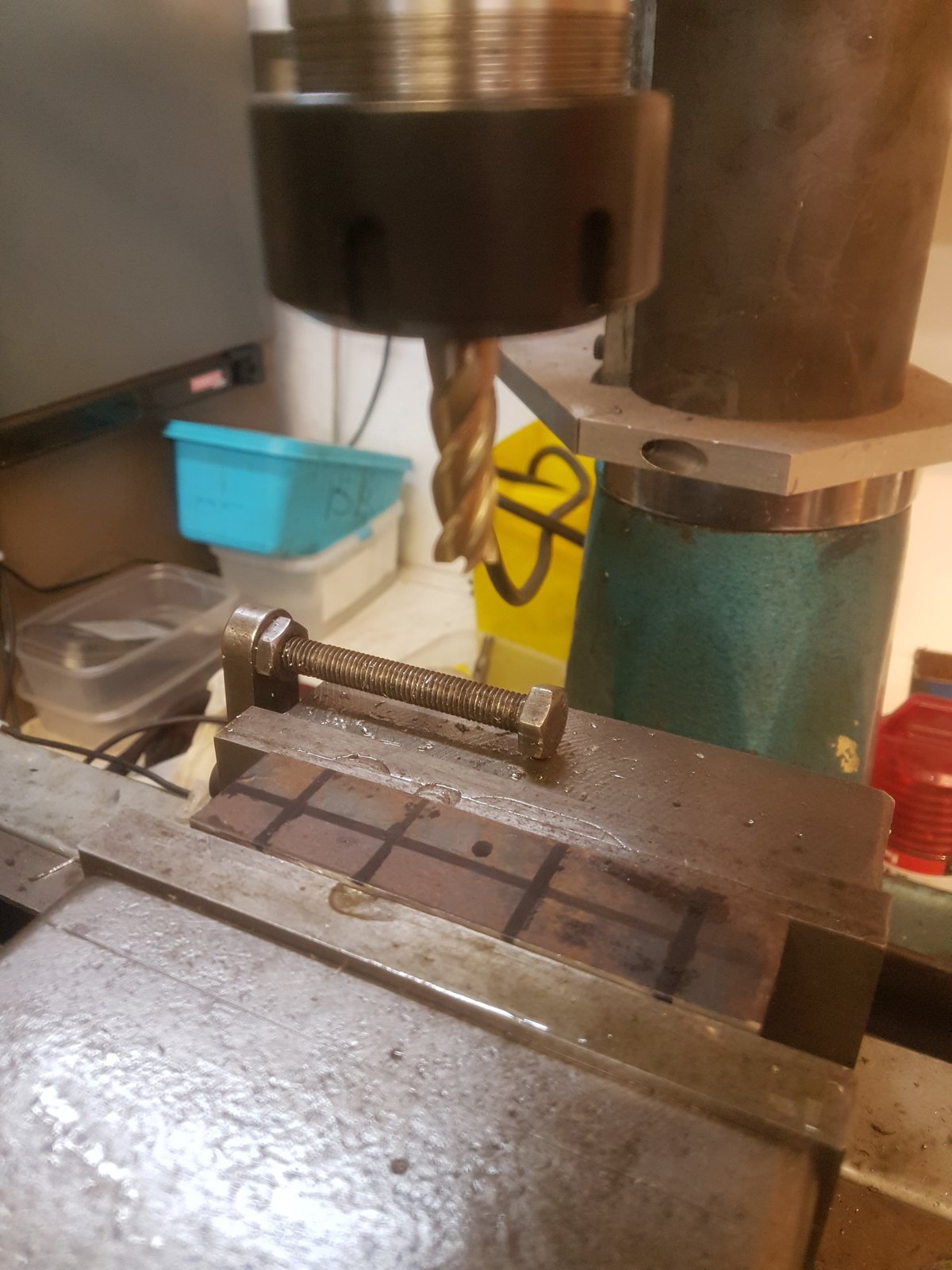

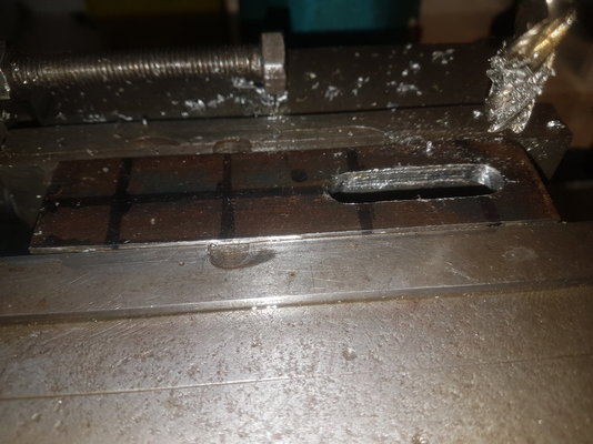

I made some slots today on the mill I really need to use it more
Was your table locked when you milled them?5mm steel 10mm slots
Main thing with manual mills, unless you know they have no/very little backlash, is to mill in the conventional direction, so the cutter is pushing against the workpiece and not climb milling which pulls the workpiece into the cutter (and if there is more backlash than the cutter can handle as a cut, will usually result in a snapped cutter).
This page has a nice diagram - https://engmachineshop.wustl.edu/items/climb-milling-vs-conventional-milling/

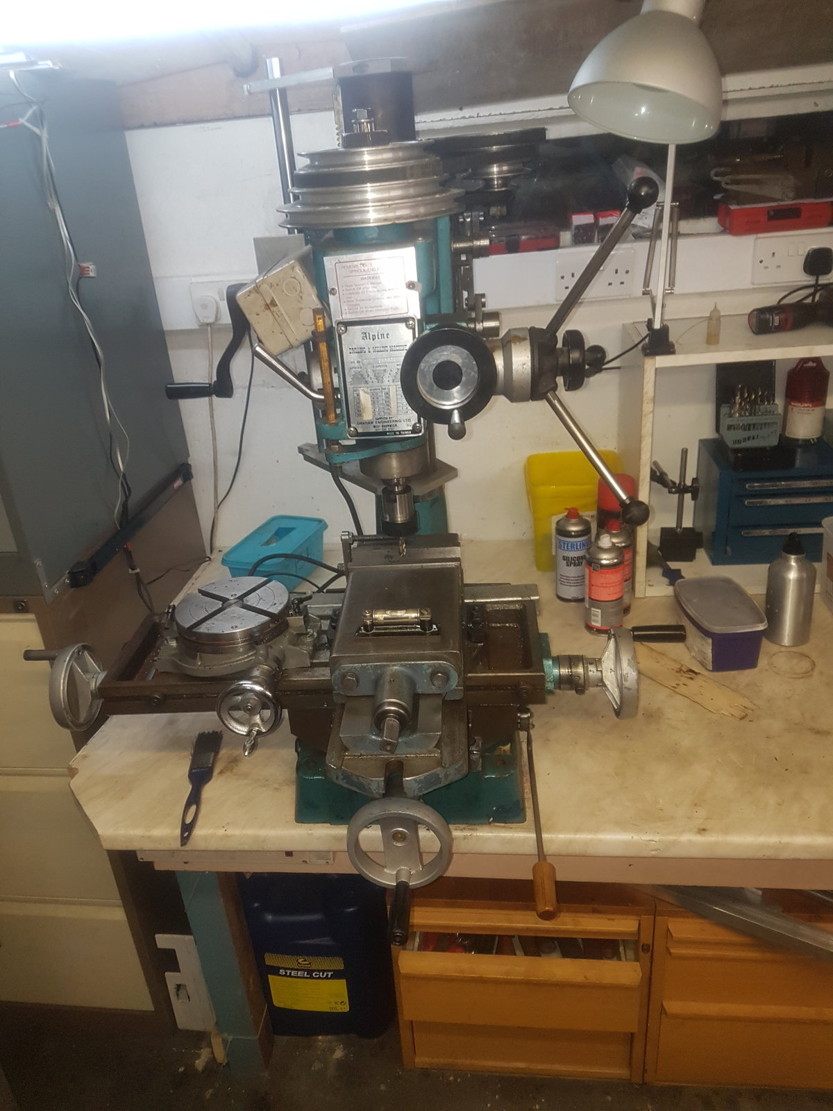

I wouldn't use that much cutting oil. Unless you're using flood coolant, all you need is enough on the cutter to help stop chips sticking to the cutter. If I'm just using cutting fluid (I'd normally use a bottle of soluble coolant if I'm not going for full flood), I'll normally put just a couple drops on the cutter, then a few on the work piece so the fluid gets picked up by the cutter as it moves. Any more and you just create extra mess for no benefit.

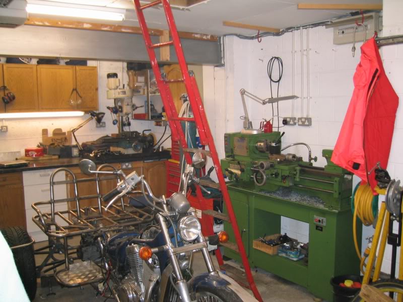

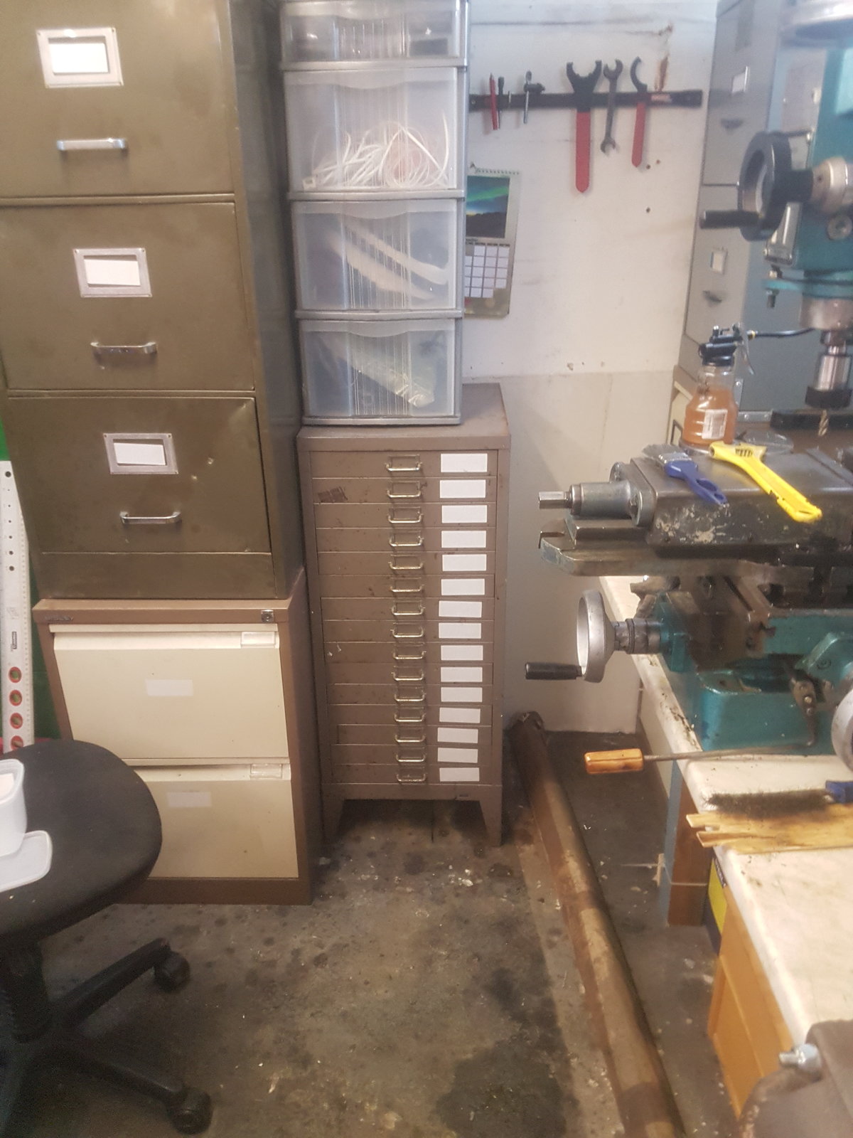

If you ever plan to use coolant or oil, you want a tray under it
You really want to full travel of the table onver the tray, plus a bit, first one I made, handles were inside too, but that was a pain as I kept catching my knuckles. So if I was to do it again, on a similar machine, id use the graduated dials as a guid at full travel for the edges of the tray.
I had to dig back in my old photobucket account, its not the best picture. Basically its a 1.5mm thick steel tray, folded edges, welded up the corners, about 40 mm deep. What you cant see is there is a 1/2 inch drain in one corner to a coolant tank in the cupboard underneath. I didnt even paint it, made it, plonked mill on it, marked the holes. Lifted mill, slid mill about to drill each hole. Then bolted it down with a bit of stag jointing compound, to stop leaks through the bolt holes.Do you have any pics of your one? I am thinking shll I cut and weld these ali trays up I have or better to purchase a sheet of something else
Its actually a suzuki intruder trike I built for the Mrs. Since moving to the country with our really bumpy drive, it never got used, so she sold it.Yam irs trike? I have a vmax with the engine in bits. Part exd a 750 hard tail qwack for it, the thing killed my back.
I did plan to trike my Fat bob too, but sold that as the potholed bumpy drive was wrecking that too! Shame it would have made a nice trike, Id made the diff etc too.I was down to 12 psi on m&s tyres, it was still murder. Also caused a load of drag. Nice trike
