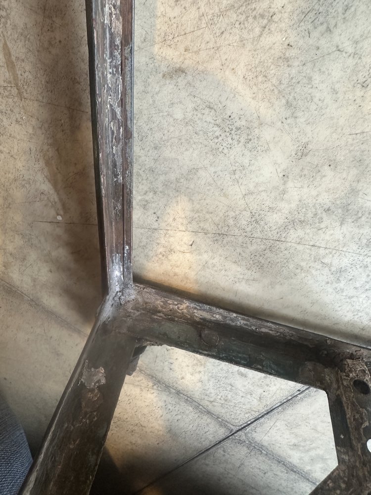

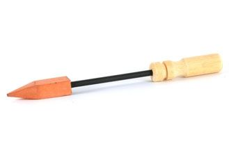

Get a copper soldering iron around 20mm square so it will hold plenty of heat. clamp the parts in position and away you go. Soft soldering is very forgiving, it wont destroy or knacker the material. If it doesnt look right you can just try again.
If you were a bit closer i'd say pop round and i'll show you how to do it.
Solder only goes where it's hot and it only sticks where it's clean.Wherabouts are you?
I’ve never had any luck with soldering the solder never goes where I want it to! So this is for someone with a bit of experience I know it won’t be cheap but it’s got too much history with me not to get it fixed.
Tin the areas you want joined beforehand, then more flux and heat.Wherabouts are you?
Go on, have a go yourself. The satisfaction you will get when you do it will be unbelievable. I've tackled jobs for Lichfield repair café that I didn't think I was capable of, But I got stuck in after a bit of research and surprised myself, and the clients who the repair was for. Remember, It's broke, If it doesn't work, It's still broke. you haven't lost anything except for a bit of time.Does anyone have the ability to take this on?

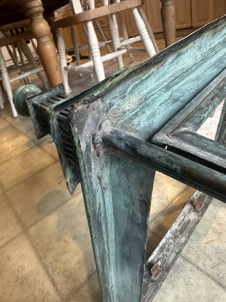

I used to make terrarium's years ago & used copper sulphate solution to age the solder. It turns it a bit like old pewter When you wipe it on with a sponge or cloth.can you ask him what paternation fluid he used please. I could do with some of that myself. It looks a great job
You must be more than pleased with that level of work. I know I would be.
The patination fluid used is a generic version of what used to be called Tourmaline and is more widely available labelled simply as. 'Patination fluid' or 'metal antiquing fluid' often as a black or brown version in terms of the patination it gives, 'black' giving a darker finish, although the stuff itself is usually blue liquid.can you ask him what paternation fluid he used please. I could do with some of that myself. It looks a great job

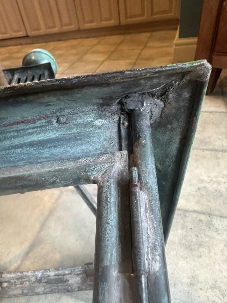

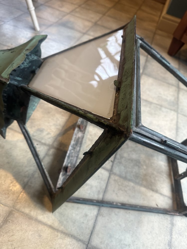

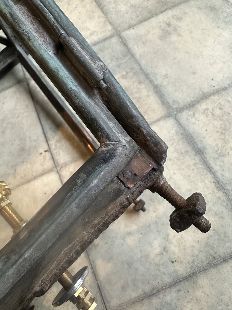

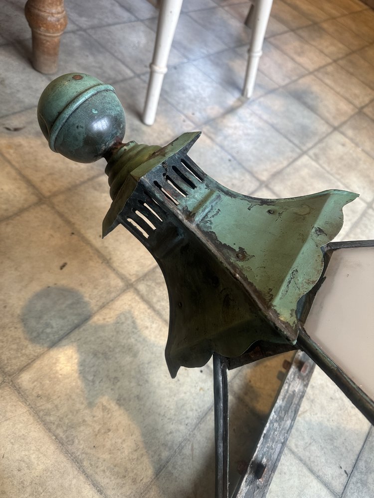

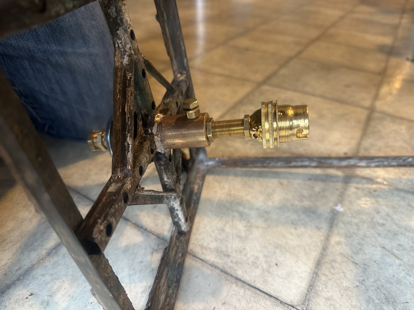

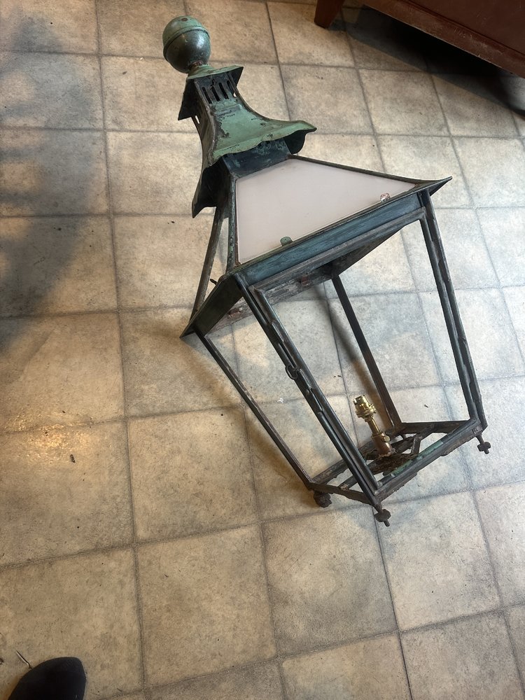

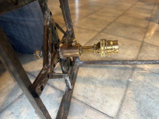

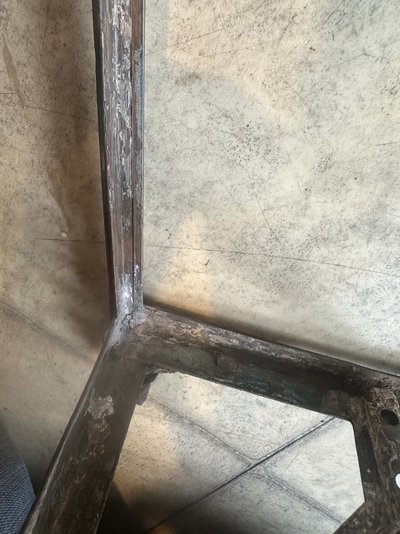

Well, had a bit of success with this now. A guy nearby took it on and did a great job it’s very solid now and I’ve just got to get some glass cut to replace the broken and then find the right putty to fix it. I machined up the new lamp holder arrangement and he soldered that on too, then he somehow patinated the areas he’d worked on so they blend in. He also strengthened the lower corners with a strap he riveted on (can just make this out in the photos).
The victorians really knew their materials - this is well over 150 years old and with it beefed up a bit if I doesn’t get hit by another tree I can’t see it won’t last another 150.
I’ll put some more photos on when it’s back in place in a few weeks. It stands nearly 3 feet in height so quite impressive when it’s on its pole.
