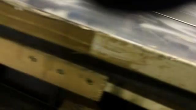

Ah, thankyou, worked wonders. appear to having some wondering arc issue, but i dont have any didicated grinders as of yet. Seem to be getting on fine with the trigger, but not so much with the Pedal.

I thought I recognised that type of aluminium in the OP which has some sort of coating or hard oxide layer. I have to admit I am a beginner TIG welder but a quick Dremel on that stuff will avoid the contamination you can see above.
There's no oxide on that that is perfectly fine to weld as it is, unless it is some sort of anodised finish which I would remove with a DA with a fresh sanding pad.

All aluminium has an oxide layer and it's because of that we weld it in ac.
Anodising is a completely different coating and looking at the welding it's not there in this case.
Yes sorry Richard, what I should of said is there is no excessive oxide layer which would need to be mechanically removed prior to welding, the EP portion of the cycle should be more than capable of removing that, that's how all the aluminium at work comes in and I don't touch it with anything.
There is a technique ive seen used for welding directly on to an anodised finish by hitting the current on and off with a pedal. I can't do it successfully and would always suggest it's better to remove it. If a chemical removal isn't feasible then the best approach would be a mechanical one with a clean file on the area where welding is taking place. Power tools such as sanders, grinders tend to smear the coating and impregnate it with the soft Alu underneath it. Welding directly onto this and you will see little speckles floating around in the pool.
All this aside the Alu shown in the op's pics isn't anodised and looks relatively clean in its normal state for welding. Any issues caused to effect the welding here will be easily addressed with set up and technique.
