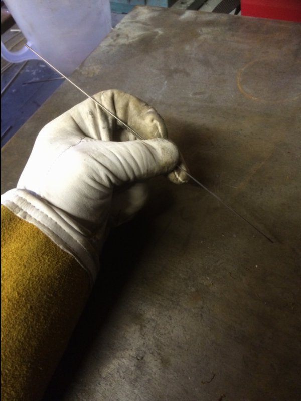

It's not the fact that the torch gets hot, you really should think about getting a pair to stop harmful UV from the welding process. Even if your hands don't feel hot they will be getting damaged by the UV - skin cancer is not nice.I don't bother with gloves .
As I'm just learning tig , I'm only doing little beads and if the torch gets too hot it's time for a cup of coffee and a smoke .
