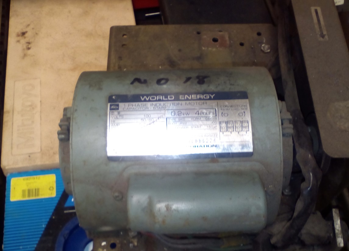

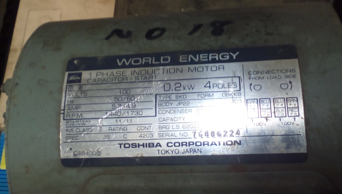

I wouldn't worry too much. You'll never need a spare motor. They don't go under much pressure turning those pumps over.Just back from the workshop as I was searching for something, never found it but did find a small motor I forgot all about. It originally had a vane style vacuum pump fitted to it but that eventually got thrown out as any liquid that got inside meant the vanes stuck and the vacuum was lost which was no use as it was used on my mill with coolant, no great loss as I only paid 99p for it
Anyway I saw the motor and thought it would be great as a spare for the Procon with a wee bit of adaption, sadly the label shows it not to be quite as suitable
Would the pump be destroyed by doing that? I thought it would just bypass, man I better be careful thenI wouldn't worry too much. You'll never need a spare motor. They don't go under much pressure turning those pumps over.
The pumps are gonna wear out before the motor particularly if you have a moment of madness and switch it on without your torch connected. That will see it hit an early grave lol.

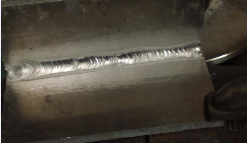

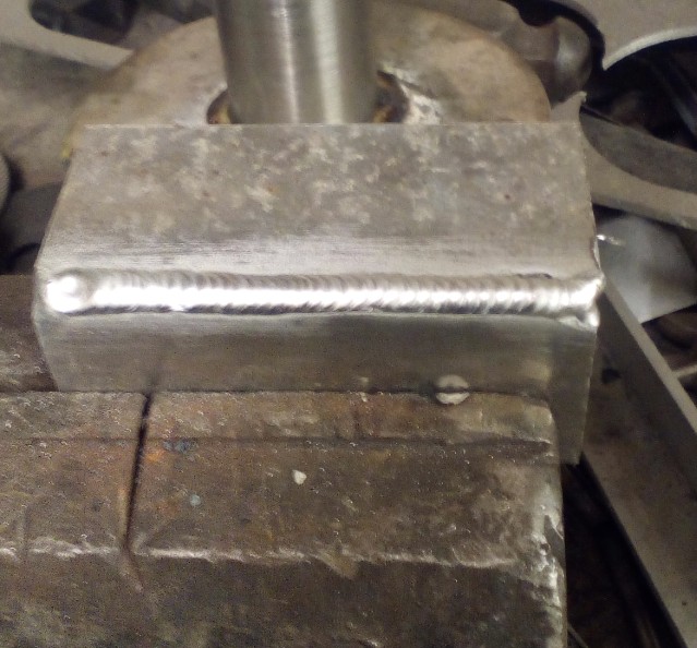

Got a few mins to try out the WP20 torch, took really bad with it being so small, have never used anything other than a WP26.
Just had time for a couple of short runs, outside corner and then flipped and did the inside, my hand slipped on the inside weld as can be seen by the narrow bit. Will take a few welds though to get into the way of such a small torch I think.

Glad your getting to try the wp20 out. Was that the Chinese pump you used with it.
Wp26 are awful in comparason.

Yes was using the Chinese pump, quite a bit of vibration in the torch, well probably not a lot really but it was noticeable. At this stage I actually prefer the 26 but I reckon after a couple of proper welds I will be of the same opinion as you, it is just I am not used to it.

It probably wasn't that but, likely just I am not used to water in the torch.You'll get no vibration from the procon. You'll feel the water circulating through the lines but hardly noticeable at all
