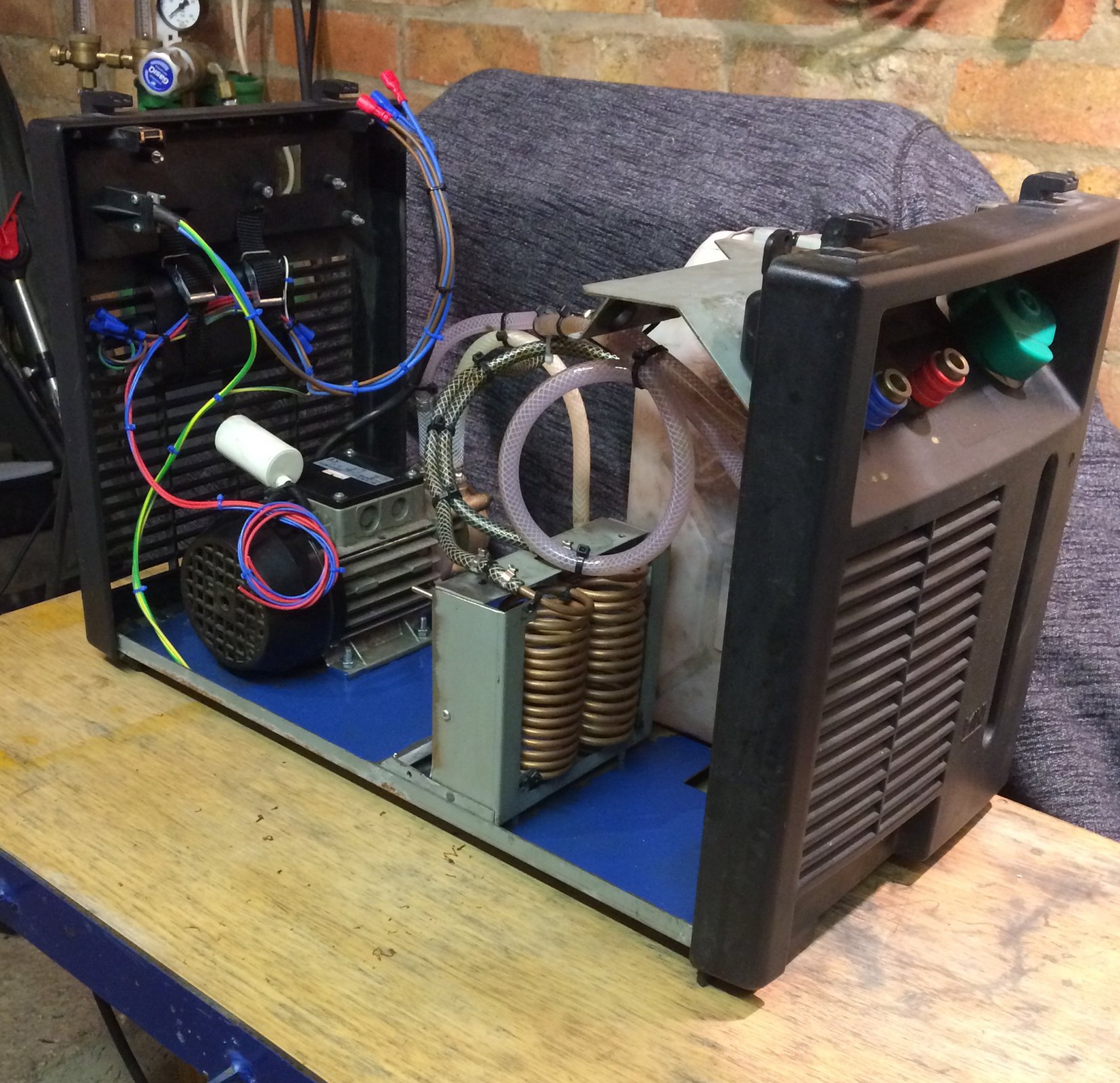

I have to wait for my motor/pump before I can start building it, hopefully the post will be getting back to normal although not sure how long it will take from Portugal.Mines done.

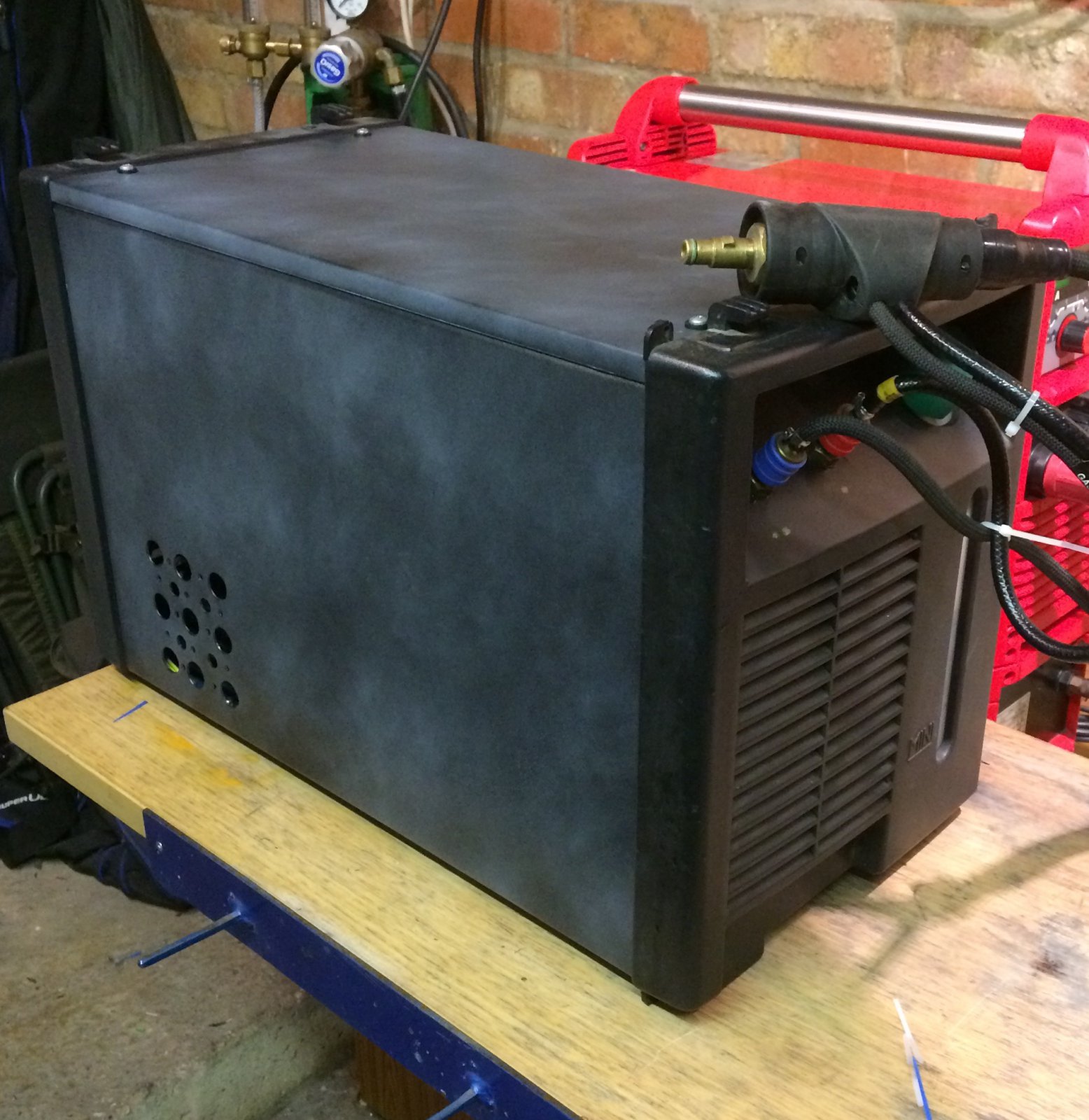

And here was me thinking you had painted it when it was damp and it had bloomed, only jokingand a mega cool misty night paint job..
Ah well was kind of big anyway.Ha ha. The paint was just a bit of rattle can experiment. I was gonna go white but then I thought it looked boring so I misted some satin black on it lightly and thought yeah it's looking cool so then I went a little darker with the black and misted some silver over that. Well pleased with the colour. I usually spoil my work with paint but it looks awesome.I have to wait for my motor/pump before I can start building it, hopefully the post will be getting back to normal although not sure how long it will take from Portugal.
That case kind of reminded me about the first Tig I had, Parweld 200 amp analogue inverter, just threw it out about 2 months ago, could have used it as a donor caseAh well was kind of big anyway.

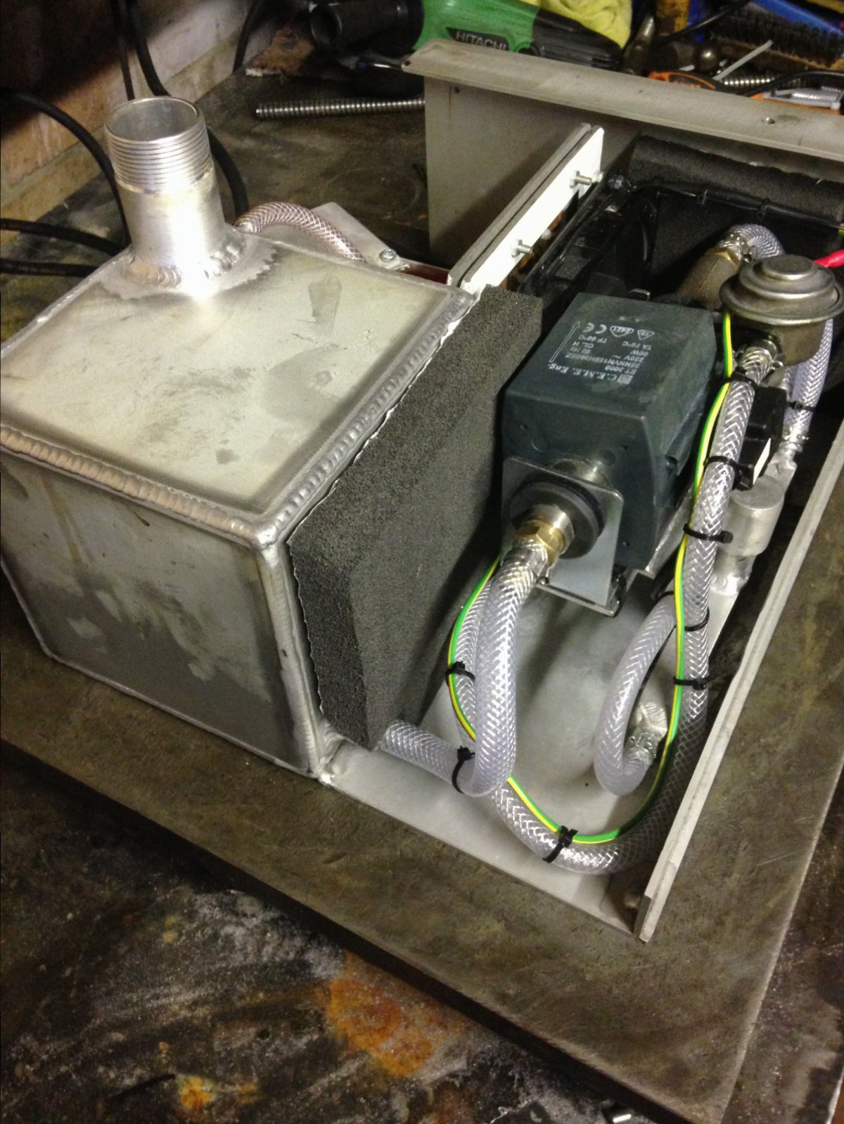

Well so long as you can get the heat out faster than it gets in your alright. The problem occurs when you box up that little motor and don't get that heat out. I've done it a couple of times and after 20 mins it's just like a kettle. The water in the tank starts getting really warm. Yes copper lines will be up to the job but you'll still have to get the heat out. They won't split but they will conduct heat well. Good air flow over the motor and out the box resolves all problems.Re: the softening lines splitting...
If you can keep the heat out of the water (insulate 'twixt pump motor and everything else maybe - then have 2 airflow paths) then why not change the material used for the lines?
Lagged smallbore copper internally?
Yes. Not sure what I'm going to do yet. The pulse pump while excellent and compact is a bit too noisy for me and having the cooler on the bench is vibrating the bench.Are you looking at an alternative Brad?
Hmmmmmmm.Yes. Not sure what I'm going to do yet. The pulse pump while excellent and compact is a bit too noisy for me and having the cooler on the bench is vibrating the bench.
Yeah the motor will be fine. Sounds a plan.Yeah, I was thinking along the lines of a compartmentalised enclosure - so the motor is in it's own compartment and cooled independently of everything else.
I'd imagine the motor itself can handle many degrees, so isolating the majority of that heat should allow a smaller overall enclosure?
Brads is already sat on a huge foam pad that I put there. It didn't seem too bad when I tested it but I never sat it on the bench while welding.Will sitting it on foam or neoprene feet not stop the vibes transfering to the bench.
