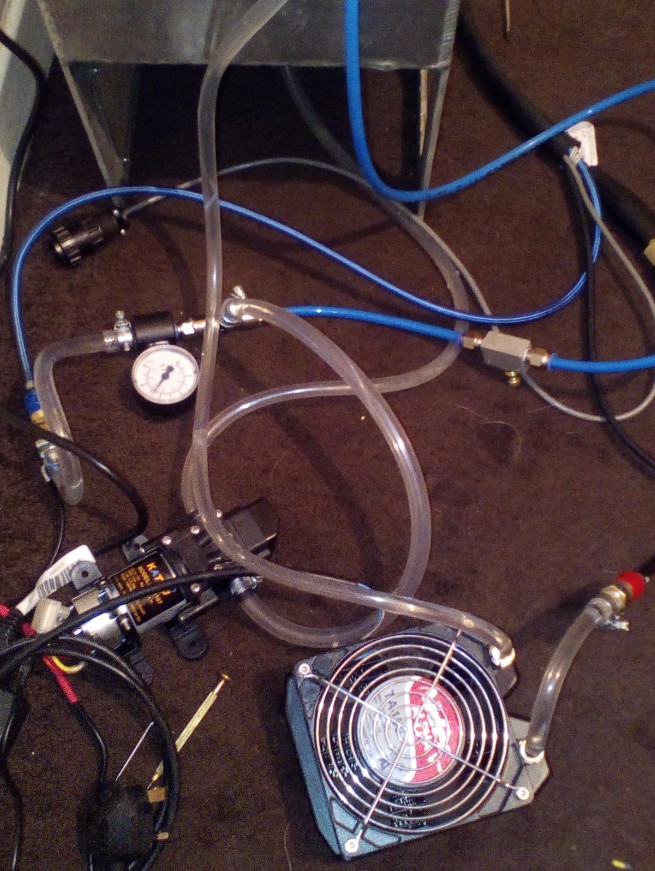

I like this method.So next plan is to fit a Y piece in with a gate valve so that I can reduce the pressure that way rather than using the built in reducer and hopefully keep enough flow.
I adopt it with the procons and open them right up. It's a great way to have full control over the pressure and flow you want down the torch without effecting/restricting the out put at all.
