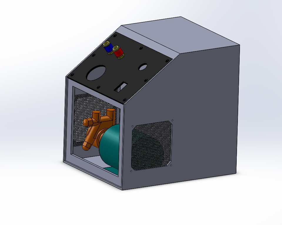

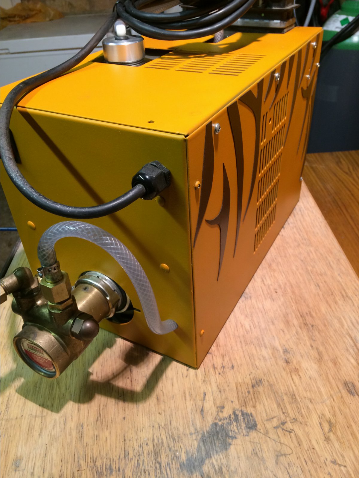

Are you able to bring the pump head outside and connect your torch straight to the out going like so. The proconsul are awesome but the motor can get to 70 degrees C and be happy under normal working. The pump head is brass and conducts the heat. If it can be out in the cool it helps loads.@Richard.
With regards the Procon on the other thread.

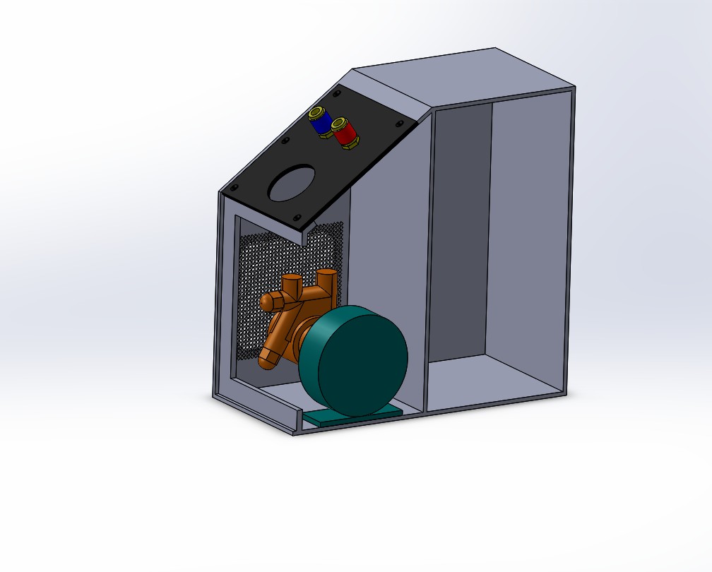

I am thinking I just need to make my cooler a bit wider and possibly a bit longer and have a fan either end of the motor basically as in my model posted earlier. Air will be drawn in at the back of the motor and pulled out at the front, should keep things cool.
