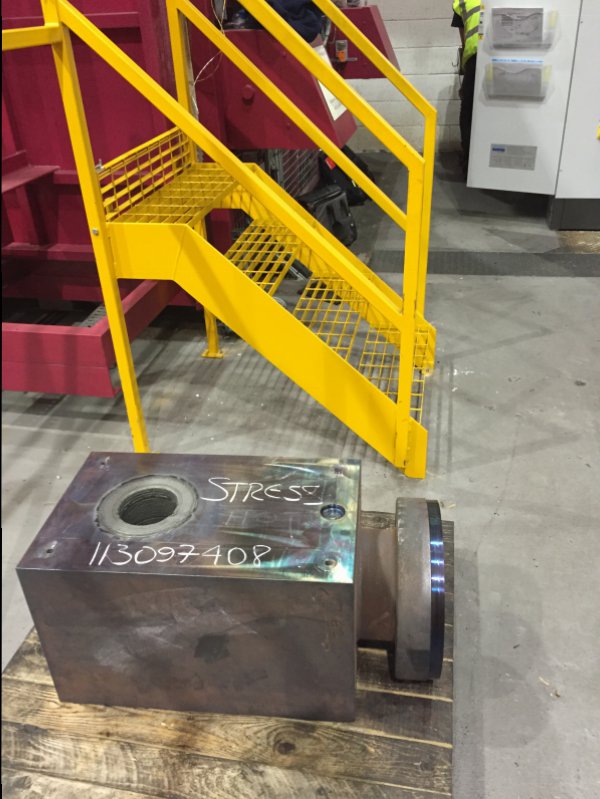

Things like these.....What are O&G exotic valves?

Is the oil/gas very hot or does inconel have other desirable properties for exotic valves?ETA, the buttering of the valves is probably an inconel overlay?

ETA, the buttering of the valves is probably an inconel overlay? Cheaper than making the entire thing from the stuff
Inconel is very corrosion resistant also at high temperatures.Is the oil/gas very hot or does inconel have other desirable properties for exotic valves?
Are they named that because they're made of exotic materials?
By spool, are you implying it can be mig welded or is it used in a CWF on a tig welder (Or SAW)? I would have thought this kind of material would only be tigged.A 15kg spool can be knocking on the door of £500.

What Runnach and Richard said. Corrosion resistance, especially at elevated temps is a big part of it. Not my area but as far as spools of the stuff goes don't forget TIG can be used with a seperate wire feed, automated hot wire TIG for example although i believe some of the fancy synergic MIGs are also used for cladding these days?Is the oil/gas very hot or does inconel have other desirable properties for exotic valves?
Yes it's used very heavily in mig form and one of very few that will run in mixed gas as well as pure argon. (It's nicer in pure)By spool, are you implying it can be mig welded or is it used in a CWF on a tig welder (Or SAW)? I would have thought this kind of material would only be tigged.
How does hot wire feed work?hot wire TIG
