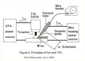

There is a slight amount of current applied to the wire before it gets to the weld pool to get it hot.How does hot wire feed work?
It's again an automated cladding process. The extra heat in the wire allows you to get more deposition down before pool chilling. I suppose It also aids with burning off any last contaminants before they get to the pool.
