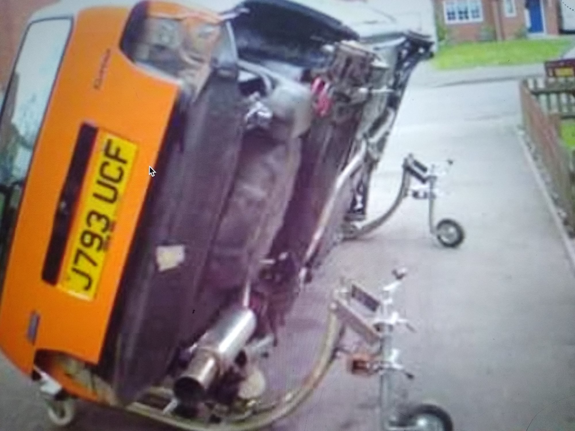

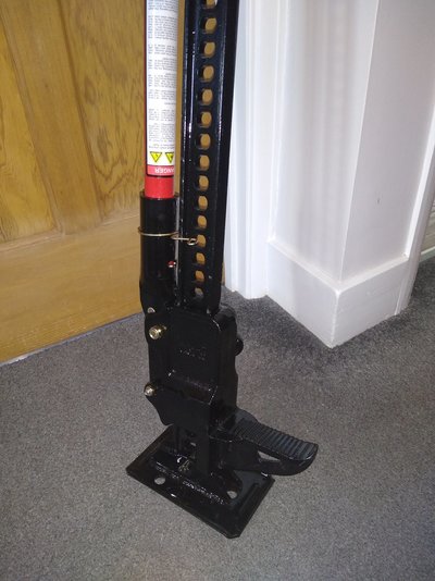

Have you used a hi lift jack before?But then I needed a safe way to get the car tilted ....some more shopping was needed
Sammy7 ....it's a car tilter/roller. You bolt it onto the wheel hubs and it allows you to push the car onto it's side so you can work underneath more easily.
I'll post some pics once I have it in operation.
Cheers fizzy....not used one before but I was reading the instructions and it said exactly the same thing. Apparently the load will tend to flip the handle upwards so good tip.....was also mentioned in the instructions under the "risk of death" section
I was shocked when I pulled the reverse lever and it all fell to the floor....turns out it needs a minimum load for the reverse to work too?
The Figaro only weighs around 800Kg....so reckon Ill be lifting an initial 400Kg which will decrease as the car is rolled.
The tilter I really wanted was the one made by a German company called liqui....the lifter is all built into the rig....very nice bit of kit. (Tinternet photo)
I may rig up something similar as this looked quite stable?
That just looks so wrong, handy things to have no doubt about it but it looks wrong every time I see a car on a rig like that.^^^ I think cj autos does one with a wheel kit that you can attach once it's over....then you can push it around the garage. But I think they are selling what I bought for over £400....then you have to add the wheel kit so starts getting very expensive.
I saw the liqui for £425 but I'd set me budget at £400 and it didn't happen....I've ended up with a roller and a 5 foot farm jack instead

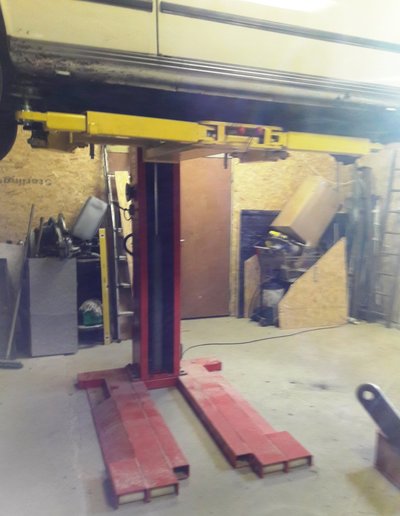

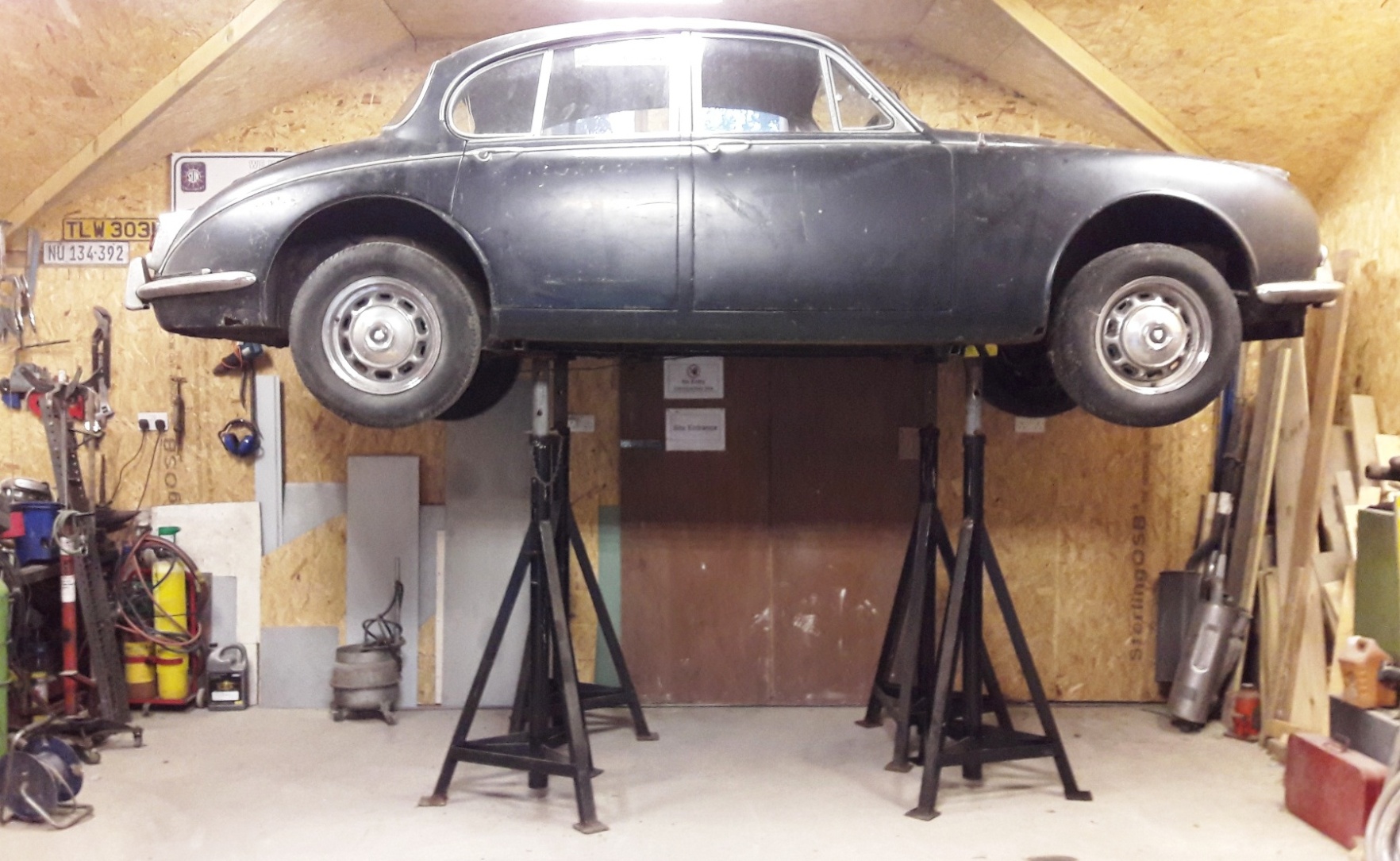

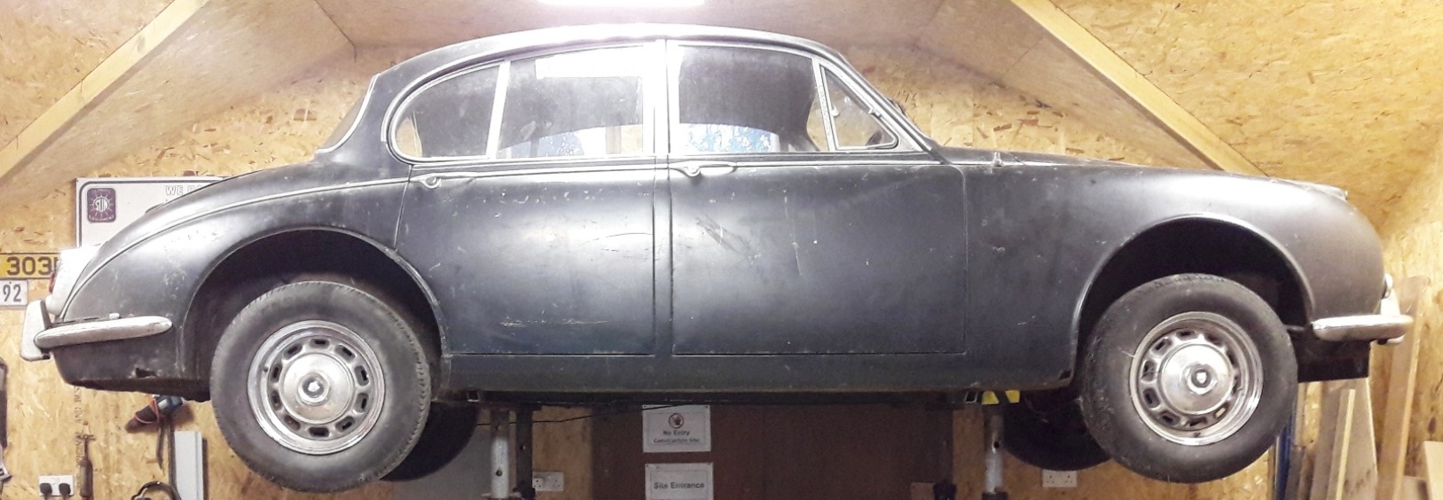

they were used to support HGV's when using the lorry lifting gear I put up for sale, not selling these
How did you get it up there?they were used to support HGV's when using the lorry lifting gear I put up for sale, not selling these...… way too useful, and very heavy..... have a bit of a backlog of cars waiting for attention, Jag has been up there for 2 1/2 years but now I have the compressor working ……..
