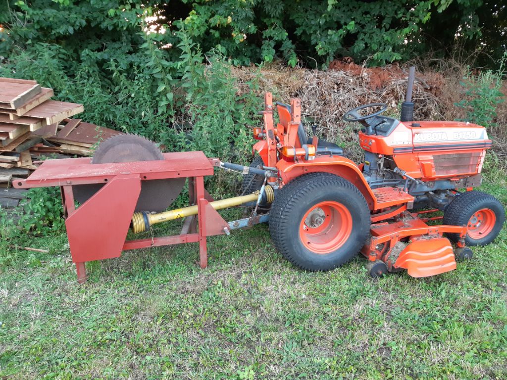

I actually got this 6 months ago but only just got it working. It's a dennings pto sawbench, it originally had the tractor at 90° to the blade but I modified it with a 90° gearbox and moved the 3pt linkage to the end., it allows access to both sides when cutting. Changed the old bronze bushes to pillow block ball bearings.View attachment 301553
