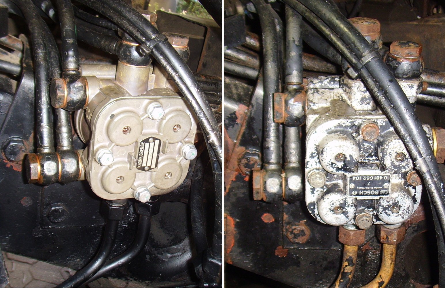

Nice write up Carsten. Cheers.... today I have acquired a lot of air and an improved braking system:

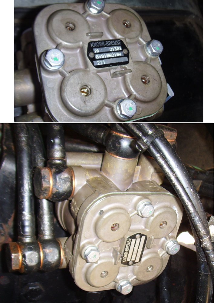

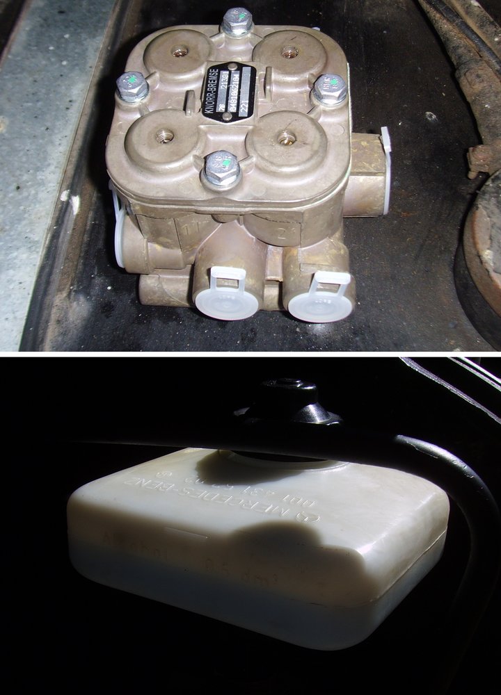

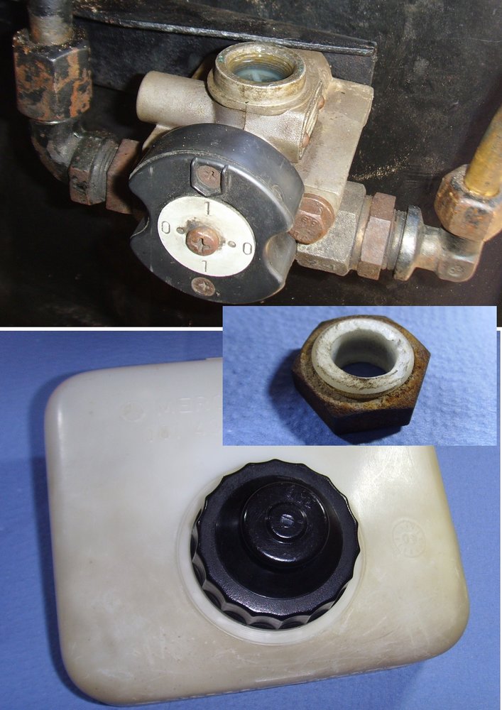

As the last vehicle that has to go through the TÜV/MOT for this year, it was the Unimog's turn.
What no inspector has ever done on my Unimog, as long as I own it: He kneels down next to one of the air tanks, lets off at the drain valve and watches again and again the corresponding pointers in the gauge, the pointers rush through, none of them stopped at the protective pressure -
Verdict: The four-way protection valve is defective. Thank you very much.
The brake was not affected in any way and if I lose air, then the spring brake accumulator will brake the whole car without my intervention,
but I could be happy to drive the 250m home from the village blacksmith
Normally:
Four-circuit protection valve does not work as intended -> serious traffic safety defect -> immediate shutdown on the spot ..... I was still lucky, so to speak, or better got mercy cause we know each other.
But I'm not complaining, it's safety related and we were able to take care of some quirks within the course of this repair.

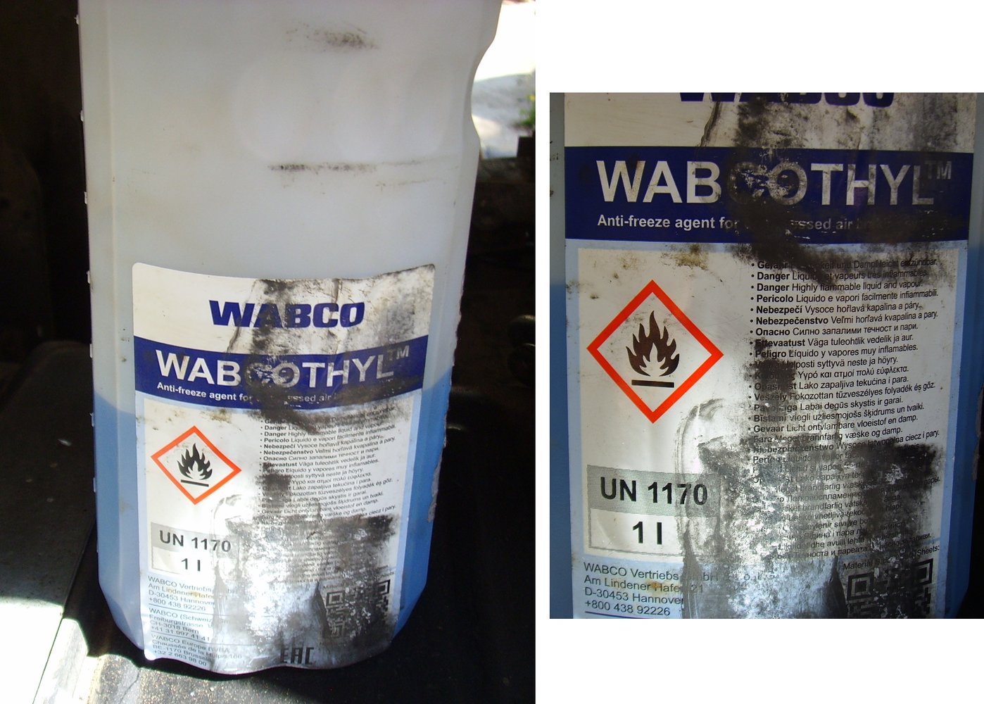

... and maybe I am a little bit to blame myself:

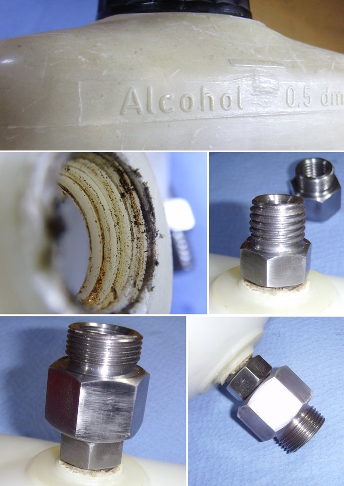

When we installed a larger diesel tank a few years ago (believe me, 80l on this car is officially torture), the antifreeze injection pump tank was ripped off - the village blacksmith has bear powers!
At the open hole probably a) dirt could come in and b) the brake system was no longer supplied with Wabcothyl, which apart from the antifreeze certainly brings other caring vitamins and minerals into the system.
Leaving it like this for several years because I couldn't find a replacement for the reservoir may have easily contributed to the current problems.

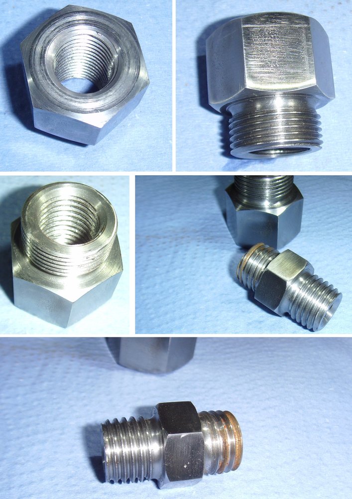

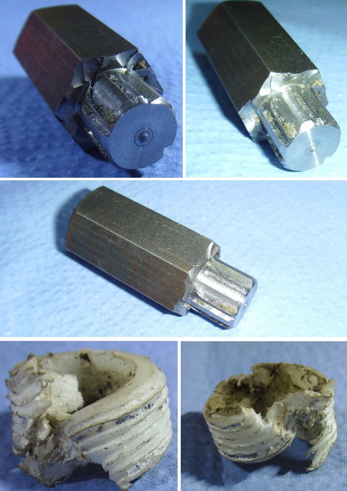

Since we had to do now anyway in this corner, I suddenly remembered that I now have a lathe and milling machine available ...

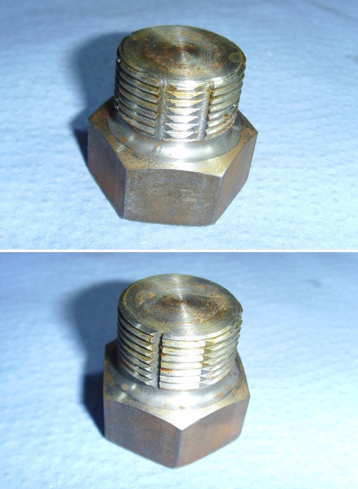

First I built something with which I could remove the plastic thread rest from the tank port of the antifreeze injection pump ...
... and had success: thread M22x1,5
Then I could make a thread chaser to free the threads from the remaining plastic ...
... and had already a cap for this opening.

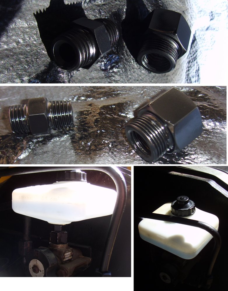

Afterwards I could build two adapters ....
... cut a thread in the reservoir ...
... and mount the whole thing on the car again.
A very successful action overall:
- The TÜV/MOT deficiency is off;
- By working that corner, we were able to find and seal many creeping leaks;
- - as a result, the Unimog now pumps much faster;
- - and holds air significantly longer;
- The lubrication, maintenance and antifreeze system of the air supply is intact again;
- - this fault should not occur again for a long time.
I'm quite happy how this worked out in the end.

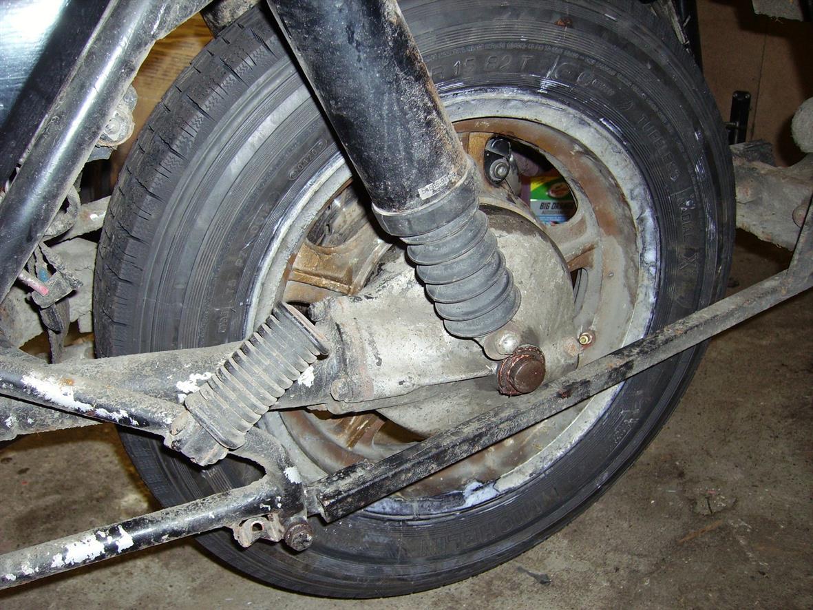

Here's the replacement 155r15 Michelin X...Today I acquired yet another sore back after an hour on the tyre machine.View attachment 362531
I removed the old darkside tyre (135r15) and fitted a slightly wider and taller one (Michelin ZX 155r16) in the suck it and see approach to finding out if there's enough clearance in the swingarm. The 135 was causing the engine to work too hard, but by 'eck it dirnarf shift.
Once my back recovers, I'll fit the blasted thing to the bike and find out for sure.
Pics to follow if successful.
Here's a pic of the old one, the 135...
What happens when you go round a corner with that on a bike?

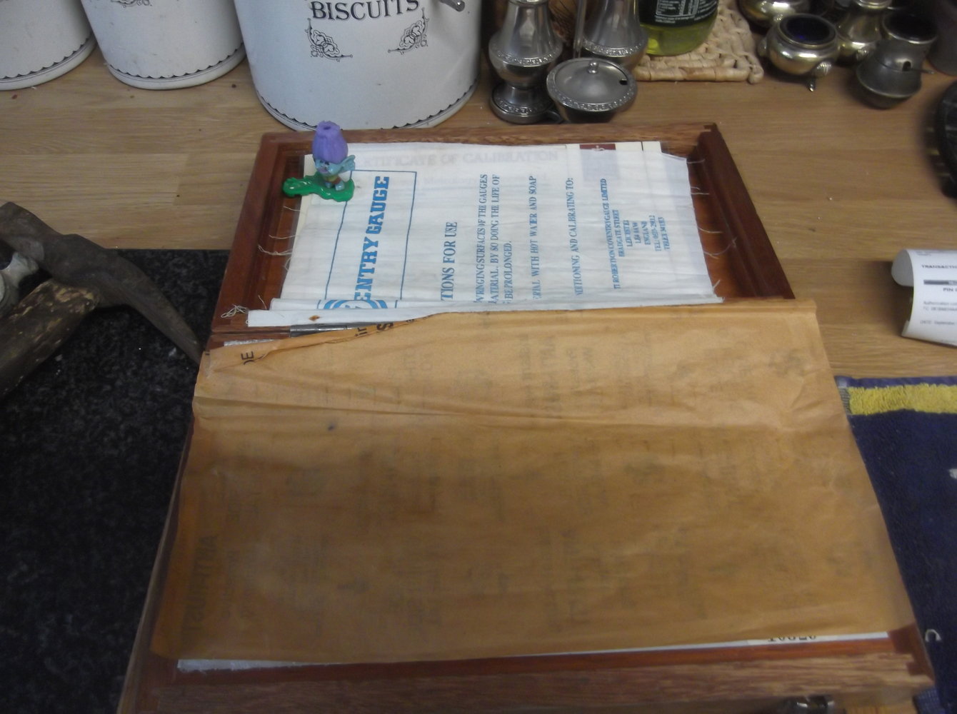

This did come with a box. The box was in poor condition when I got it. Walking back to the van in the rain killed it.
Oh well such is life.

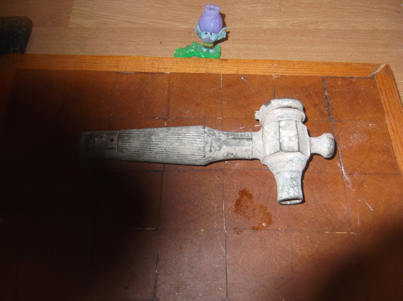

A Old and odd Keg tap.
Odd as it looks like it needs a key to operate it.

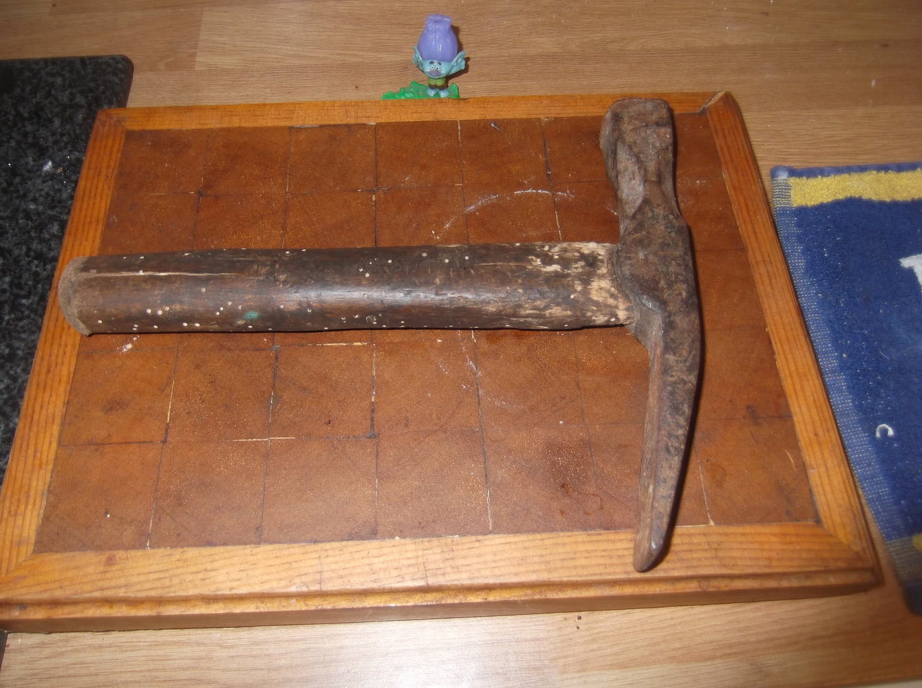

Oh a hammer as well.
Oh yes. A box.
Stonemason's hammer?
AKA brickies hammer.Stonemasons hammer?
