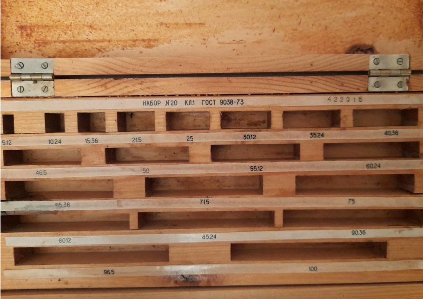

Carsten, strange sizing system on the gauge blocks, do you have any idea why they did them this way?

A set of gauge blocks (КМД set) is used to check, calibrate and set the size of such measuring instruments as a micrometer, indicator, sine ruler, etc. The sets are completed in such a way that from the minimum number of КМД it is possible to make a block of any size up to the third decimal place. Gage blocks are made of chromium steel with high quality processing of measuring surfaces and high lapping.@25.4_mechanic

Manufacturer website https://kirovinstrument.ru/%D0%BC%D0%B5%D1%80%D1%8B-%D0%B4%D0%BB%D0%B8%D0%BD%D1%8B-%D0 %BA%D0%BE%D0%BD%D1%86%D0%B5%D0%B2%D1%8B%D0%B5/%D0%BA%D0%BE%D0%BD%D1%86%D0% B5%D0%B2%D1%8B%D0%B5-%D0%BC%D0%B5%D1%80%D1%8B-%D0%B4%D0%BB%D0%B8%D0%BD%D1% 8B-%D1%81%D1%82%D0%B0%D0%BB%D1%8C%D0%BD%D1%8B%D0%B5/%D0%BD%D0%B0%D0%B1%D0% BE%D1%80-%D0%BA%D0%BE%D0%BD%D1%86%D0%B5%D0%B2%D1%8B%D1%85-%D0%BC%D0%B5%D1% 80-%D0%B4%D0%BB%D0%B8%D0%BD%D1%8B-%D1%81%D1%82%D0%B0%D0%BB%D1%8C%D0%BD%D1% 8B%D0%B5-20-%D0%BA%D0%BB-2-detail this set is worth today, in exchange rate terms, approximately $1,000 for Grade 2 (you have Accuracy Grade 1)Hi Rich,
I was wondering the same thing.
My first idea of an explanation was that you might save resources by measuring a block "close" to the target dimension and indicating the value - the user is also helped by this, he still knows the dimension he is looking for, even if it is "crooked", maybe this is even better in individual cases ....
I then discarded this idea when I saw that there is a system behind the decimal fractions:
5.12 + 5.12 = 10.24 + 5.12 = 15.36 + 5.12 =why 21.5? That's 15.36 + 6.12 ???
To be honest, I don't know - there seems to be a system behind it, but I don't quite understand the violations in the rows ...
Can I maybe get more intermediate measures this way when combining blocks? After all, up to two decimal places?!?!
Anyone?
But I think it's generally a good idea to force users to deal with fractions when measuring.
Especially learners ... since this set does not contain smallest measures, it could be intended for this purpose ....

Manufacturer website https://kirovinstrument.ru/%D0%BC%D0%B5%D1%80%D1%8B-%D0%B4%D0%BB%D0%B8%D0%BD%D1%8B-%D0 this set is worth today, in exchange rate terms, approximately $1,000 for Grade 2 (you have Accuracy Grade 1)
Mechanical measuring instruments, manufactured in the USSR and the GDR, of the appropriate accuracy class and condition, can be bought without expecting a catch. In addition to measuring and calibration rulers and cast iron plates (checking flatness, straightness), they will definitely require editing. My measuring blocks are stored somewhere in Germany and are waiting for me. There are many more.
I better take good care of them then ...
In the box it is written:
"Set # 20, Class 1, Standard 9038-73".
State standard (GOST) # 9038, drawn up in 1973 - not necessarily introduced, that may have happened later.
All gauge blocks in the USSR and also now in Russia are made/judged according to this standard, last revision 1990 -> GOST 9038-90.

On the manufacturer's website, there is no word about using the kit and others. The Soviet style was preserved 30 years later (woof-woof, a step to the side - equates to an attempt to escape = shooting on the spot; jumping on the spot - is considered a provocation to escape). I translated information from another source.@25.4_mechanic yes I did the same calcs as you and couldn't figure it out, but there is a repeat through the range.
Maybe they are for setting micrometers as the blocks give a good range through 0-25, 25-50, 50-75 etc
@Sergei Slovenija Thanks I tried Google translate on the website but couldn't find what set 20 were actually for.
