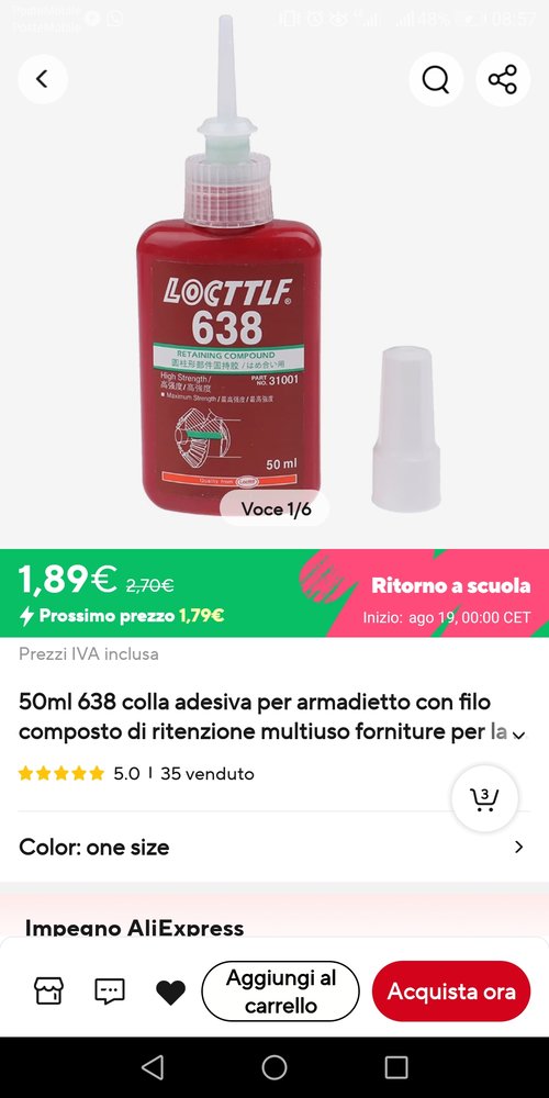

Please update us with a review.I was looking here and there for helicoil sets .
Found interesting things on temu but once in the cart price rised up so I went back to trusty AliExpress searched for Loclifl , discovered an entire world of Loctite knock off .
Now 243 is 30 or 40 euros over here where I live and I'm already using cheaper alternatives.
And ain't going to finish the 50ml bottle too soon (bought 3 or 4 years ago) I've used about half of it considering I've left the thing on a side and lost a bunch of product .
Anyway I wanted to try them out and bought a bunch of them.
Bearings locker, all the fake Loctite I've bought have this on off nozzle under the cap which hopefully will avoid to make a mess if I inadvertently tip them over.View attachment 461113
And the entire selection of thread lockers this specific brand sells
So 222,242,243,263,271,272,290 faketite

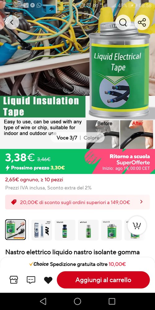

Liquid insulation tape just because I think might be useful.
I can't wait to try those out and see if they are worth something.
Anyways I've spent less than buying one single bottle of Loctite
I'll certainly do.Please update us with a review.

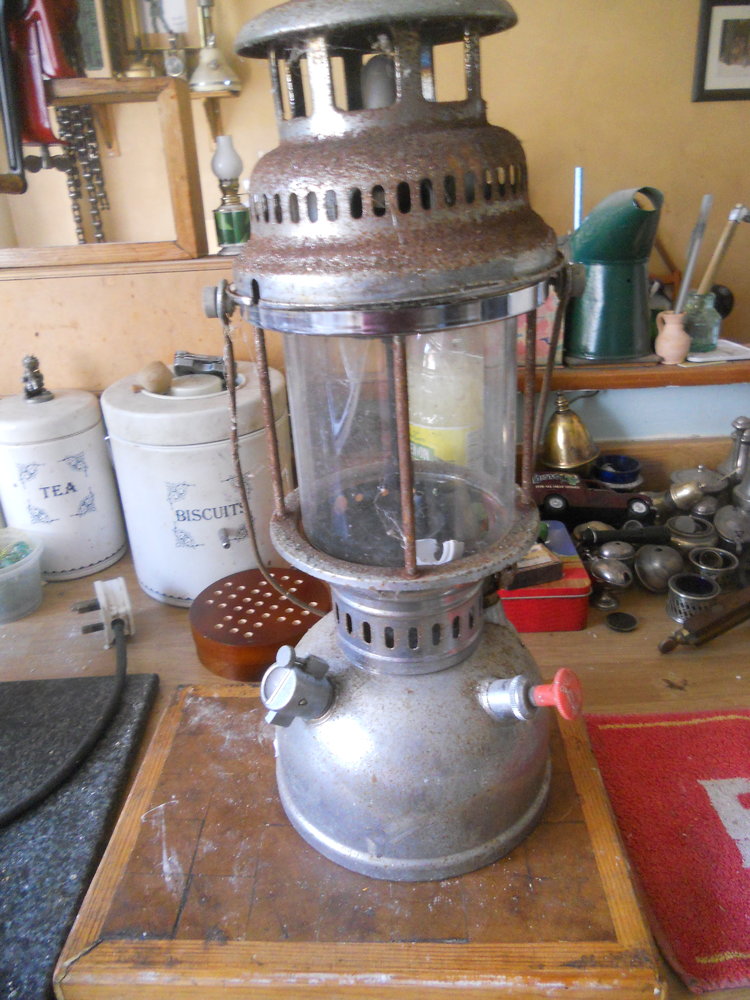

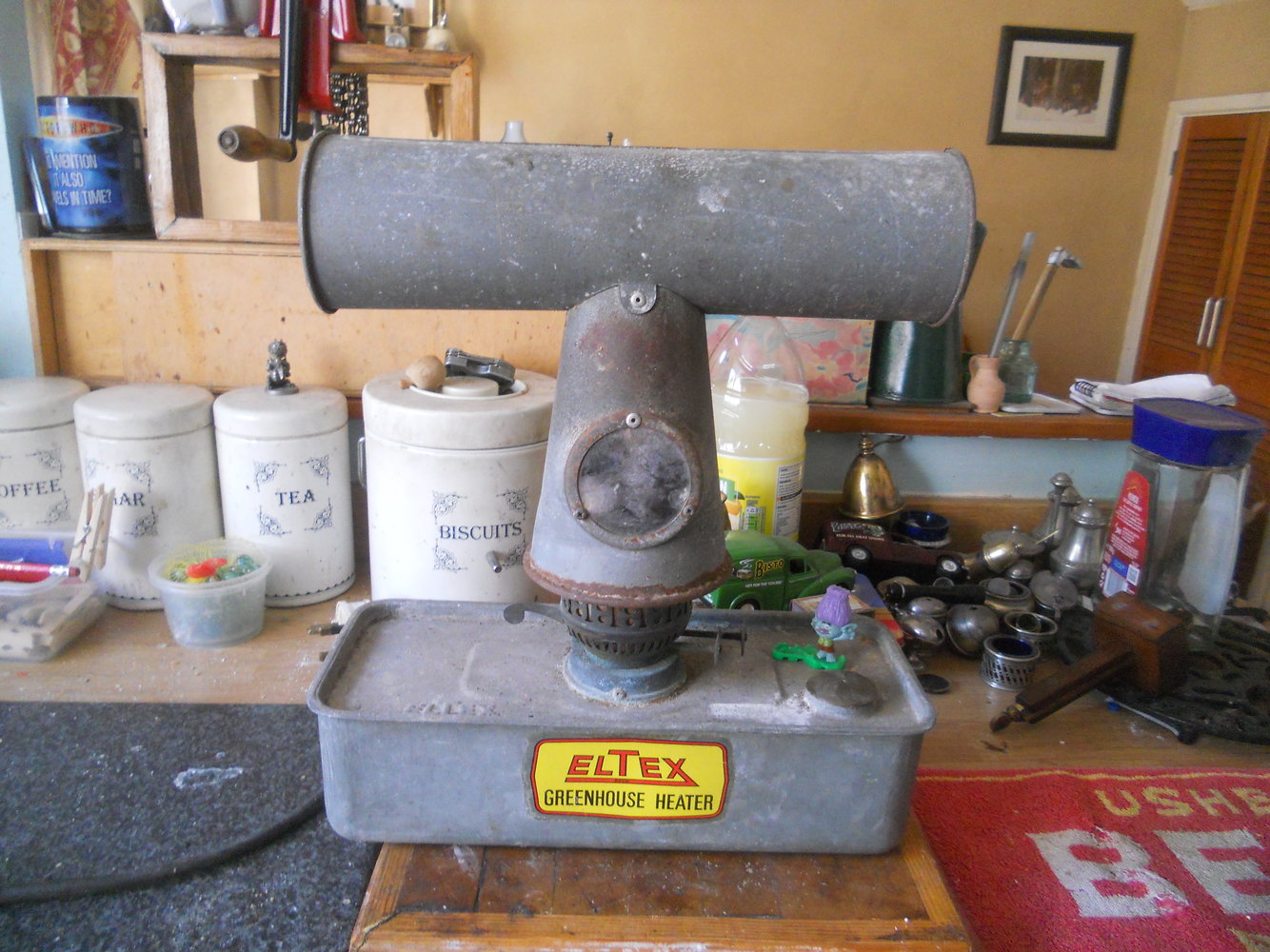

I have a greenhouse heater top same as one in pic. Wondered what it was off, any way it's going.A few things.
Plus.........

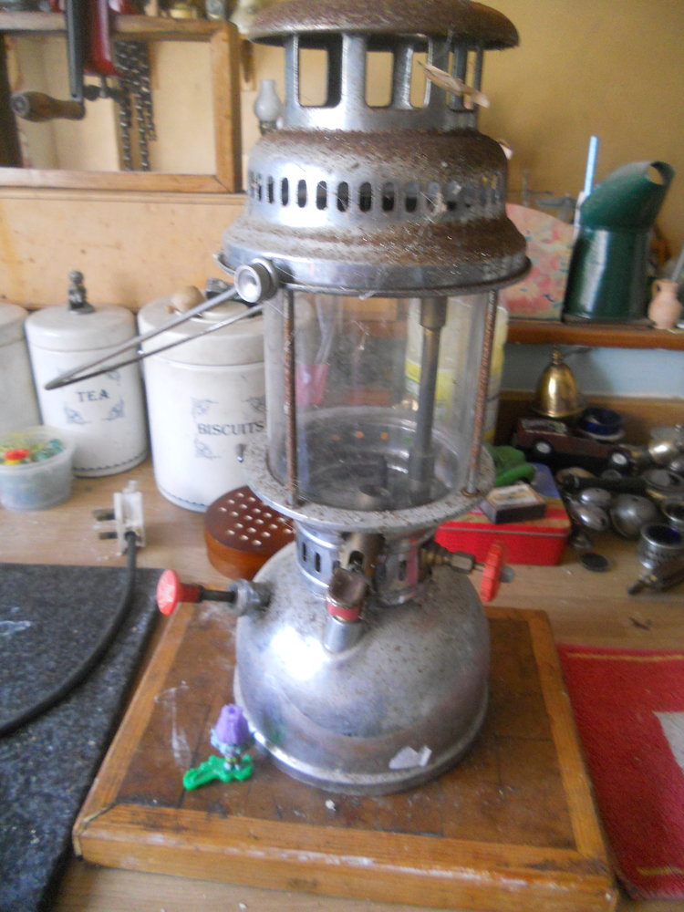

The contents of the Box.
Green house heater,.

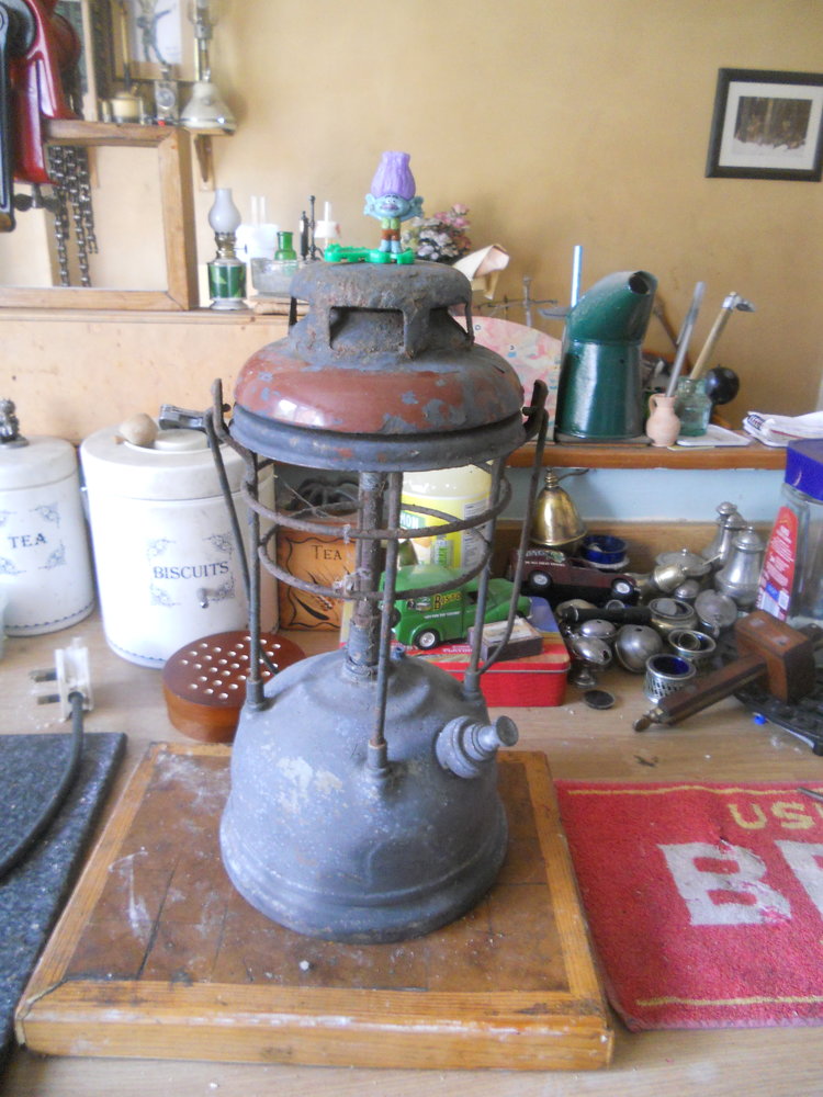

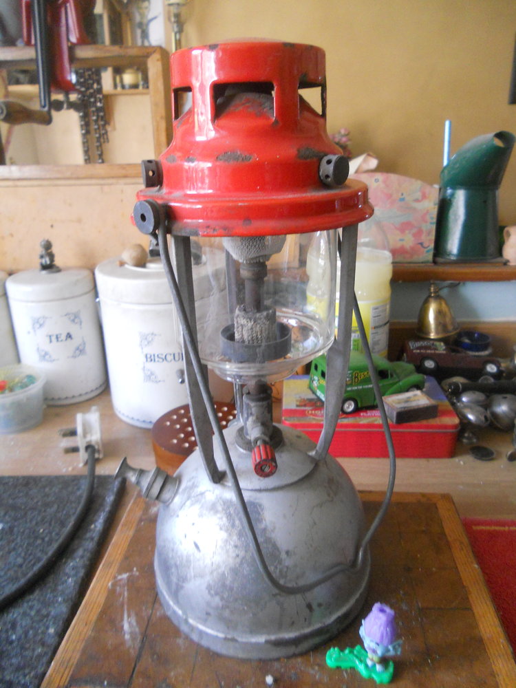

2 Butterfly Pressure Lanterns.
A Vapalux Lantern.
I just junked a base as it was more holes than metalI have a greenhouse heater top same as one in pic. Wondered what it was off, any way it's going.
