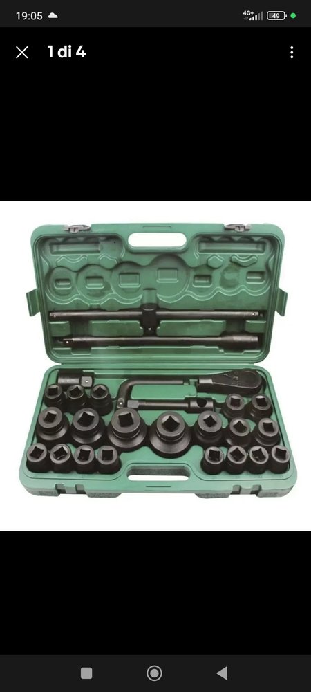

I have been offered a KS Tools 3/4"sockets set for 70 euros+ shipping.View attachment 473465
Thought about this would take longer but 3/4" is on the way home
They say 3300Nm which is more than the onevan equivalent at 3100 but if it has 1800Nm it would be more than adequate for me.
Now a torque multiplier and big sockets set and all my Bolt unbolting needs are satisfied

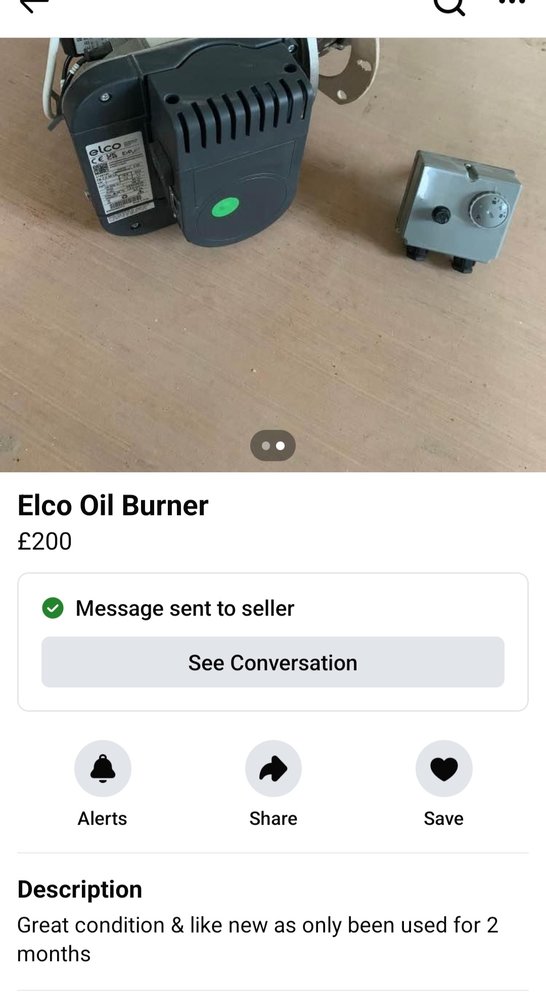

My oil boiler is not firing. Motor and pump hot and trying to fire constantly for a few seconds.
I think the motor or pump may be faulty.
I bought a good used burner identical for it:
Plan is to get me going later with this replacement and repair my original one too. Having good working parts to test will be useful for sure. And if I get both serviced and working perfectly + set then I'll always have a spare to swap out. 10 minute job to swap out. One fuel hose and an electrical plug.
