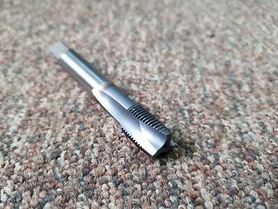

Form taps give a better thread, I would like to get form taps for M4,M5 and M6.
I need a spark plug adaptor so I have ordered one of these, slight use OSG taps.
M14 OSG Machine Tap 14mm x 1.25mm 3 Flutes TiCN Coated Offer | eBay UK
X1 OSG M14 Machine Tap. TiCN Coated.www.ebay.co.uk
It appears they have 5 or so listings, and have sold a thousand + of these taps, all with good feedback. I can only assume a car manufacturer must be getting a new one out for every engine?
What else is m14 1.25, used for?

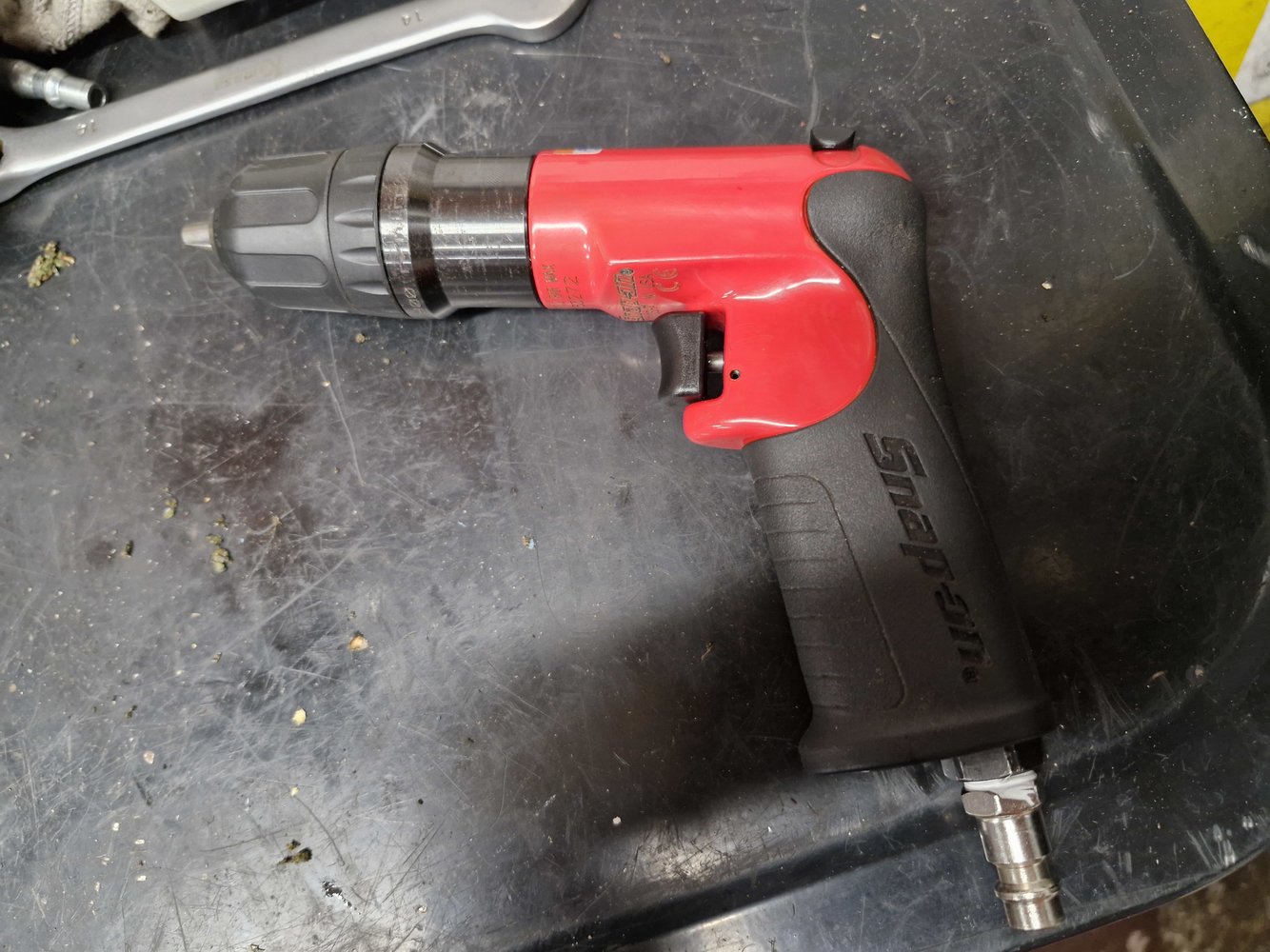

Well what is that?I keep forgetting to post when I get hold of a 'new' toy.
I'll make a resolution to catch up.

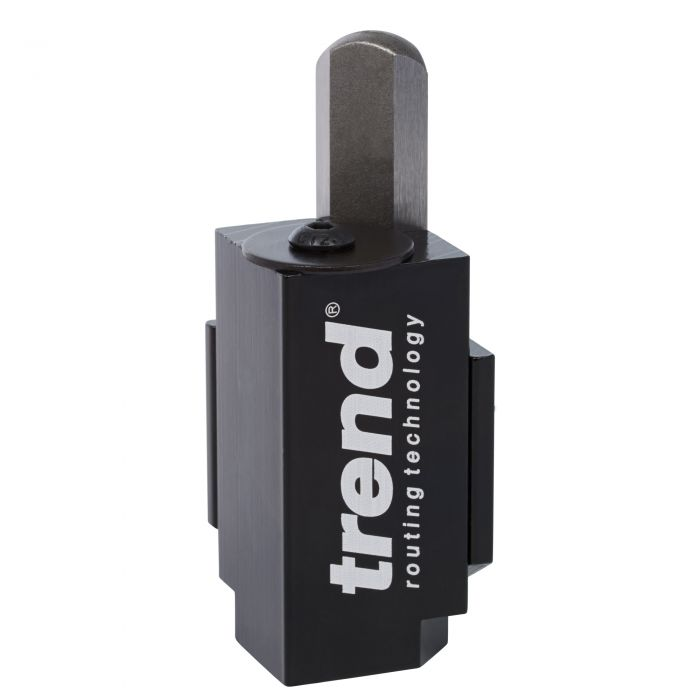

Latest was this, only bought it because it was only £10 via Amazon, and it is a Tend. Sorry, didn't give you a heads-up, and it's for wood too.
Well what is that?
