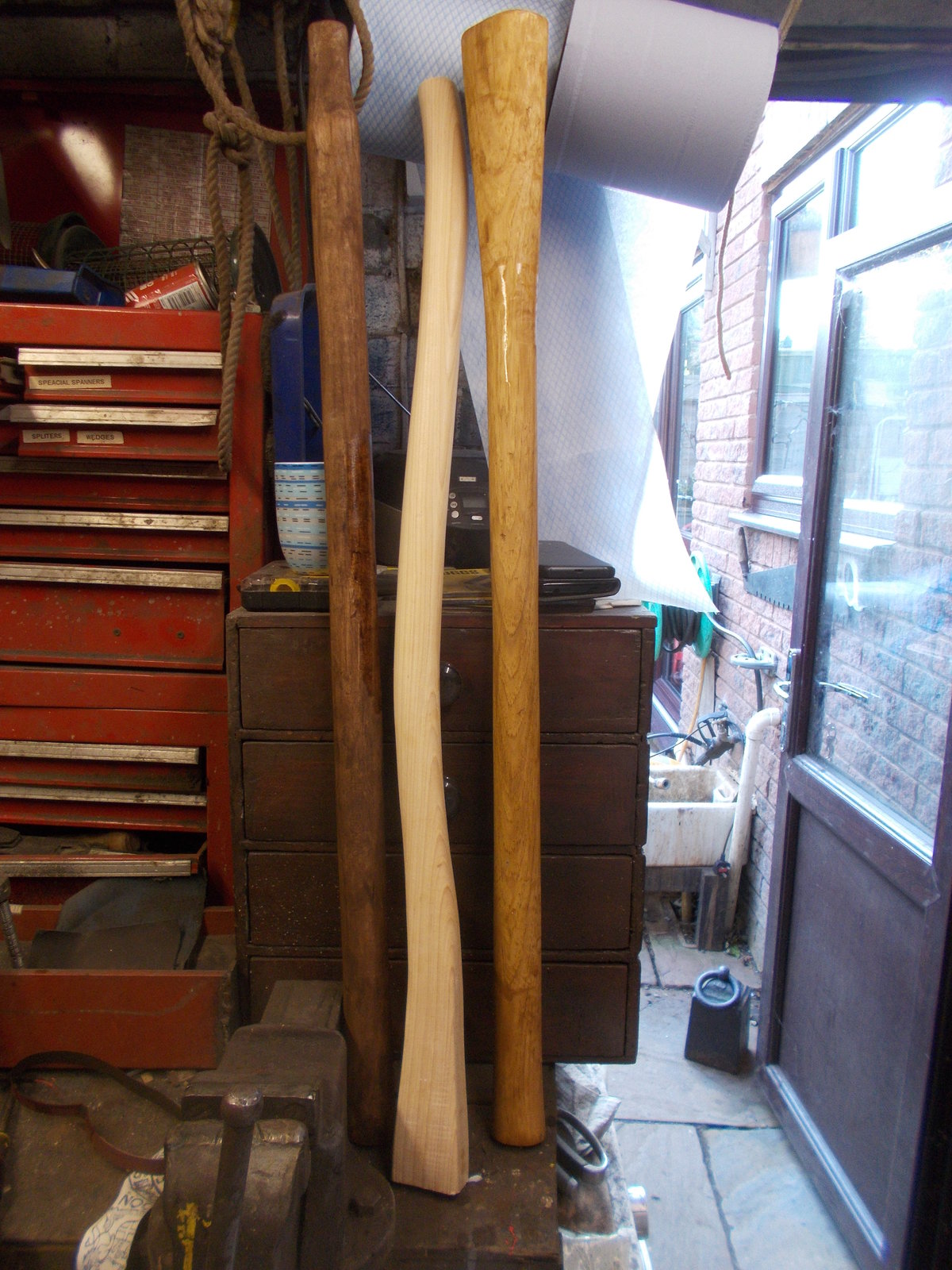

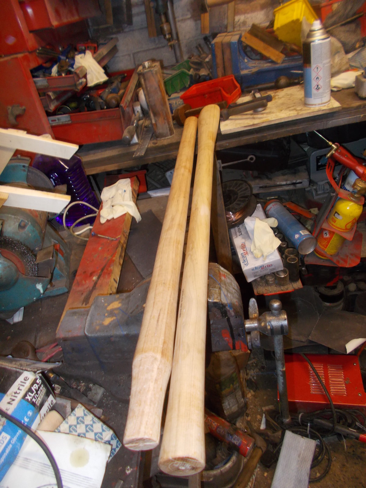

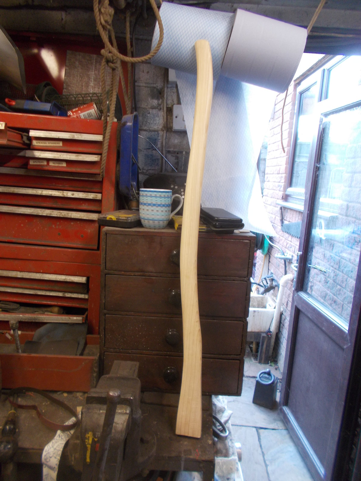

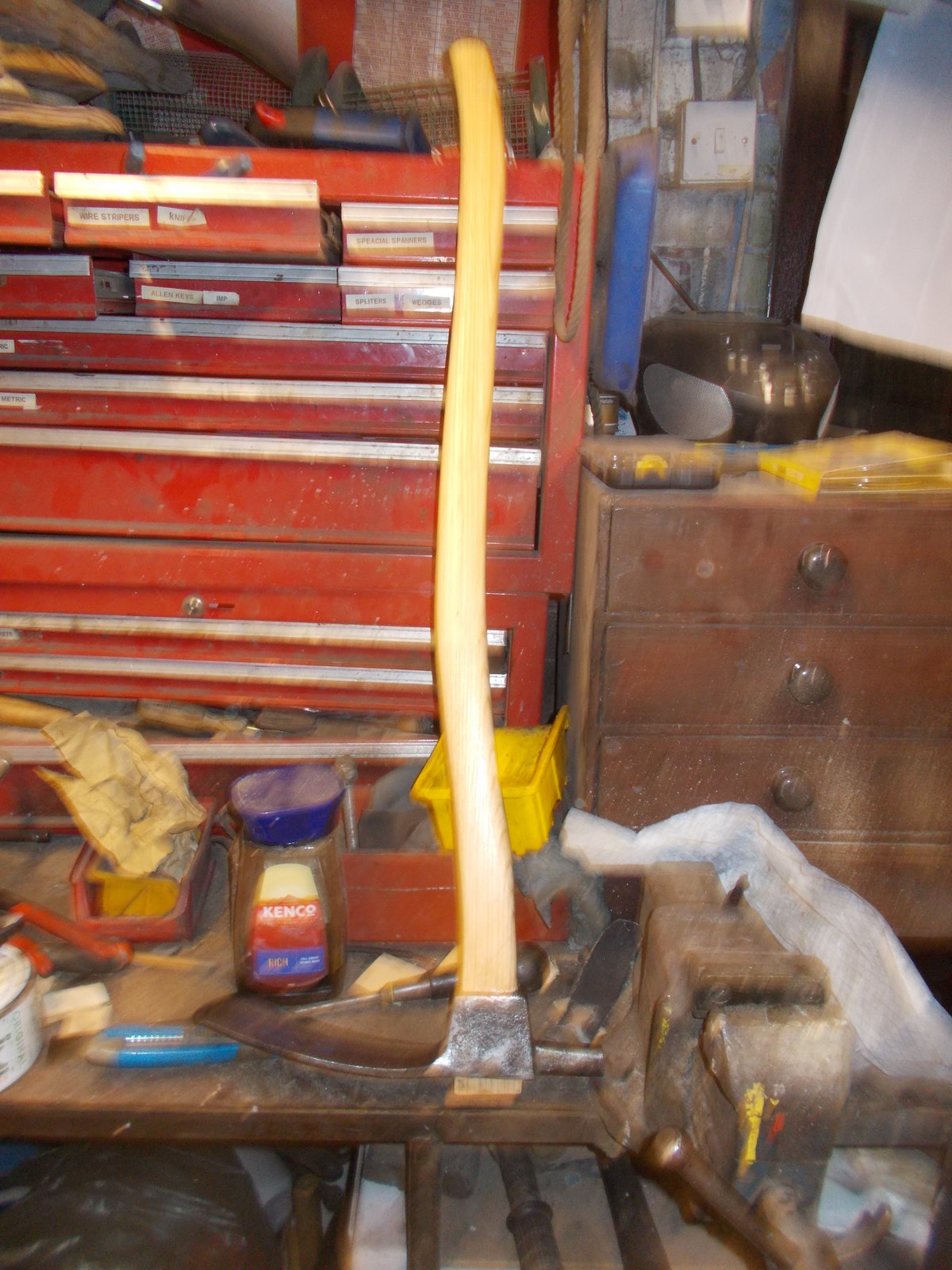

The Adze.
From the de-rusting tank, after being left in paint stripper to remove some varnish junk.
The Hammer end was dressed and re shaped. It didn't need much, just a bit burr removed.
The working end, what a ducking mess.
I had to grind it back, re-shape and re-grind the edge.
I then heated to red heat, quenched in old oil. The cleaned it back to allow me to see the colour move as I tempered the end to dark blue.
That Image is after I quenched it after tempering.
The Name and details highlighted in blue tinted bee's wax. The Head now is temporary finished in clear lacquer, until I sort the shaft out.
Oh yes. I have sharpened the cutting edge to be able to removes hairs on my arm.

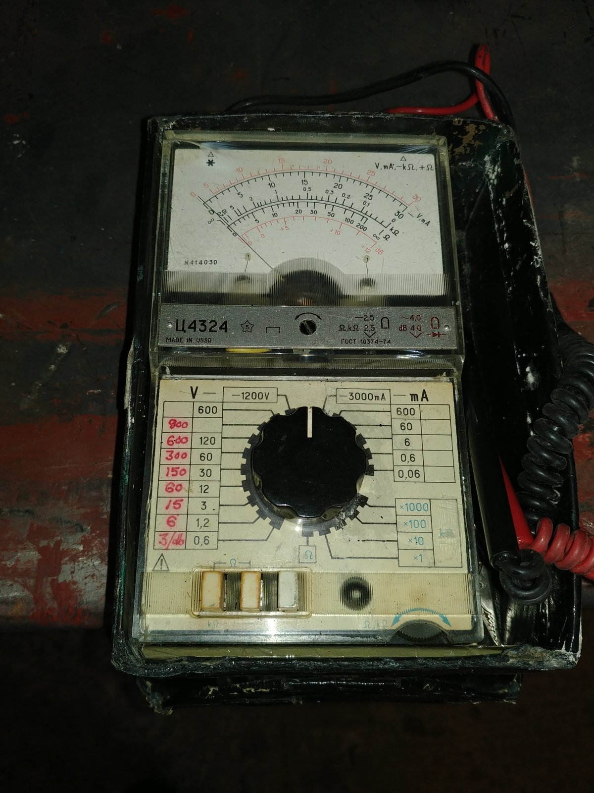

Old Russian electrical stuff is weird, I had a radio, and to change from VHF, SW ect you rotated a big knob on the side and the whole PCB inside spun round to different contacts !
Looked like the Flintstones designed it.
