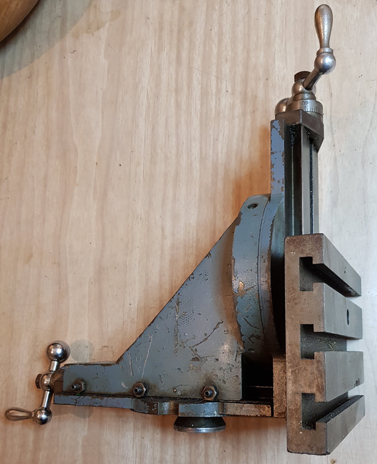

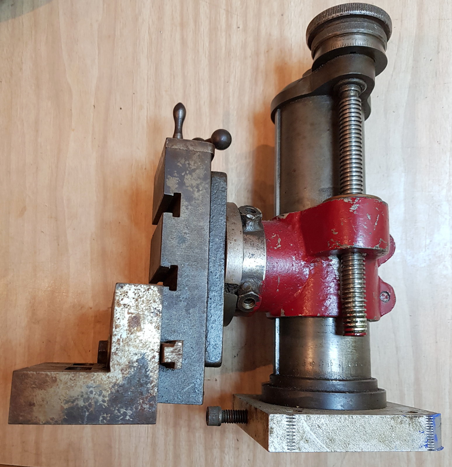

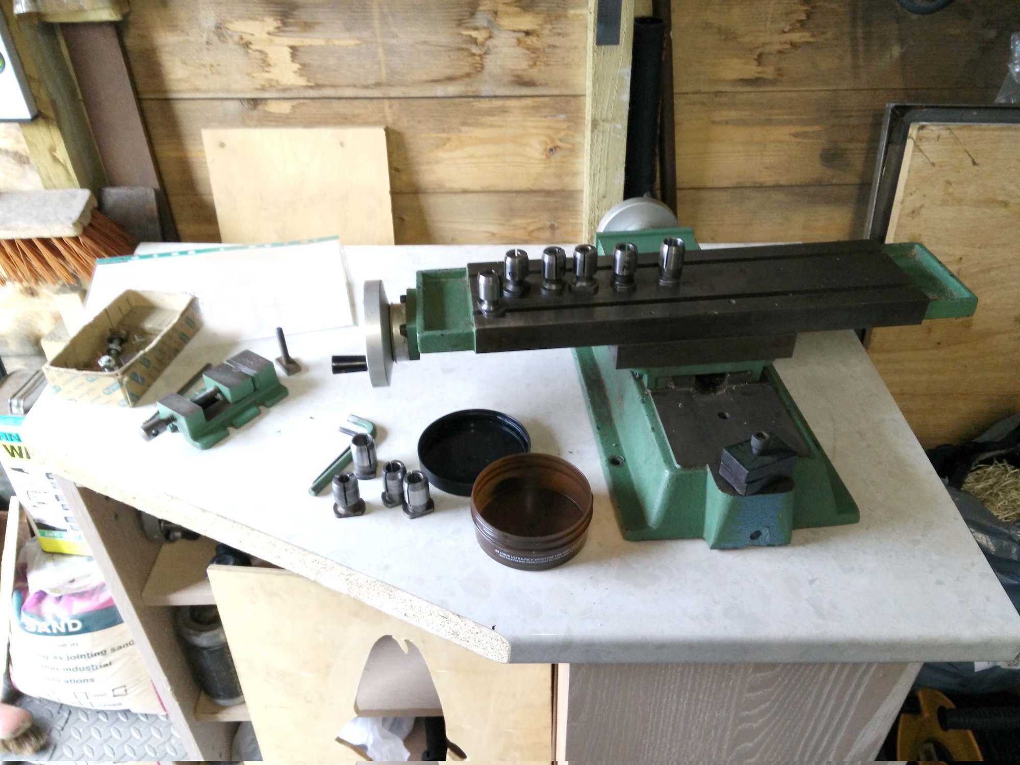

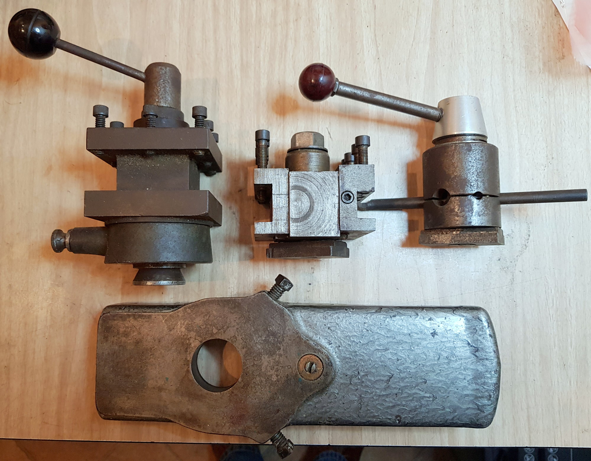

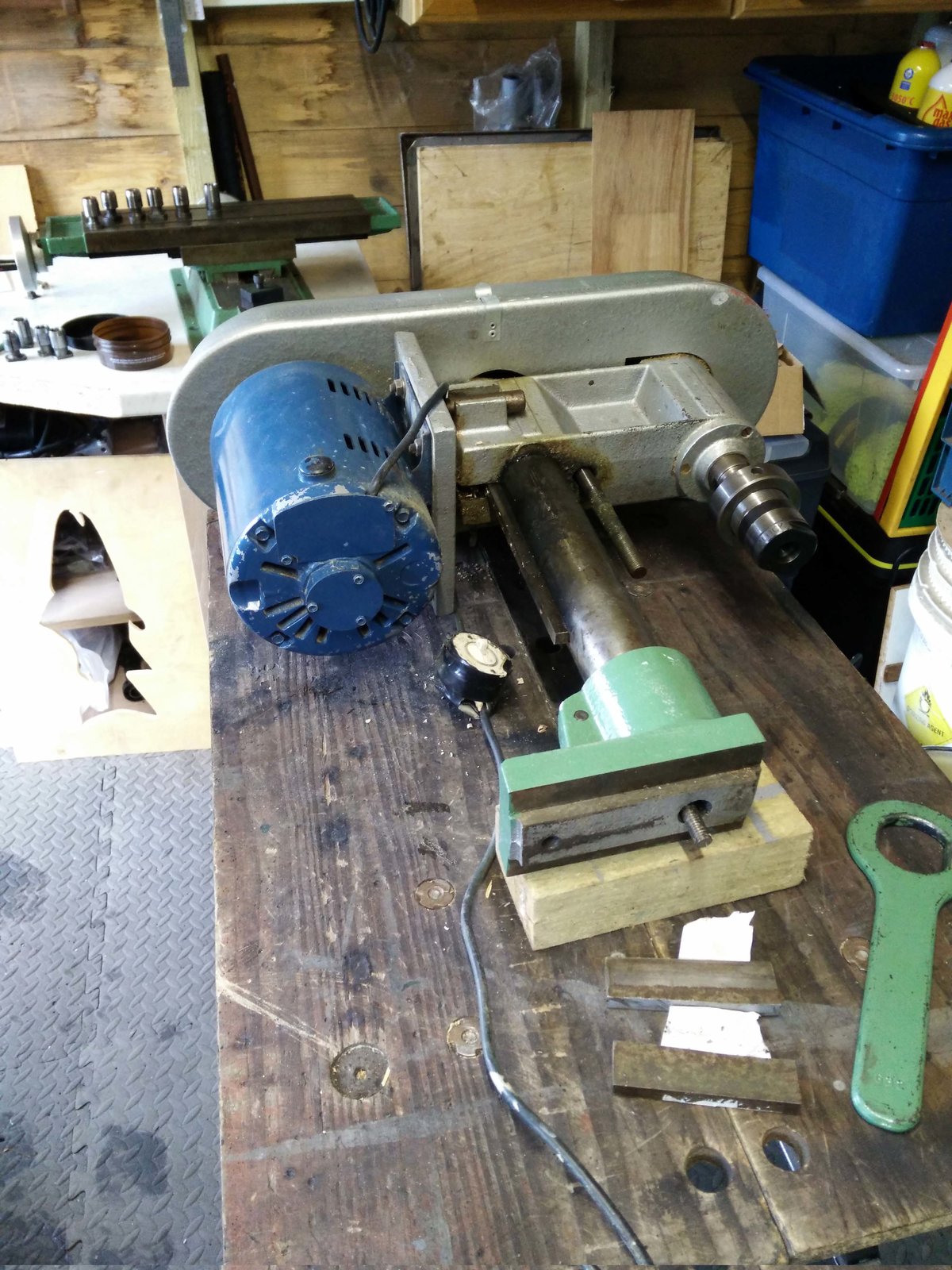

A lovely little machine . Nice one.Today [well, last night] my Amolco mill arrived, thanks to @spencer 427 and @fizzy for all their help in getting it to me.
Just 'de-crated' it yesterday and spent a little time today seeing what's what. I've decided to give it a good clean, rewire the motor [enlarge the pic to see why, but I want an NVR on it anyway ] and fit a new drive belt while I'm at it. I've no way of knowing the condition/age and for all they cost it's as well done now.
I won't be going to the lengths I did with the Myford, but I've waited long enough for one that a little longer won't harm. Once it's together and in place I'll not be able to move it easily......
I also want to find out about the Clarkson Autolock chuck and collets, as I've never seen one before.
Anyway, a couple of snaps of where I'm at
