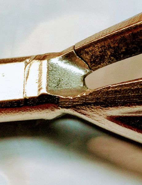

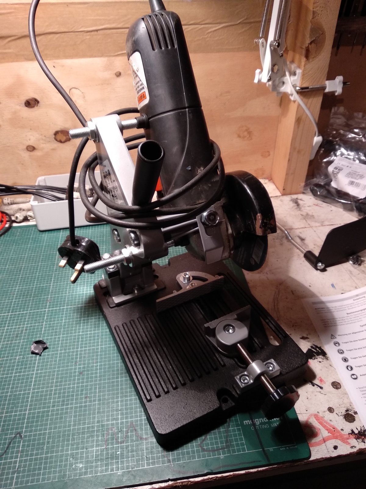

Bought one of those external deburring tools.
Didn't expect it to be good but at 4£ delivered to my door I just had to try one.
Well, it arrived cracked. About 30sec later it was refunded and I didn't need to return neither.
Welded the crack and was surprised that it actually worked quite well.
Not as fast and effective as in the commercials but good enough on mild steel tubes. Faster than a file and more even than flap disc.
Deburred about 40 pcs of 20mm pipes and still sharp.
