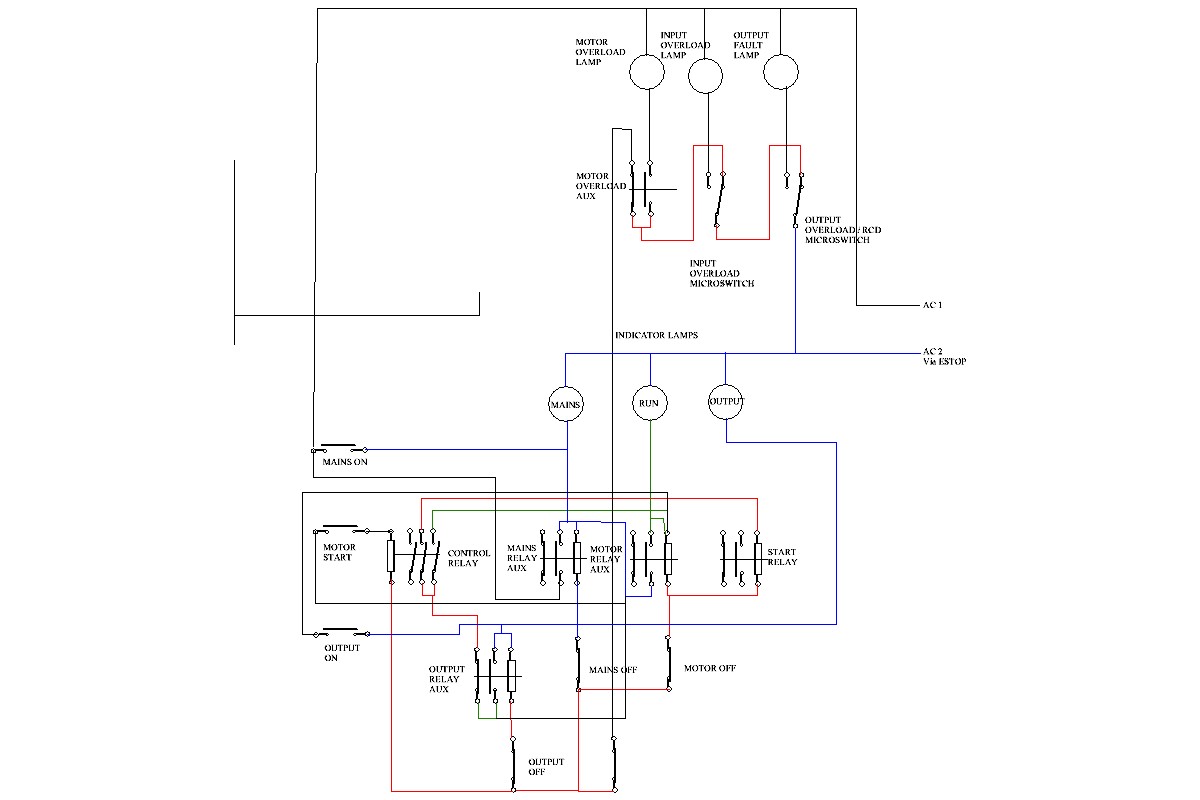

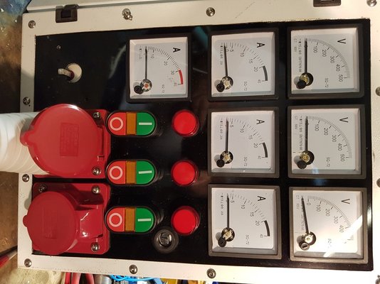

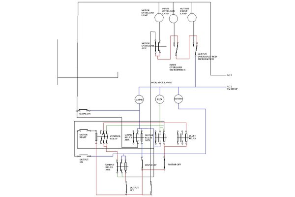

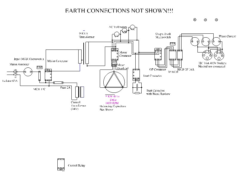

I've got a 15hp rotary in bits at the moment I might build another one to sell if I get 5mins

Pictures, circuit diagram, etc, etc.I've got a 15hp rotary in bits at the moment I might build another one to sell if I get 5mins

I will post some pics and a diagram when I put it back together I got it in a box that some farmer had been playing with badly I rigged it temp on the floor and go it to prodice powerPictures, circuit diagram, etc, etc.

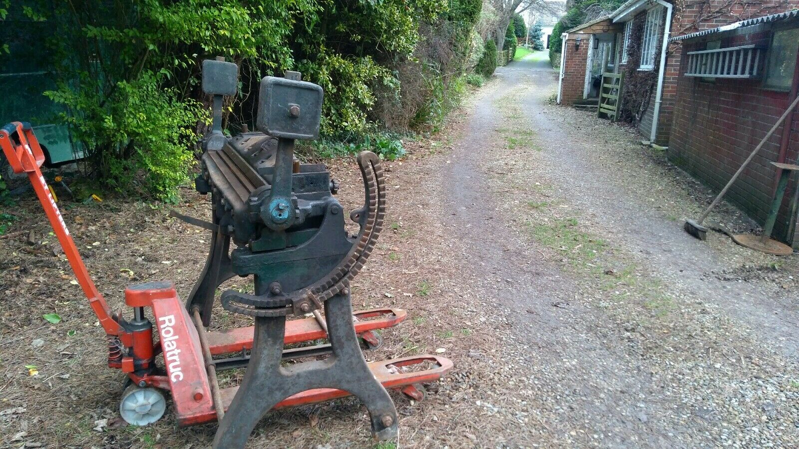

That's a cool bit of kitA very very old sheet metal bender.
Bloke managed to get it on a pallet for me. Arrived today safe and sound but too dark to see it properly. Looks like it will need quite a bit of fettling
I don't know what that circular ratchet is for - not connected to anything.
Here it is before palletising.View attachment 207882

No it's a Barhope. Very old possibly ww1 vintage.very jealous. Is that FJEdwards?
the semicircle is an angle stop.

I’d give that a very light clean up and wipe over with oily rag.
Place in front room and admire every day
