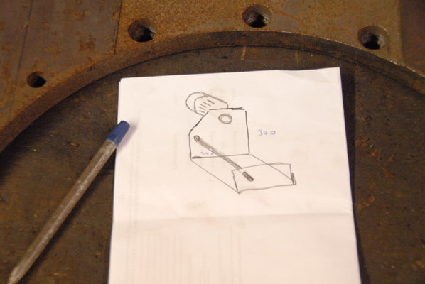

Thought I would make a first post on the Tool and cutter grinder build. As I cannot afford a Clarkson tool and cutter grinder I have been eyeing up this type
but wow they make lots of money for what is basically a grinder, with more accuracy.
This is the base idea I am hoping to put together,
once I have this part sorted I will then sort out the swively parts, as per normal there is no planning apart from a bit of a sketch while having a cuppa.

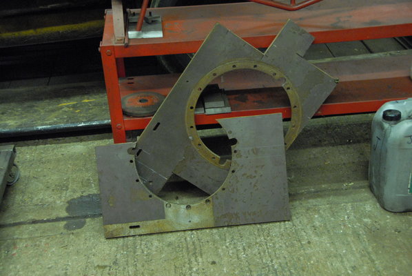

Father had to got near the scrap recycling yard today so I went with him and manage to grab some steal plate the straightest I could find was some 20mm thick plate,
will need a bit of chopping about to get the size and shape I have in mind. I also picked up some round bar but it only 22mm and I have got the boring bar stuff
although its a bit thick and to wasteful to turn it down to about 25mm.
I did find an old motor that is face fitting but it is only 1605rpm,
will this be a bit slow or do you think it will do, The ones I have seen on the net are 3000rpm and up. I am hoping to fix the grind wheel directly to the shaft so will be direct drive as I don't think I will have space for pulleys and belts
Jord
