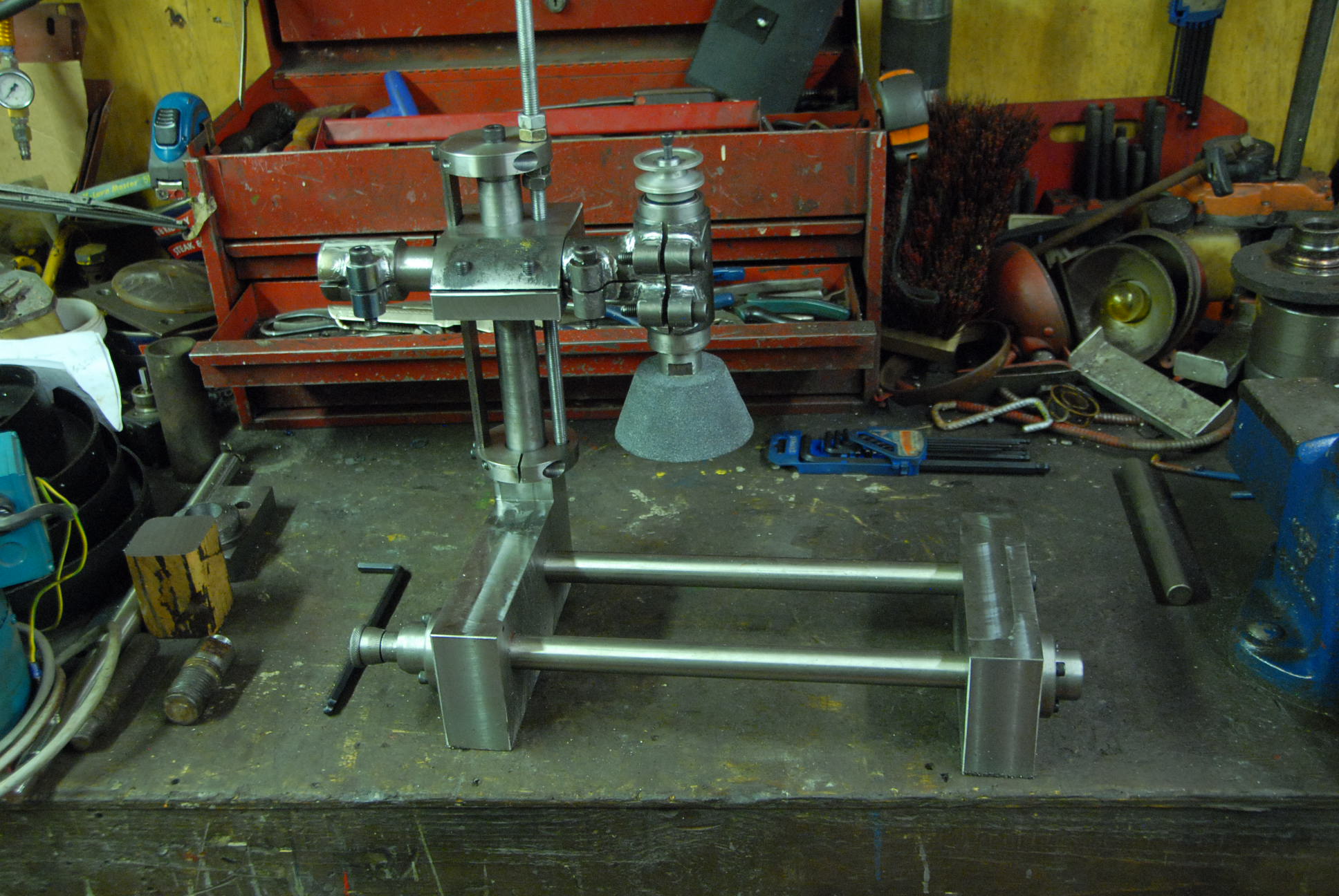

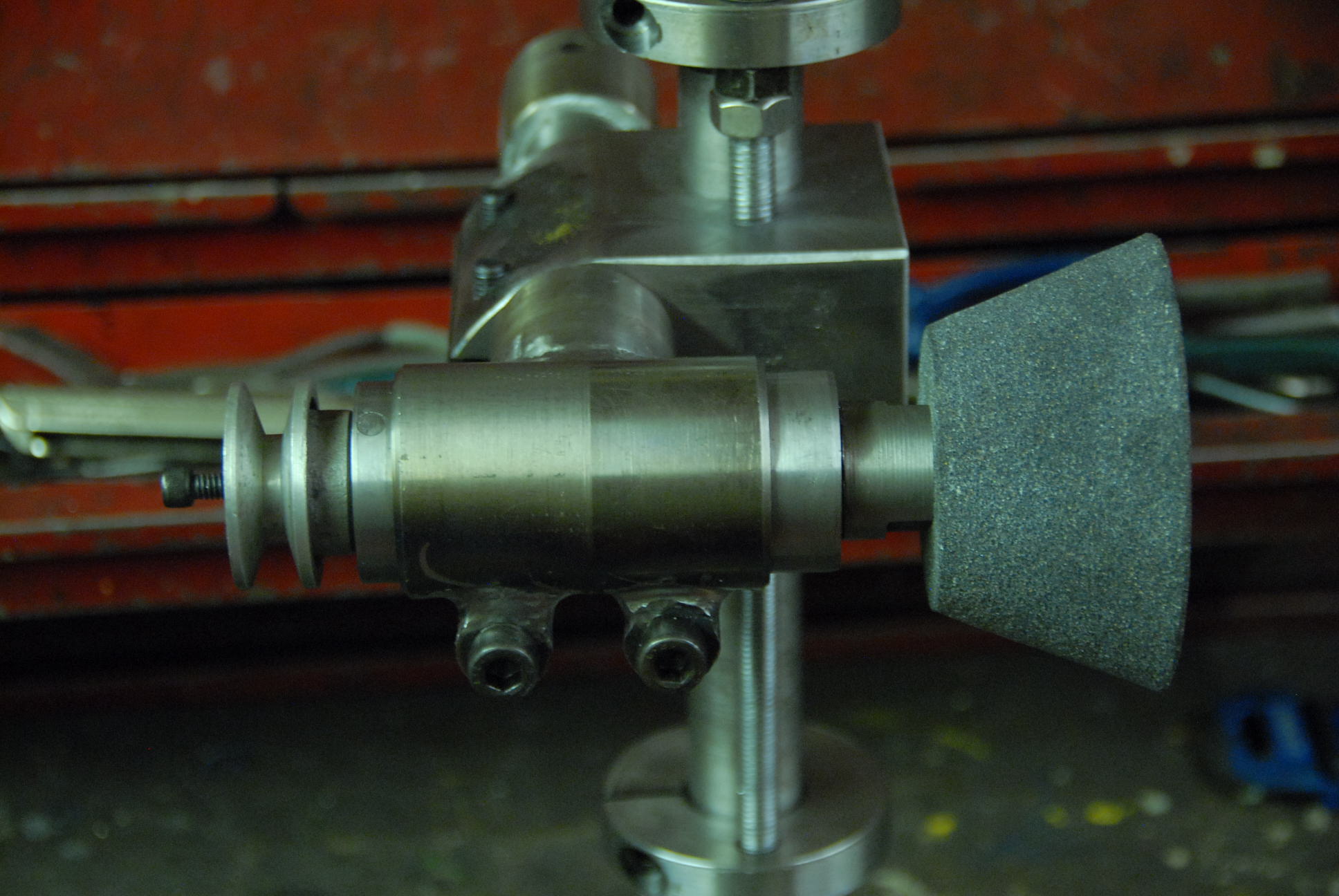

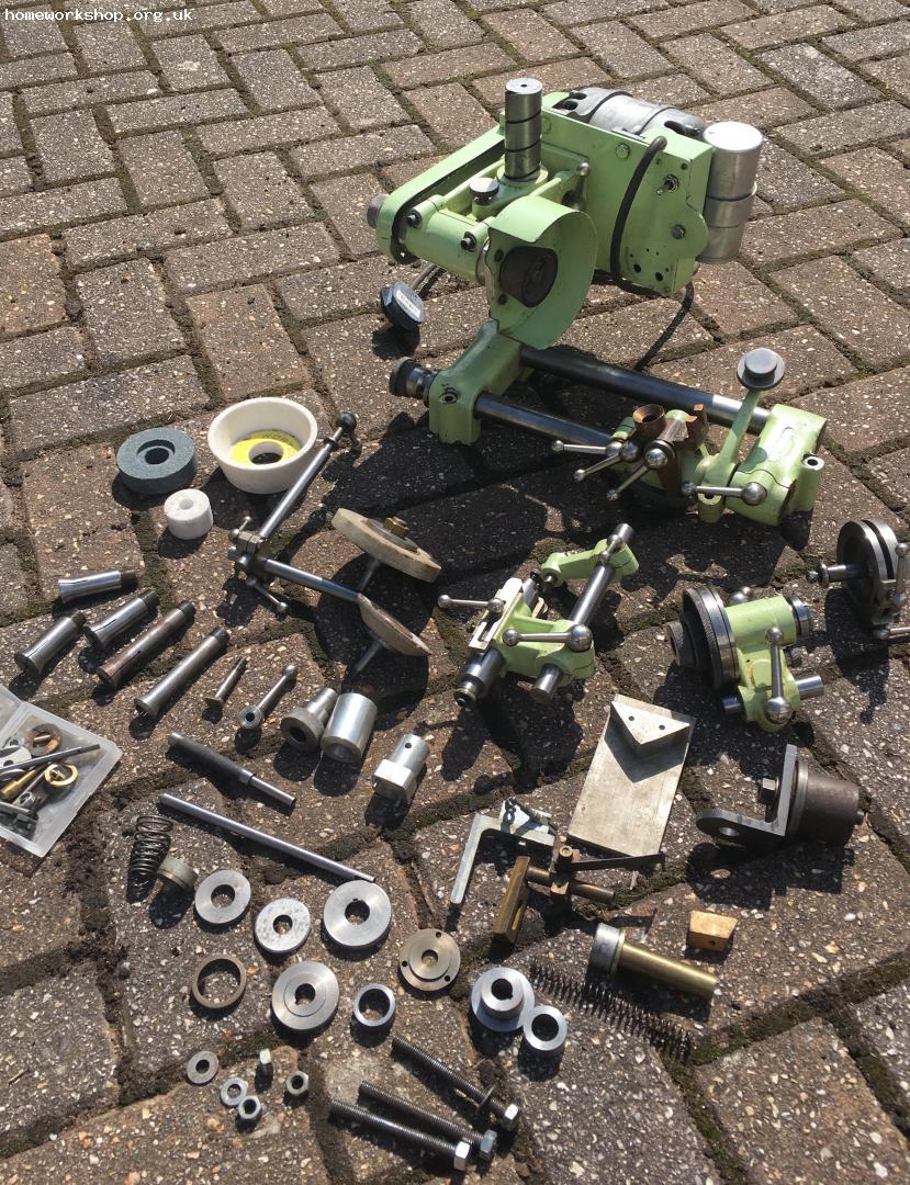

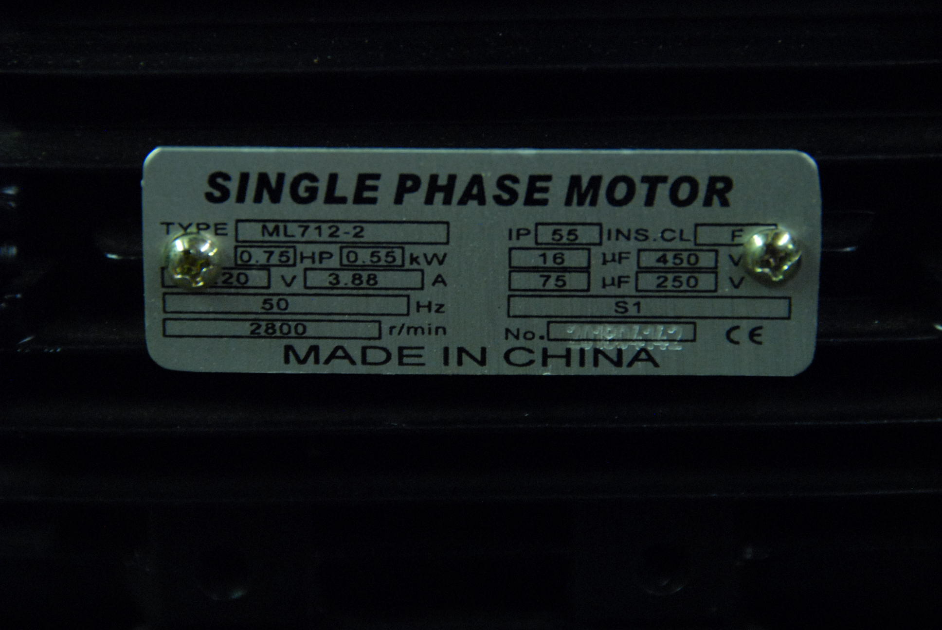

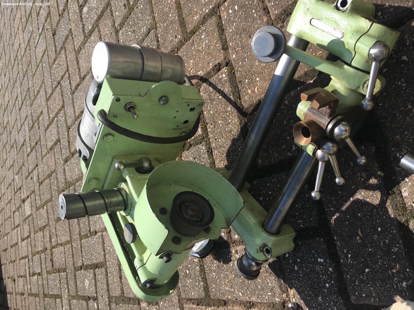

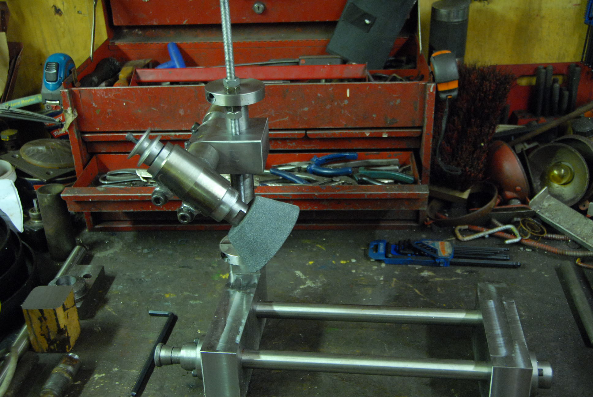

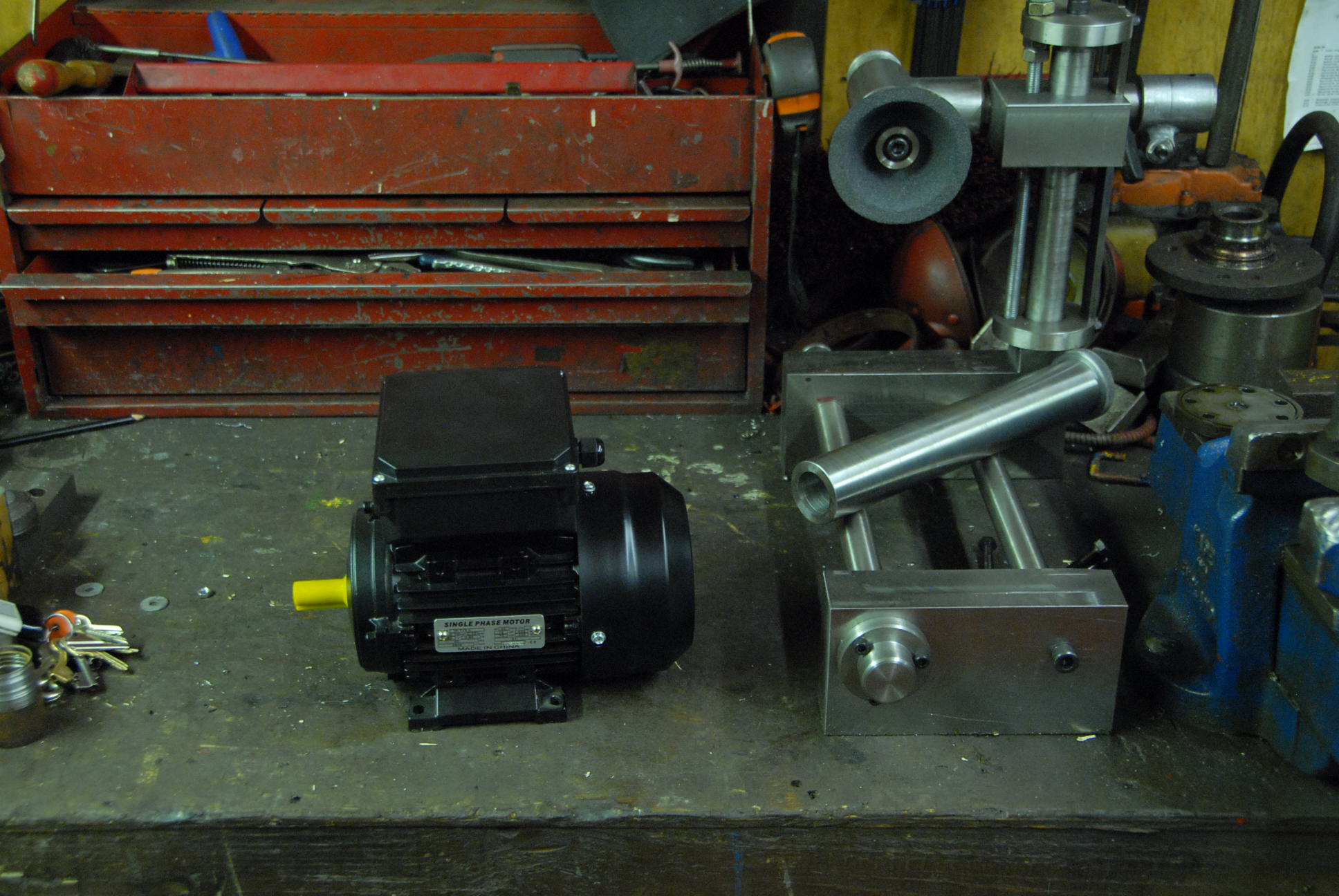

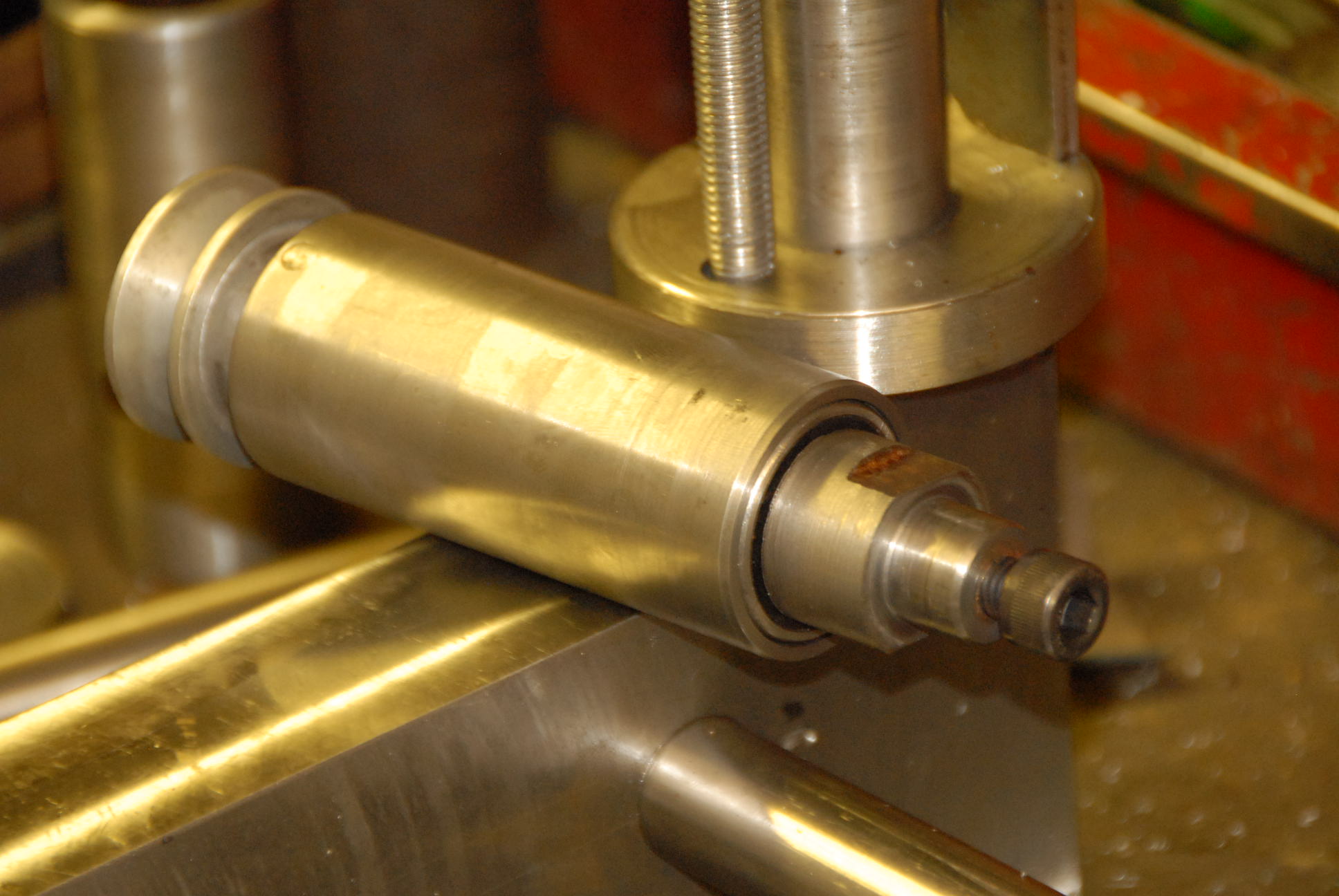

Looking for some advice not done much this week on the build, so today Ive been thinking ahead about motors, I do have a 3 phase motor but thinking I could bring the cutter home and do some sharpening in the evenings, I am looking to go single phase. I am am not to knowledgeable on electric motors but I have found this one on the auction site,
https://www.ebay.co.uk/itm/Single-P...ole-2800-rpm-HP/173988220100?var=472777767326
It is only 0-37kw but has the speed I am looking for, and from what I have found the frame size dont look to big.
Question is would 0-37kw be enough power for my needs ie, I dont want it under powered
Cheers in advance
Jord
That's twice the motor in a Deckel/clone tool grinder, should be plenty? Expecting to take off more than half a cubic inch per minute?
Dave H. (the other one)

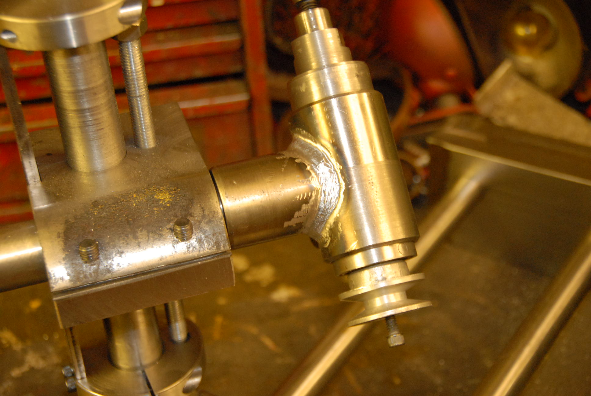

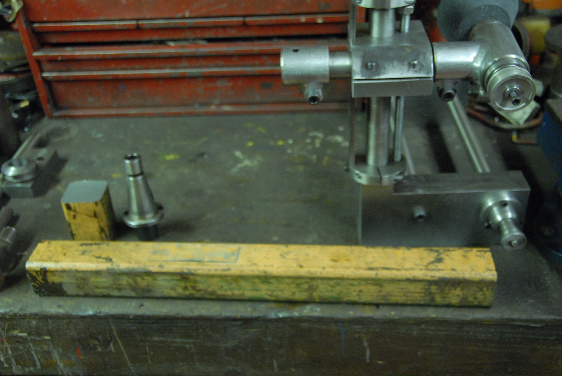

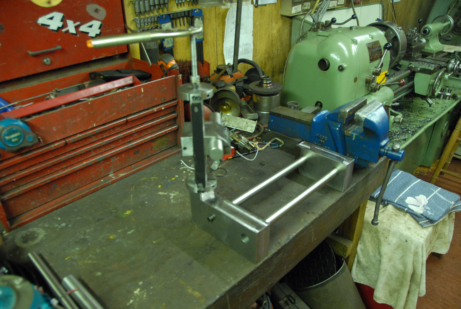

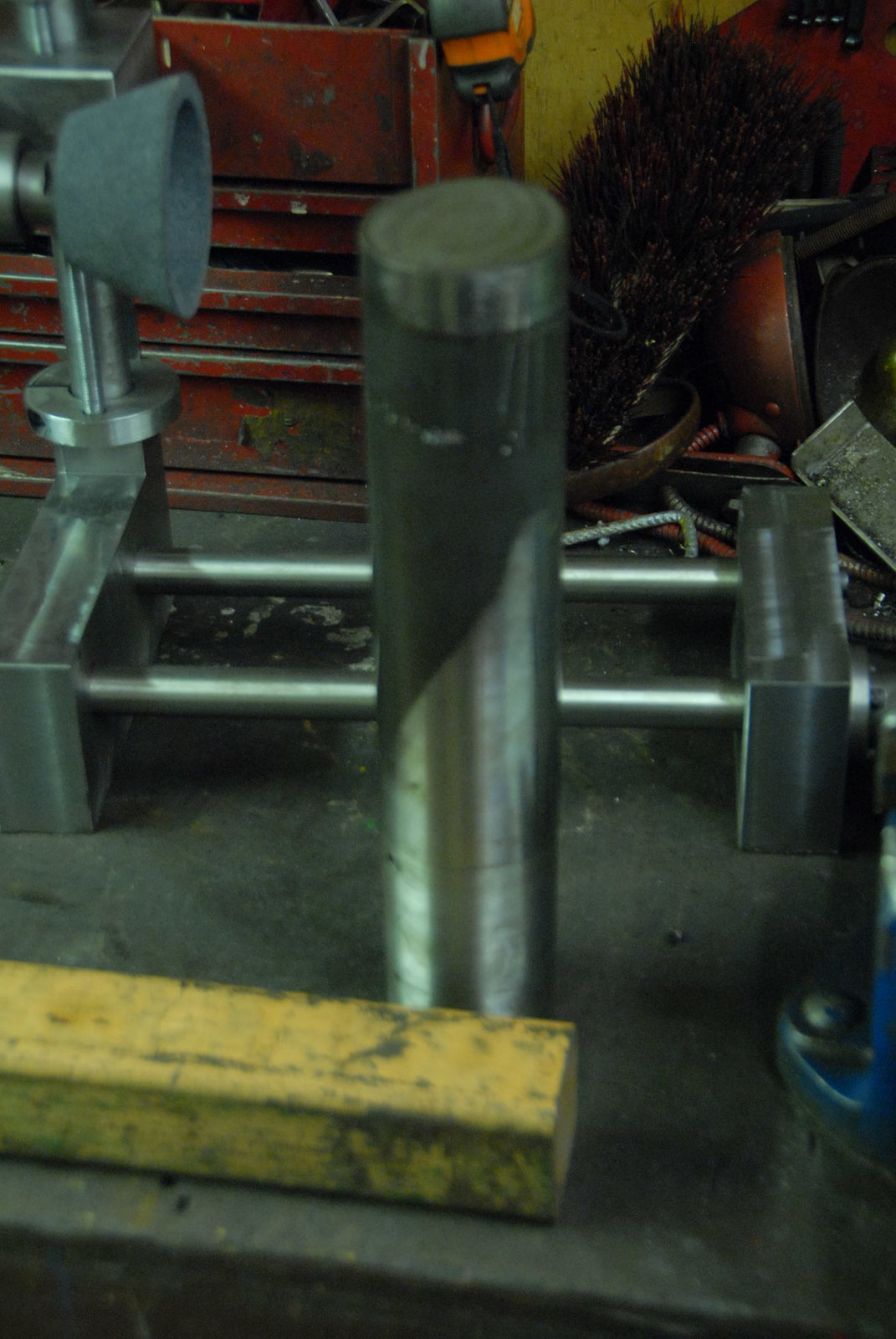

I would rather have a flat pulley or poly v pulley on the grinding head than a v pulley for smoother running.

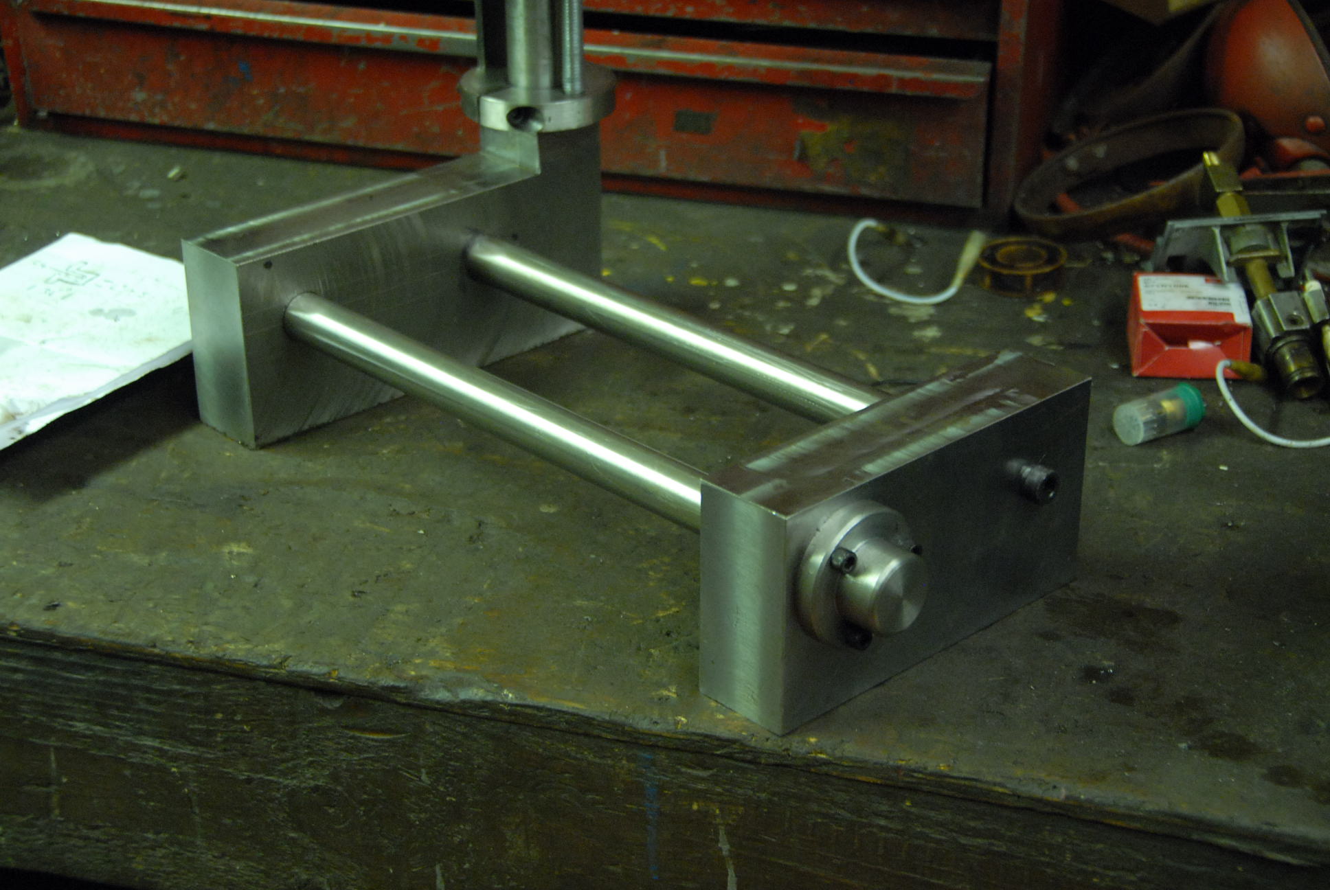

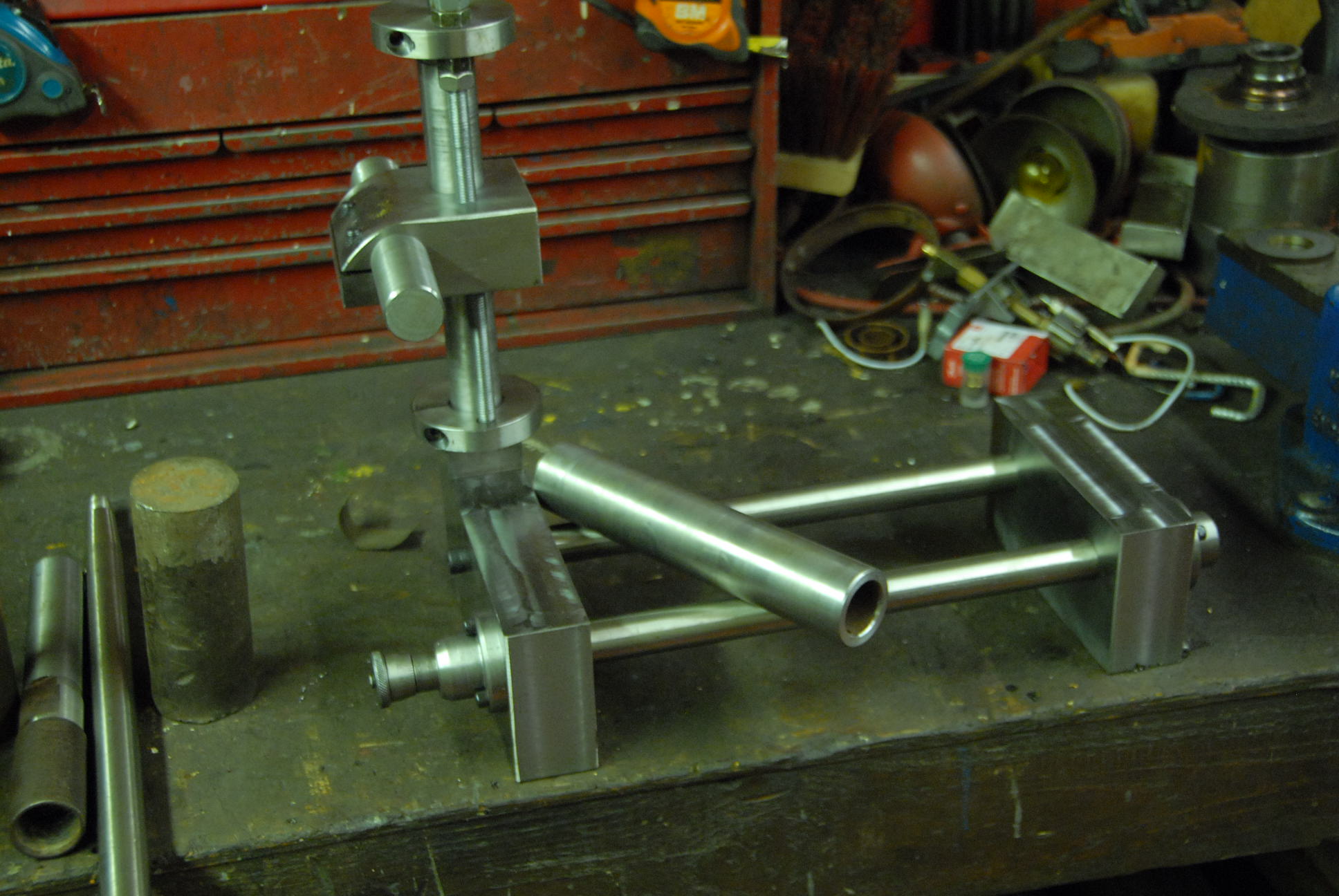

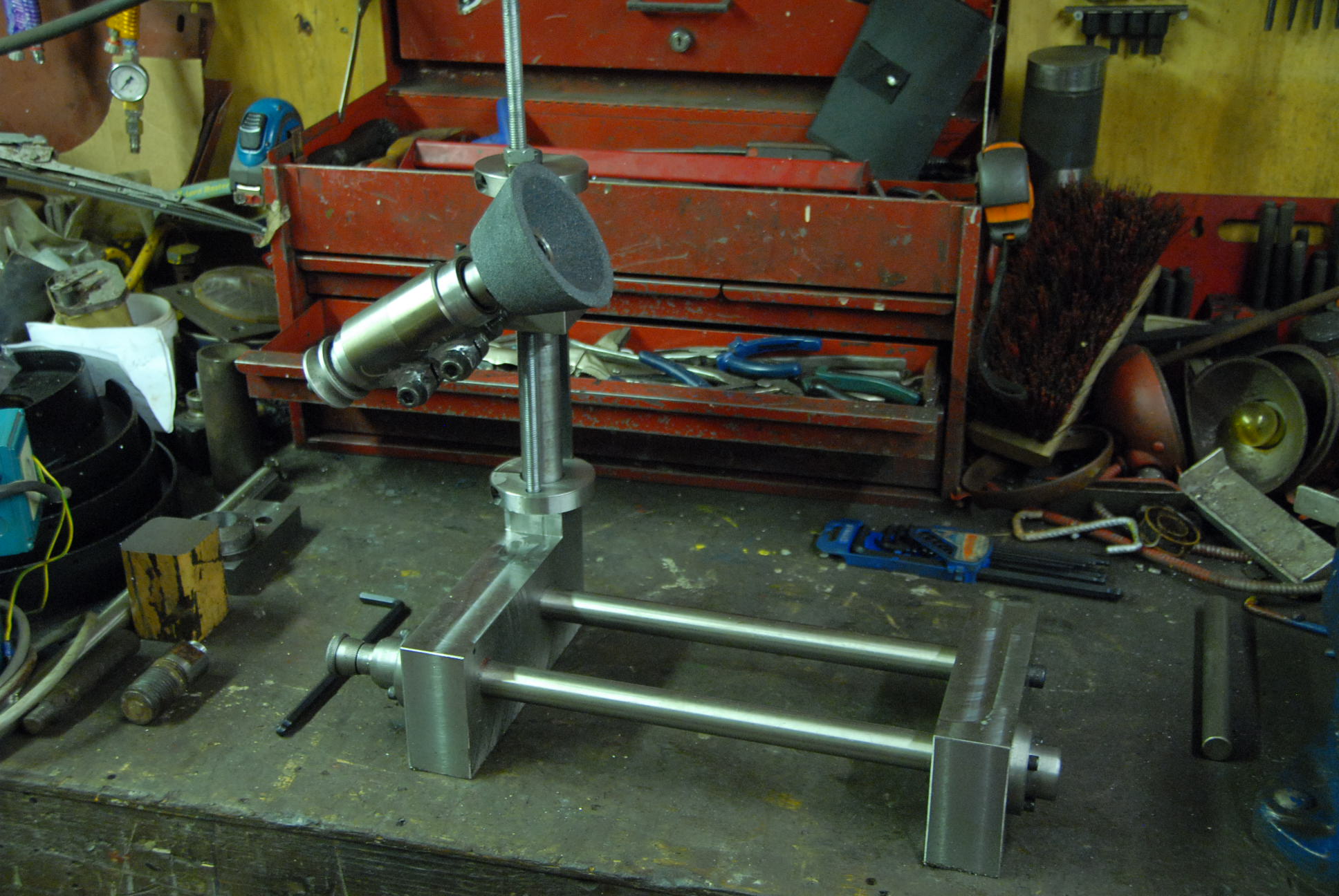

Have you given much thought to the workholder yet? I was thinking of ER32 / ER40 collets if I get the circular tuits, have some chunks of 22mm ground and hard-chromed rod and big ally blocks stashed away, along with a 3/4HP DC motor that I could put a (to be repaired KBIC) speed control on... And some fat stainless that has a lapped-fit rod through that could be an air bearing in another life? Put the two together stood upright trapping air on a greased plate and the rod spins for a couple of minutes with a hand-twist...
I guess you've already found https://www.gadgetbuilder.com/Brooks_Grinder.html, and his 4-facet / split-point drill sharpener that could be sat on it quite easily https://www.gadgetbuilder.com/DrillSharp.html ...

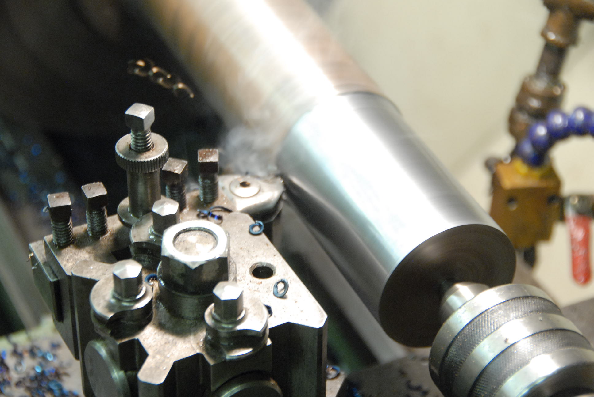

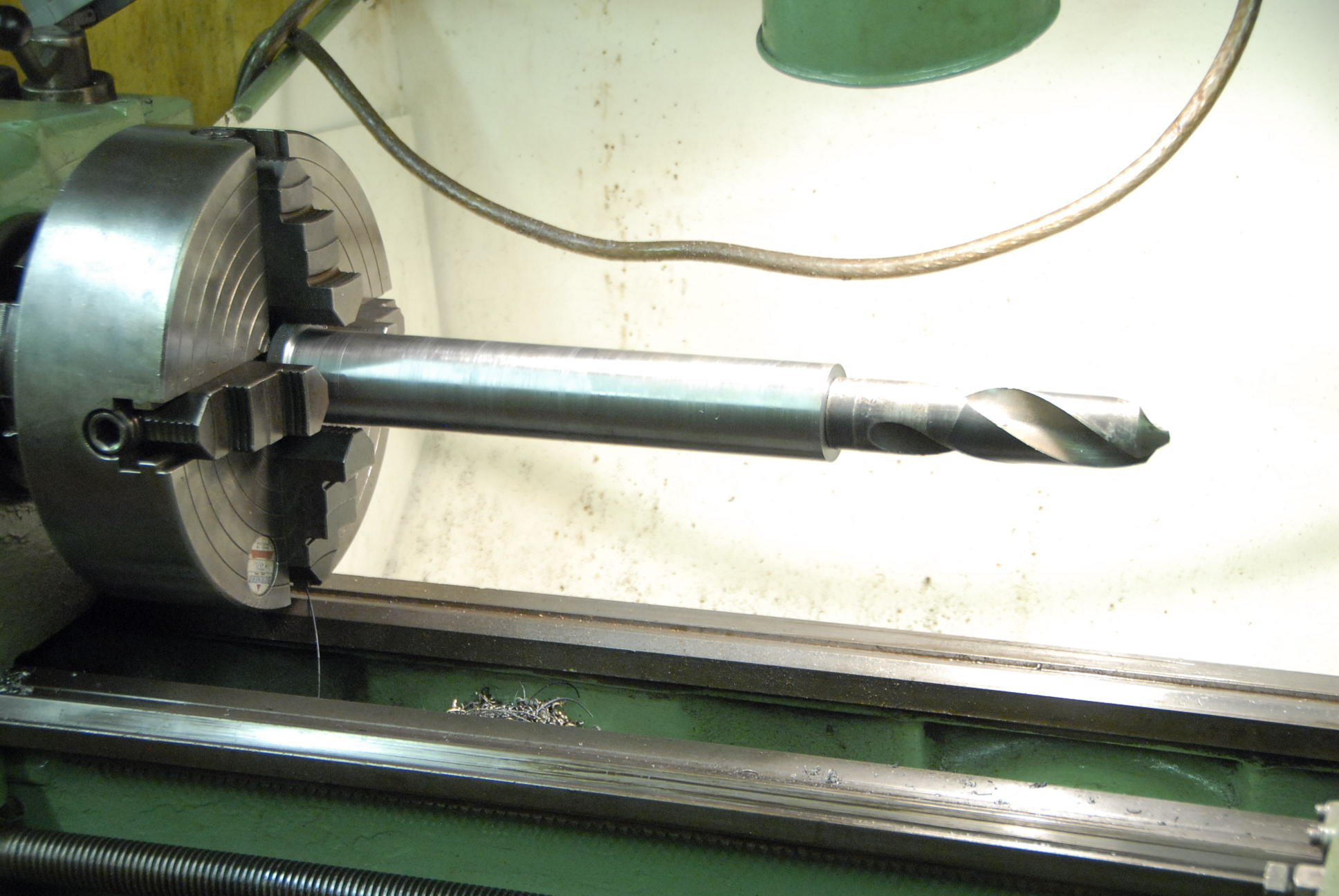

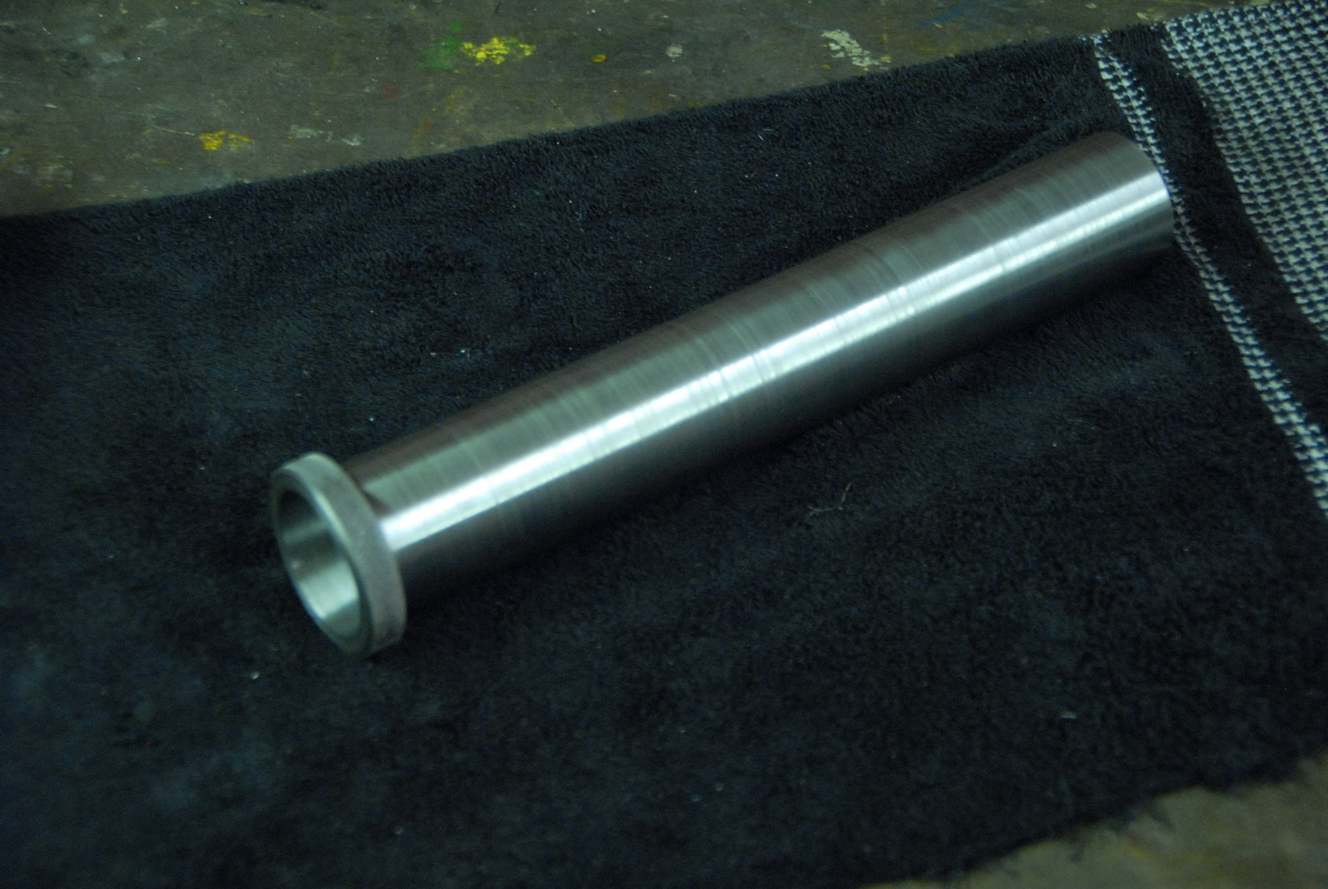

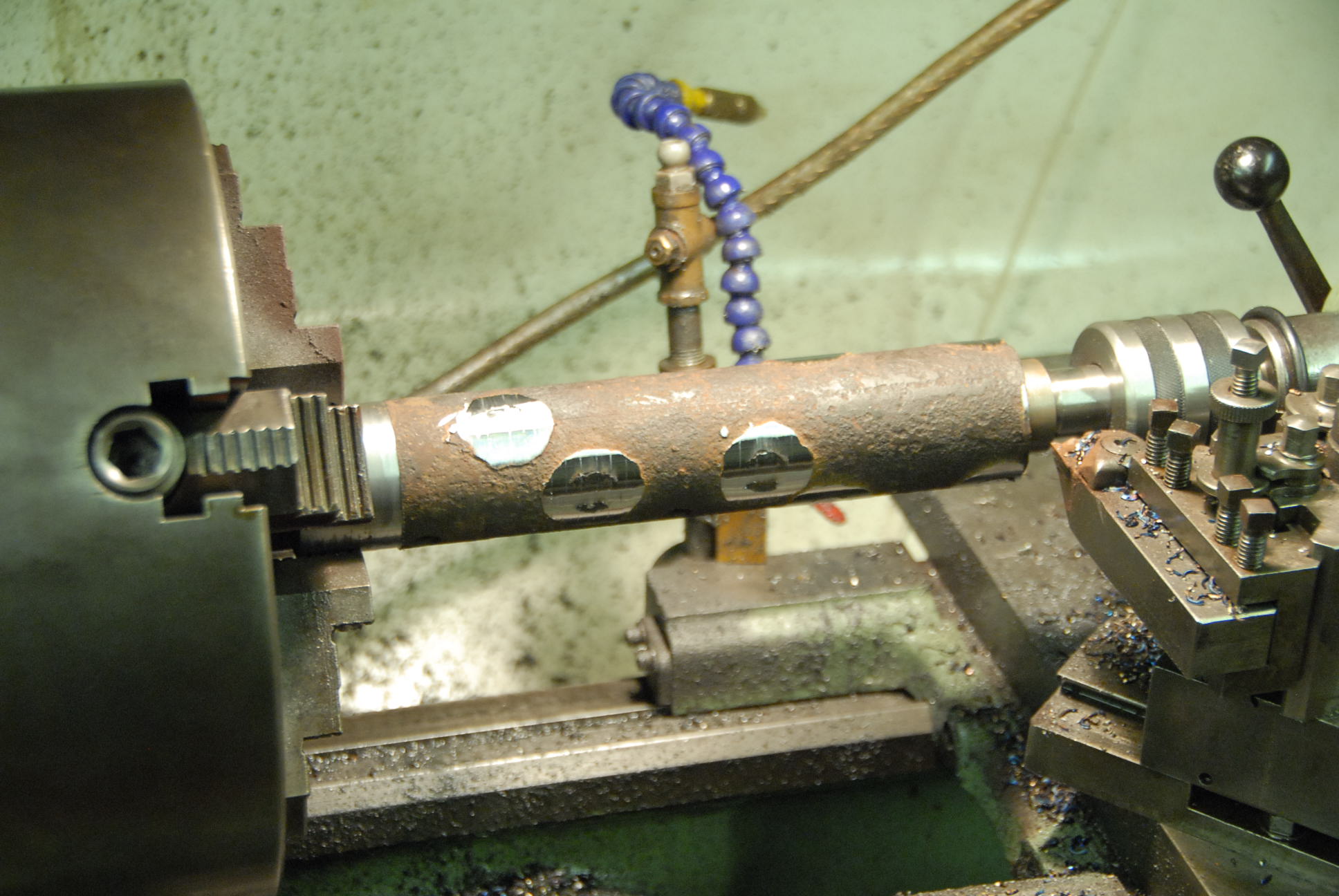

Rods out of hydraulics are 'kin hard, usually hard chrome over a hard skin - often cut OK once you're through the first couple of mm, but it's getting that far... cover the lathe with a bedsheet and clamp an angle grinder (weapon of choice!) to the toolpost, 20 rpm?

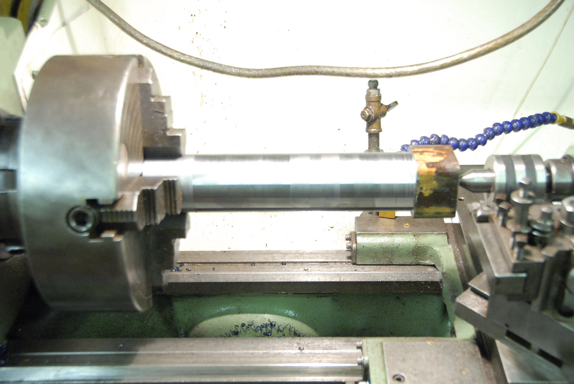

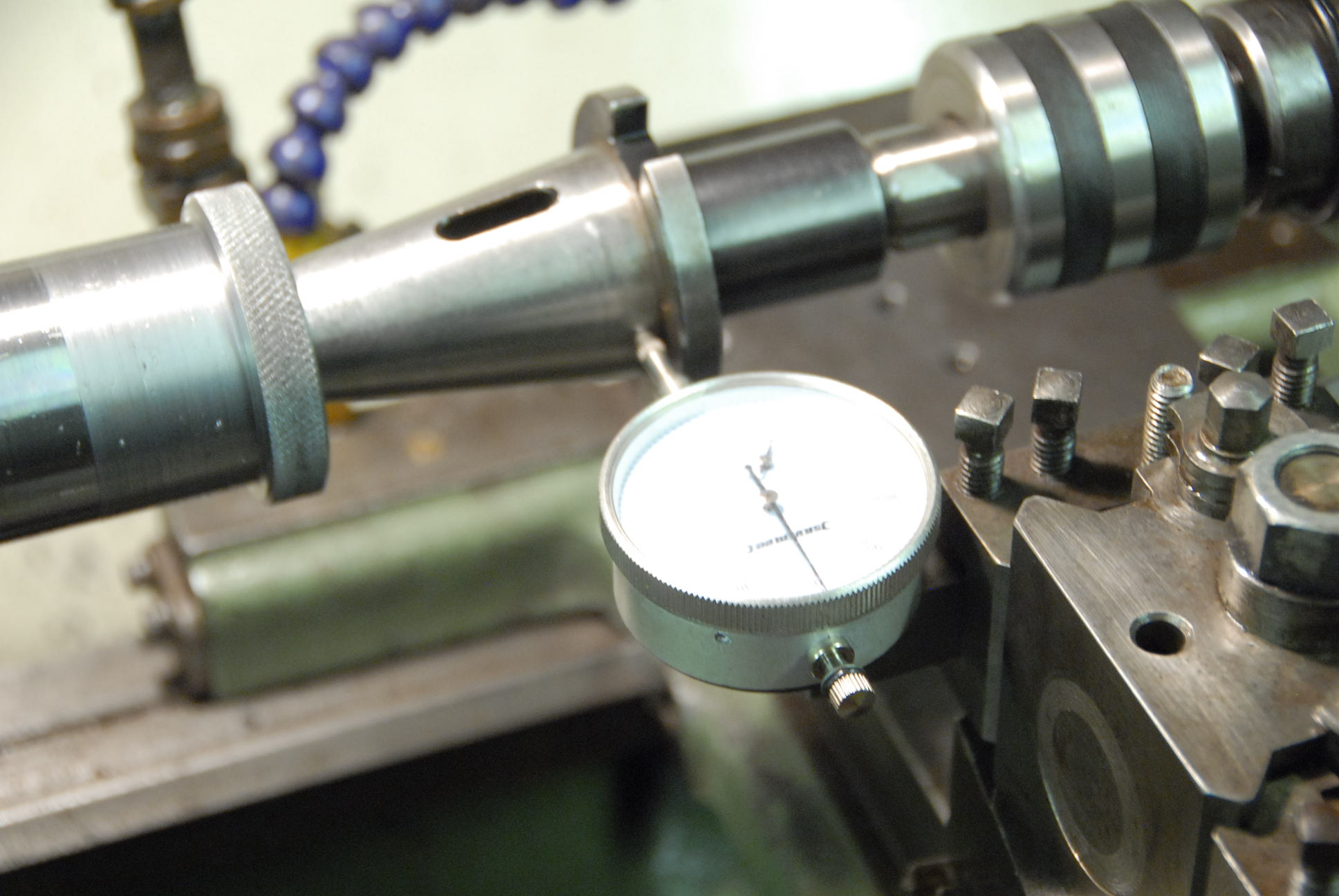

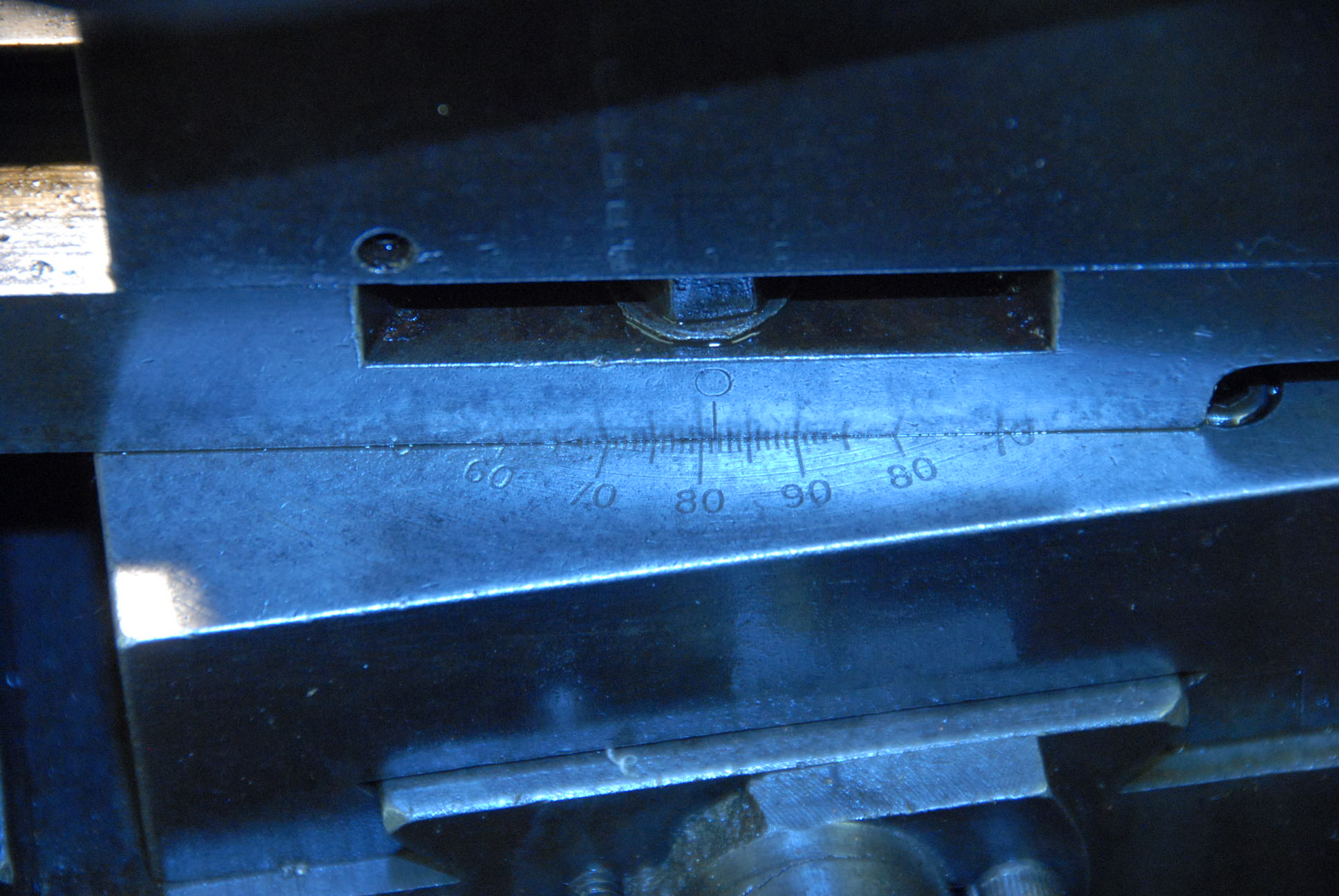

Are you offsetting the tail stock to cut the taper
