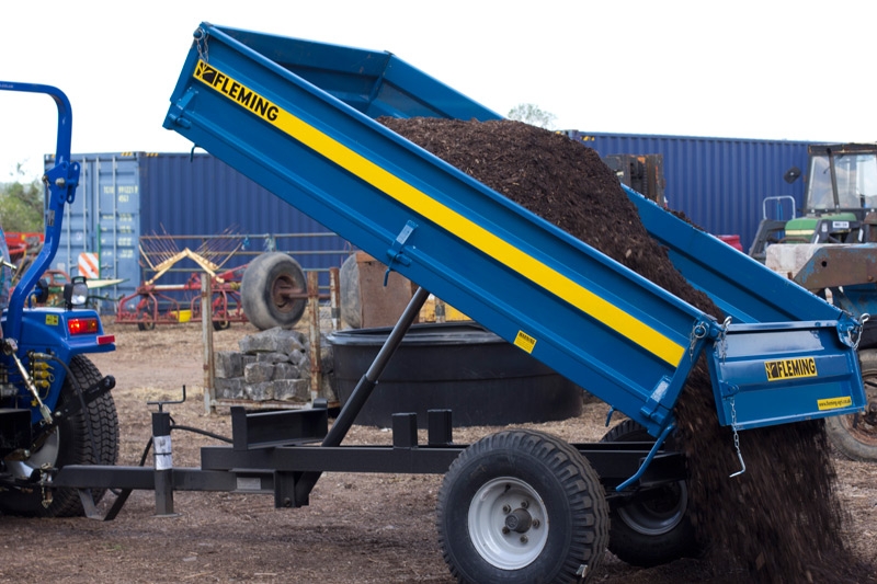

Looks like there's just two tabs holding the axle in place? Surely it wouldn't be a massive job to grind them off and fit new more substantial one?
It's a box section chassis
OK, just not up to speed on what is OK on UK roads now. I, assumed any trailer that was on public roads must have suspension, even if it is that apology called Indespension
I bet it MAM is around the 750 kg mark though you can tell that by just looking at its scale and construction it's only a garden ATV trailer with a designed speed not exceeding 20 mph so will not need any suspensionThat trailer will not be road legal.

Other than that though it's OK though, yes?That looks like it is designed for well over 750kg. I bet its getting close to that empty.
The tyre tread is not covered by the body, no secondary coupling, non road use tyres.
Towed behind a car so doing in excess of 20mph.

I don't see it being towed behind a car in any of the pics !! Tyres outside the body does not apply for agricultural equipment including groundsman equipment turf tyres well as long as they have the correct rating and there disigned speed is not exceed they would be legal for agricultural ground care use
Weld some flat stock on edge to the top of axel and it’ll be fine.

. Welding on top Not the perfect solution but it’s the easy solution and probaly enough. Any more effort and I’d swap the axelproblem with welding ontop is it can only be a short piece before it hits the chassis.... can weld to that but still makes that the pivot point (where it's already bent)
better to have a long piece run the full length on the bottom of the axle
