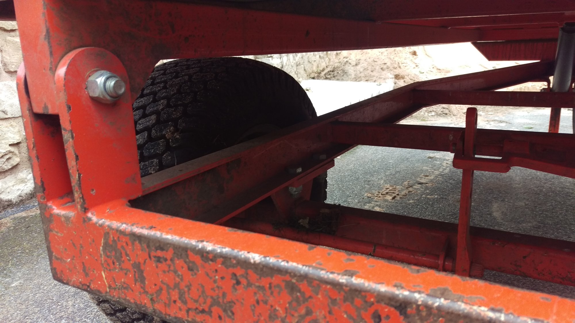

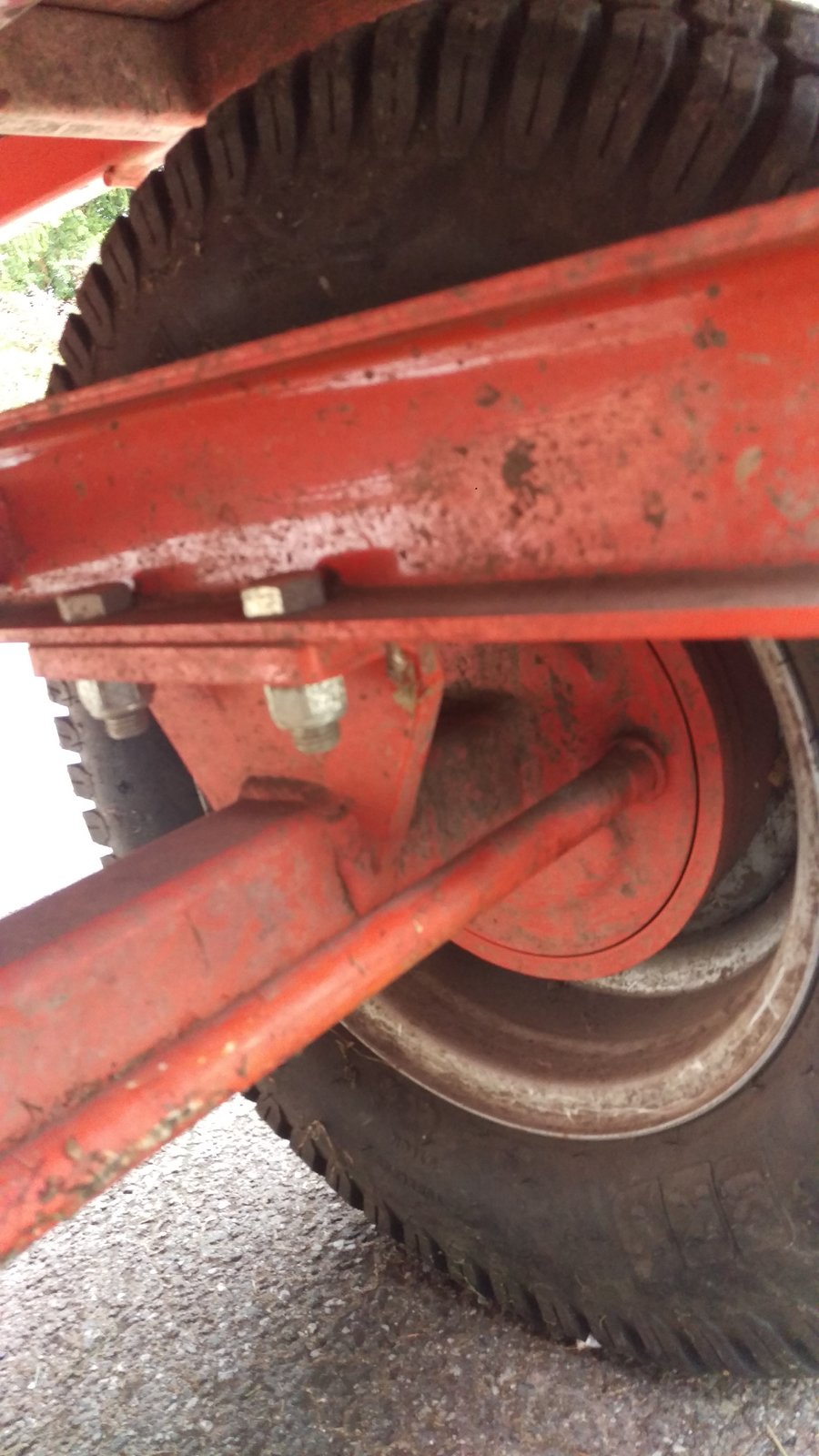

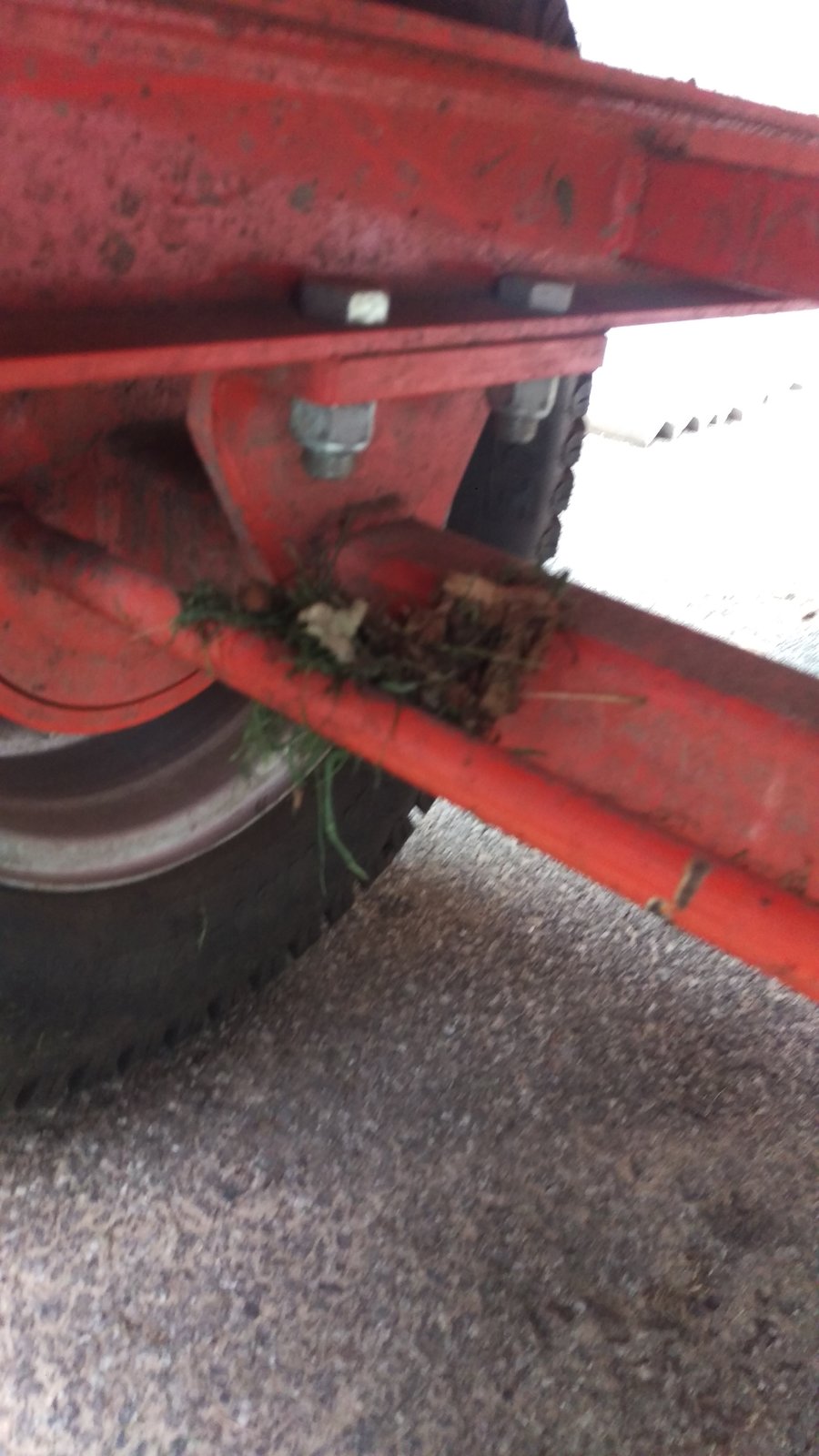

Hi, Triangulate on top from as far out as the wheel will allow up to the top of the chassis rail, do both sides and a piece of box between the top of both rails, which will effectively increase the size of the axle. To be honest if they continue to overload and abuse it, it will then probably bend at the smaller diameter where the wheel/hub goes.
