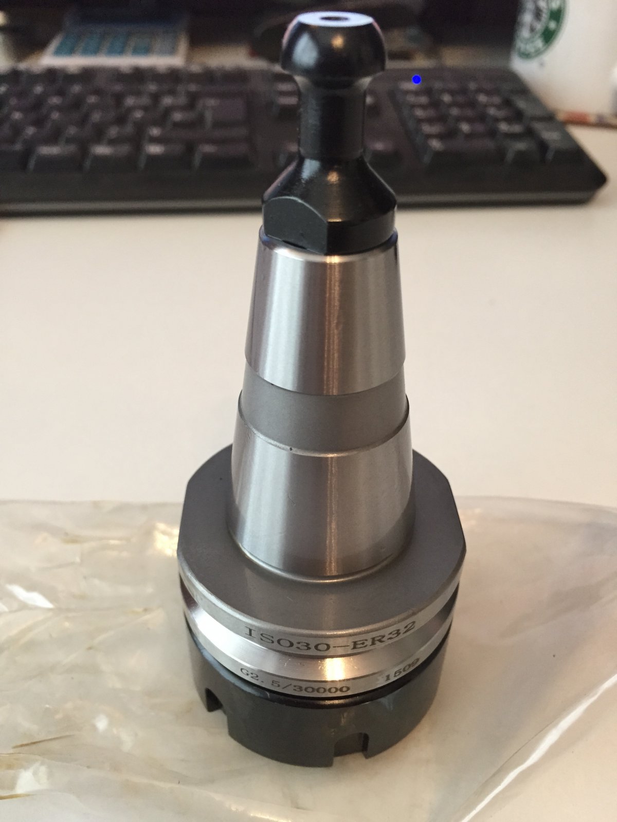

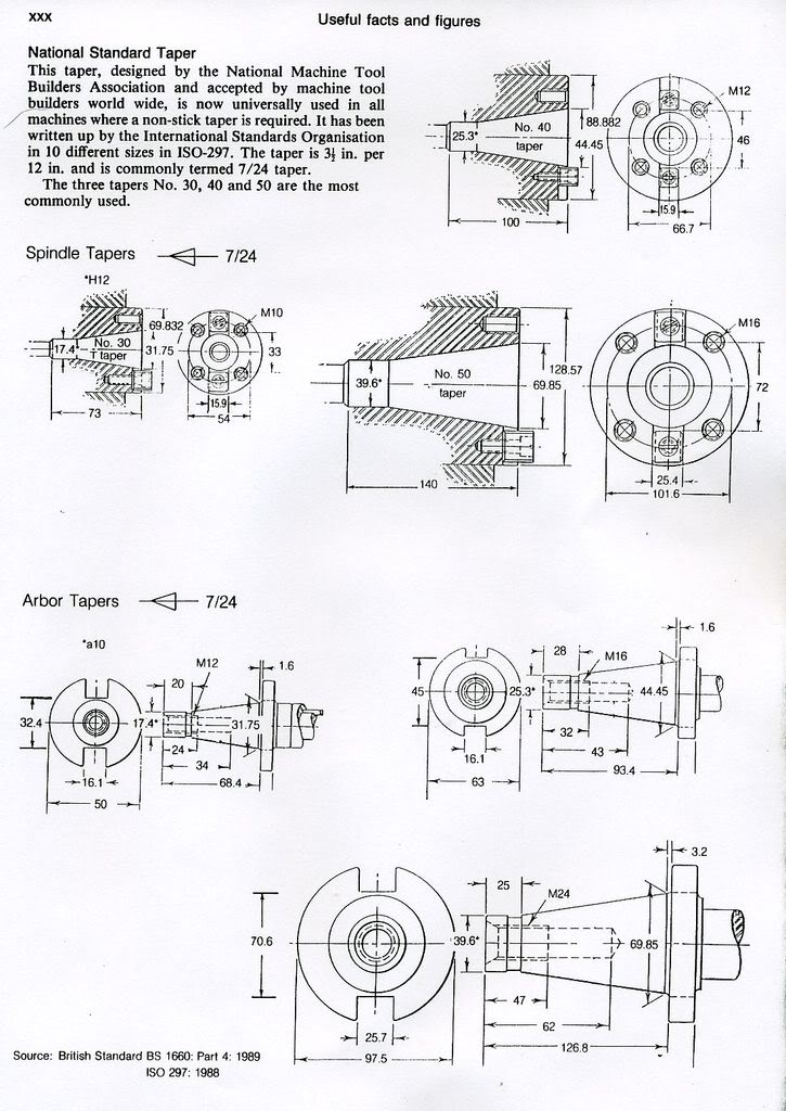

oh right I wondered what that was . So I could use a mt3 collet chuck or something in that ?Definitely INT something. You've got an INT to morse adapter in there at the moment.
.the r8 is grand but the int30 or above would make for a more solid machine, wouldnt mind if mine was above a r8 but i have a lot of the r8 stuff now and its grand for what id do.What about r8 ?
