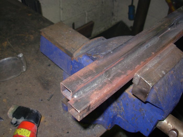

heres a fillet done with an old scratch start inverter, 6013/2.5mm. 90 amps or there about, material is 1.5mm. you dont hang about.
..and just to show i'm not perfect you can see where i burned through at top right of picture.
thanks sparkey, off now for 6 mile (5 mile = 8 km) forced march (a jog) around london. fitness is very important for your welding. the secret behind that weld up there though is practice, practice, practice. have got carpel tunnel in my hand from practicing that weld, was up to high for me and wrist was bent to much, a well, no pain, no gain.
Lovely clean material youve got there Matt... whats the steel, HRP&O?
