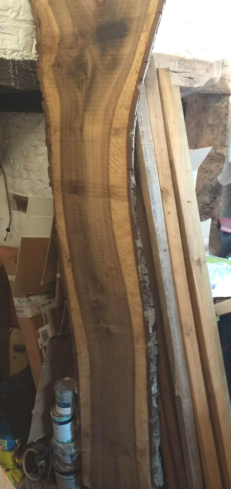

You mean like thisI am wondering if there some way I might be able to hold this monster log up high enough to roll my bandsaw alongside it. I mean, it is on wheels.

Current status is that before I could establish whether or not this was a 200 year old black burr walnut, I had committed to acquiring it. Yes the heartwood is disappointing. It is what it is.
It is now sitting in my garage area and I have three options.
1. Leave it where it is
2. Chop it up for firewood
3. Slice it up for any useable stock
1. is tempting but I have already done that with some plum cherry. Clearly 2 and 3 are so similar in both process and potential outcome, I might just as well aim at 3. I have to chop it up anyway so when I inevitably chop it up, I might just as well see if I can develop a diy process for milling lumber. If it doesn't work, I will have some nicely sawn firewood. Currently I do not see any possibility of getting through next winter without greedy utilities companies bankrupting me into destitution. I might need a decent stack of firewood anyway.
On the other hand, if it does work, I will end up with a lovely curtain rail.
I am more interested in learning how to do it, doing it and learning from doing it. Next time a tree pops up I will know what to look for and even if I ruin this piece but still have all of my appendages, I might expect to do better next time. For those of you who enjoy rude health and easy money, I can see why you might want to poo poo this project. Currently, time is all I have so I choose to do with it as I please until either the NHS sorts me out or I turn into a mindless zombie.
