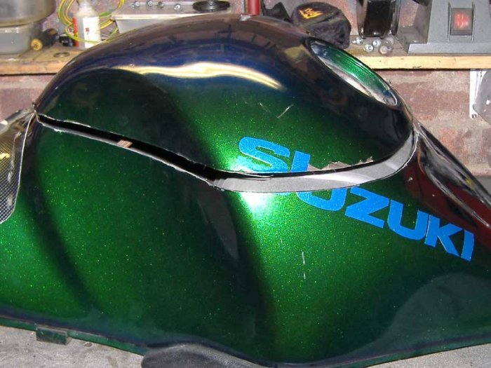

Would you rather Assume or do it right and use a meter. You might only get one chance...Bob
This is one similar to what we use in the refinery. They are the only way to be sure...Bob
http://www.rkiinstruments.com/pages/gx2003.htm
Awesome tool but unless you have one at your disposal, I think he could by 5 gas tanks for the price of that unit.
Yes. Argon or CO2 as a safer alternative to exhaust gas?
Breathing Argon or CO2 might be a better option, but you need the high flows to keep purging the tank of flammable gases.
- David.
Just drain out the fuel and leave the filler cap off for a couple of days.
