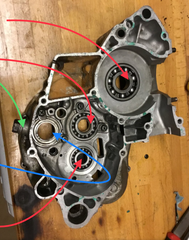

The 'crankcase' is usually 4 pieces.
Two halves of the crankcase proper (where things like the sump plug live) sandwiched between the generator and clutch covers.
The two outer covers will be the magnesium parts. The actual case is more normally alu.
This is my understanding. Again limited knowledge.

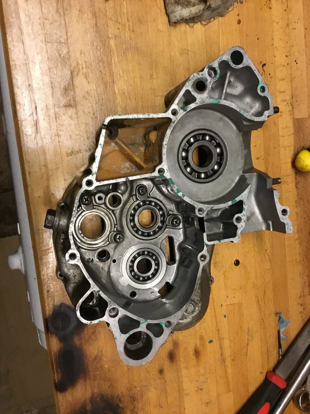

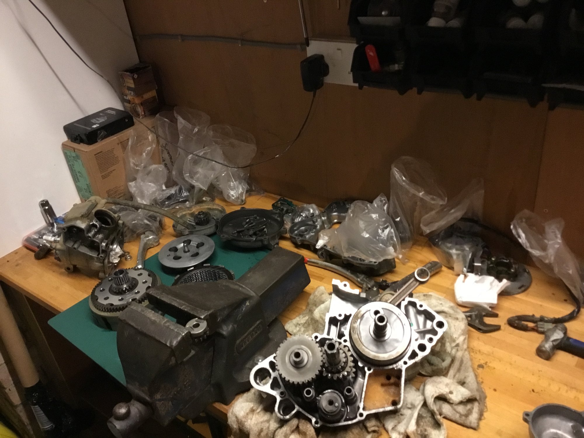

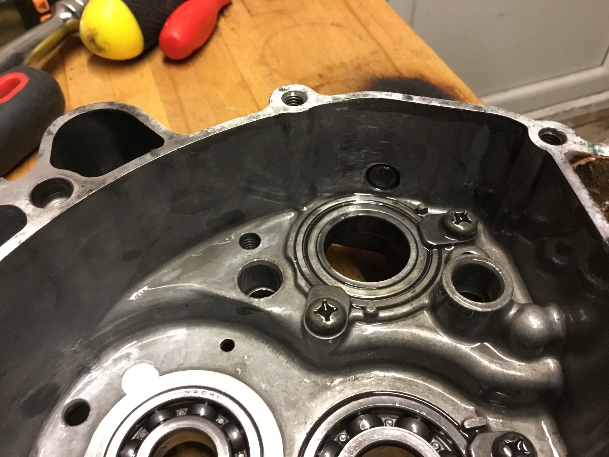

I’m not sure what other bikes are like but these off road bikes come apart really easily. 1 hour yesterday evening and 1 hour tonight the engine is out and I’ve never done this before.

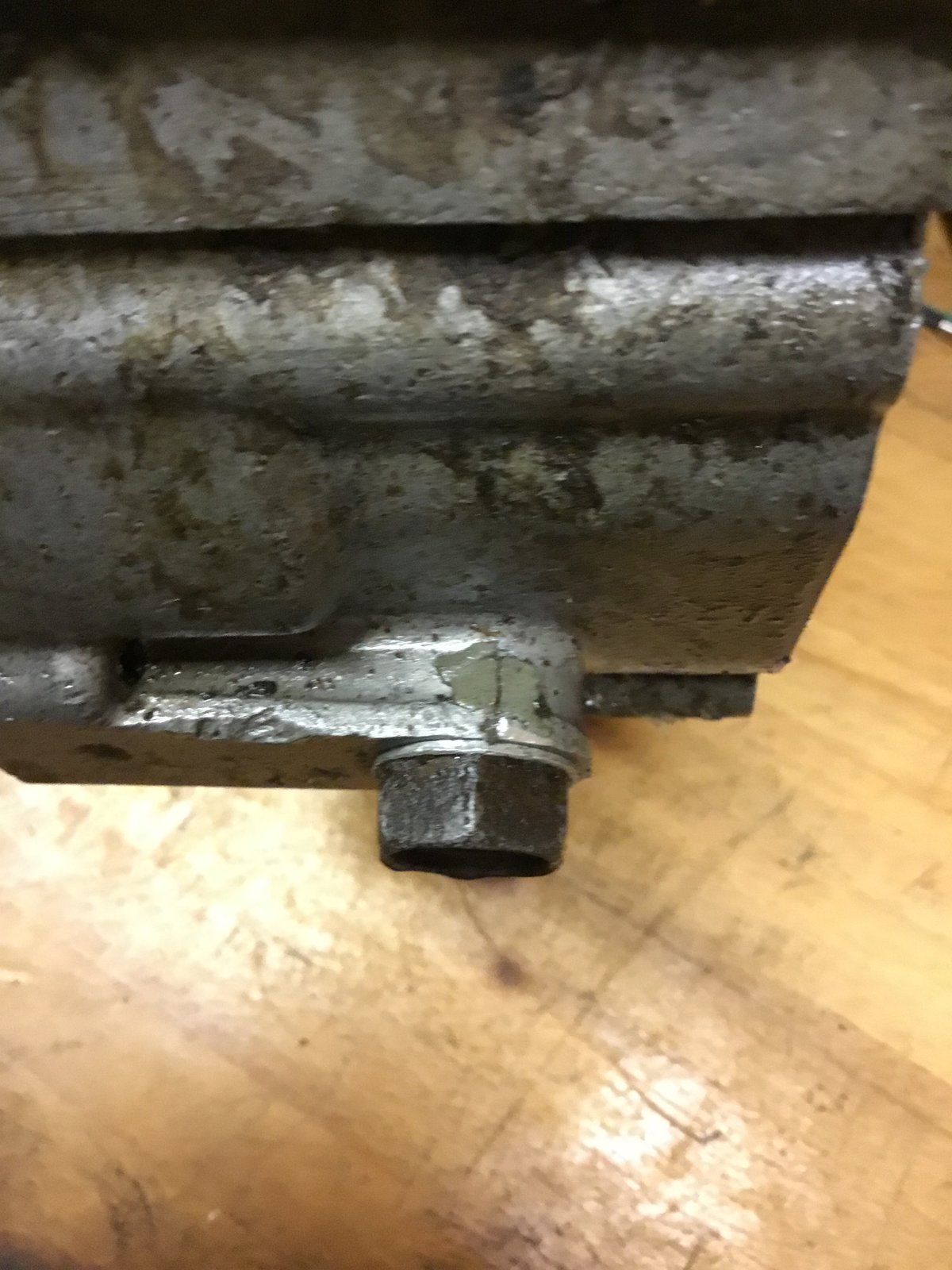

Whilst looking on eBay this crack is a common problem. I looked at 3 suitable crank cases and they all had it cracked in the same place with some form of glue smeared all over it.
@Richard.
I have the m14 tap, 12.7 drill and the new sump bolt. Can I send you this to add onto the job or would you prefer not to?
I’ll post the part and come and collect it afterwards to save you having to mess about packaging it and taking it to the post office yourself. I’m several days off as I need to beg, borrow or steal various tools to do this.
