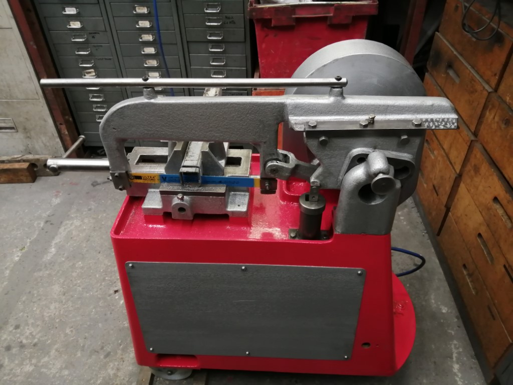

Im not knocking you. More respecting your talent and abilities to make something the best it can be.Scraping is the best way to ensure the slides stay oiled. Machine depends on that so it makes sense.

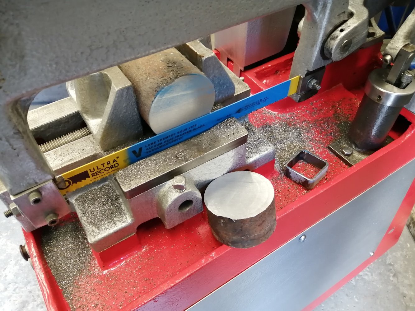

What thickness carbide and do you normally need to relieve the bottom of the 'V'?

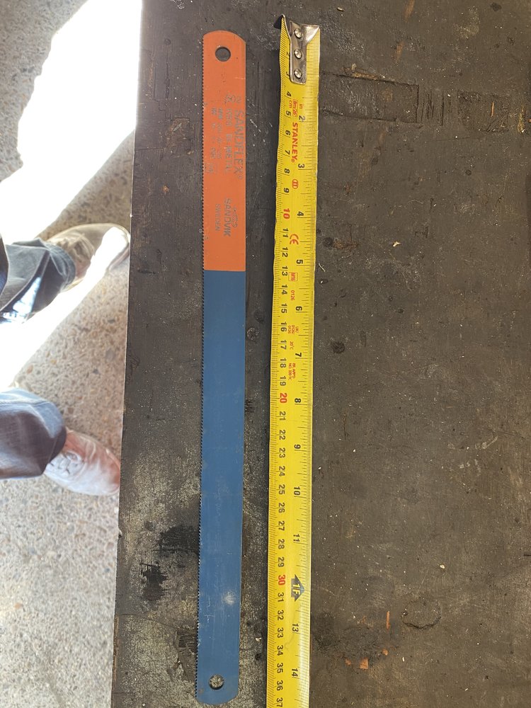

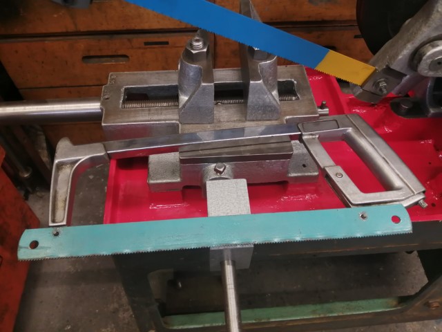

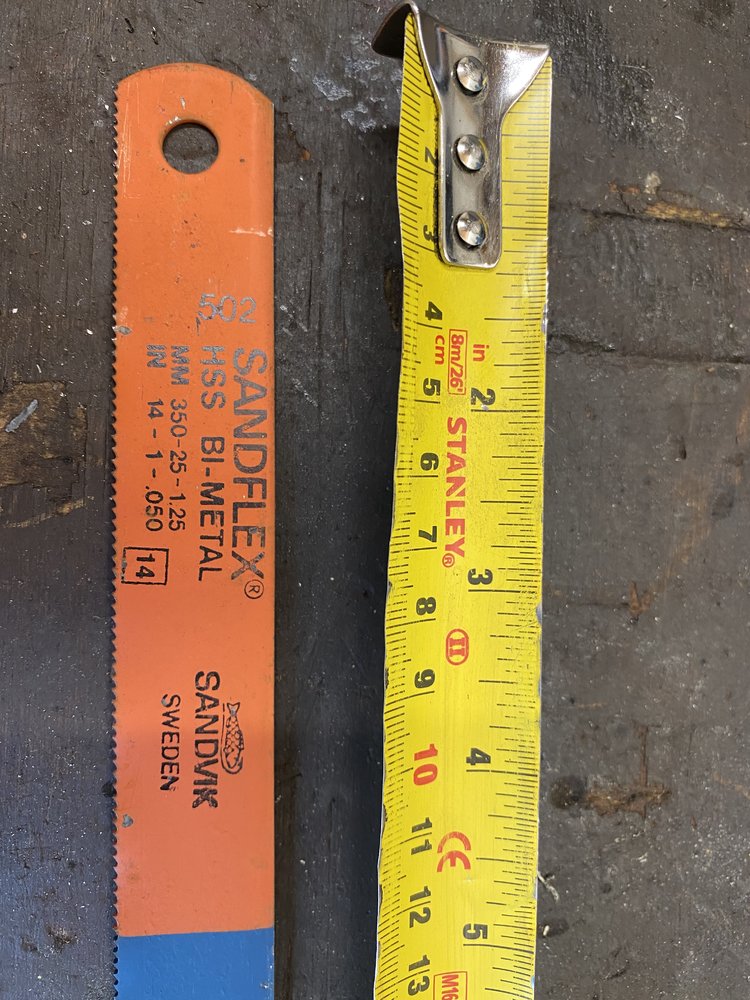

Sorry to get your hopes up, but they also fit my old Manchester saw. Or at least they will do when I put it back together again!If there are any blades looking to be rehomed, they would fit mine
Not a problem. Will buy someSorry to get your hopes up, but they also fit my old Manchester saw. Or at least they will do when I put it back together again!
i have some i bought from autojumble 3 quid a piece 14 inch for rapidor if u want some . dunno what postage is mindNot a problem. Will buy some

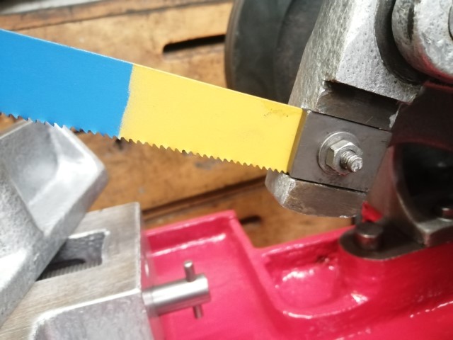

your blade is in reverse there normaly forward .they are on the rapidor

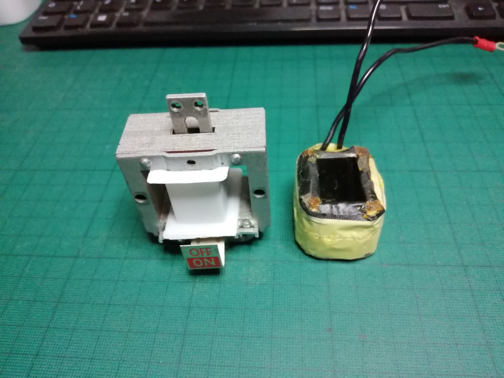

Could of picked you up a winding machine the other weekI ended up winding a new coil for this contactor. The lead wire had broken off the winding, which I re-soldered but I found that the coil was very weak to pull in, not surprising since it's supposed to be fed with 415v and I'm only giving it 240v.
So I 3d printed a bobbin to fit the hole in the contactor:

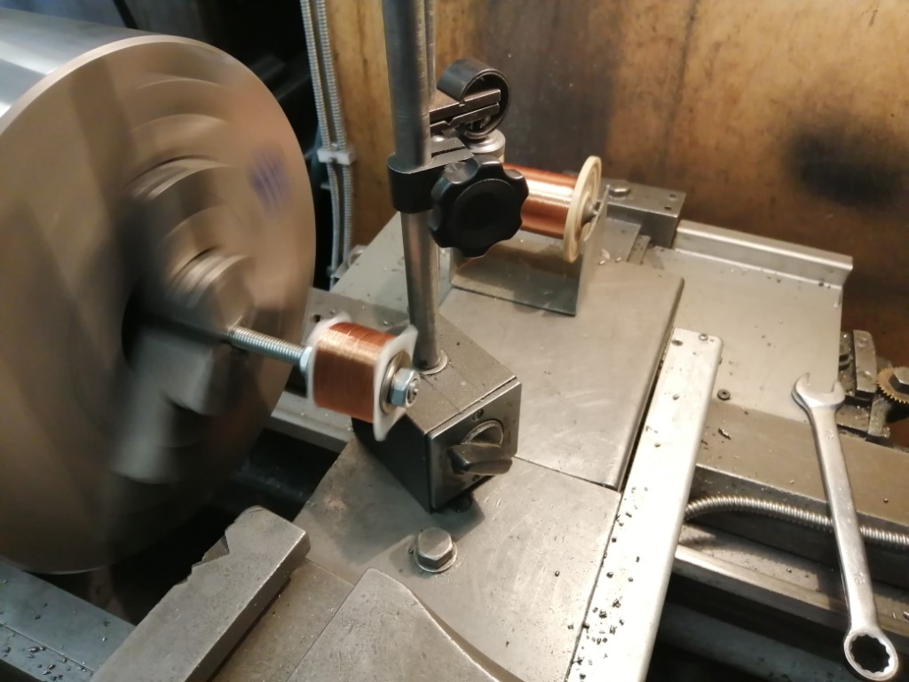

Then I would it full of 0.112mm diameter enammeled wire on my patented coil winding setup
I soldered some leads onto the winding and taped it up temporaily for a test. Fitted the new coil into the contactor and it works like a charm.
Contactor test
Just got to remove it again and impregnate the windings to stop them rubbing and shorting out.
I need a new 415v coil for a Schneider starter but RS components want £35I ended up winding a new coil for this contactor. The lead wire had broken off the winding, which I re-soldered but I found that the coil was very weak to pull in, not surprising since it's supposed to be fed with 415v and I'm only giving it 240v.
Contactor test
