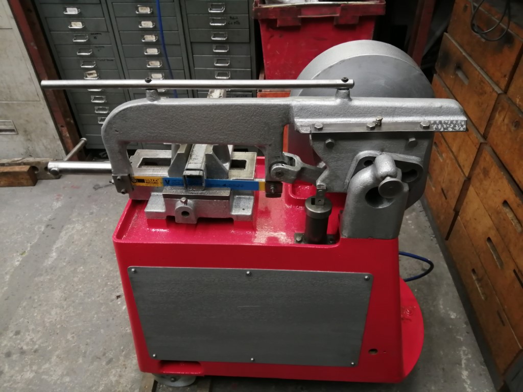

Very, very minor observation: perhaps make a longer nut for the blade tensioner as the projecting thread at the moment offers potential for laceration.

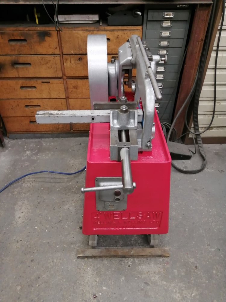

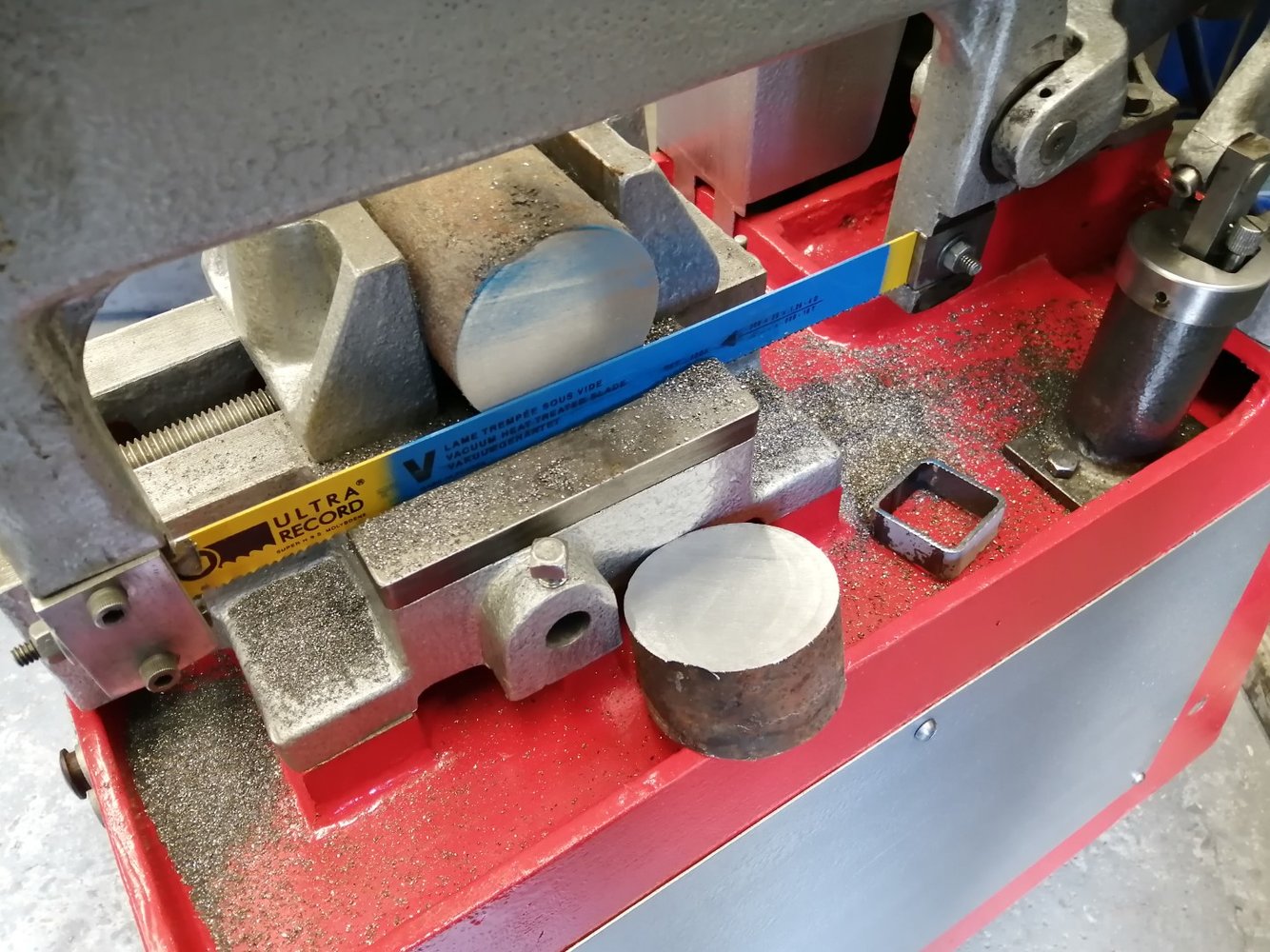

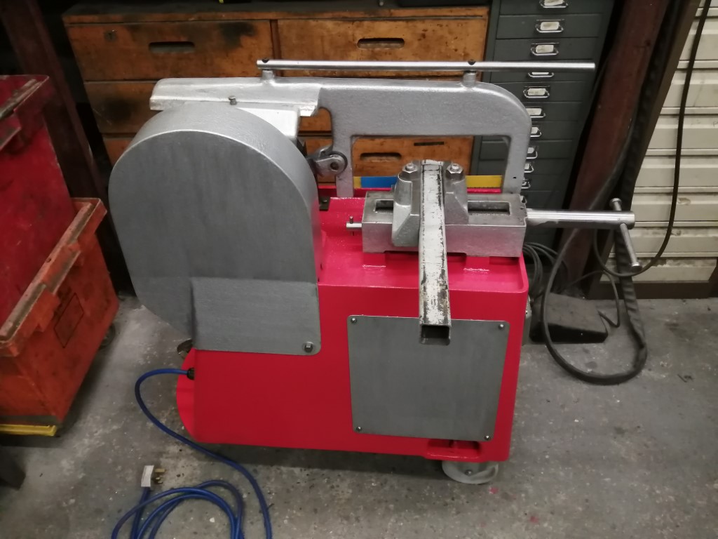

Looks a nice clean cut there @Pete.Contactor is now re-assembled, time for a good test cut. This is 70mm bar and it went straight through in about 8 minutes. Happy with that
I remember your look of shock when you saw the size of the hacksaw but it’s turned out a nice little chap
The power lead is like a leash holding back a dog when a donkey saw is on castor sLol yeah I imagined it to be a bit larger from the pics. You're right though, it's turned out to be just about ideal for my workshop
Yes mate it does cut nice. I have to find some locking casters as I do need to be able to move it but I can't run it on the wheels because it dances all over the workshop
Lovely bit of kitThe saw is back together and running. Make very nice tidy cuts, I tested it on some box section.

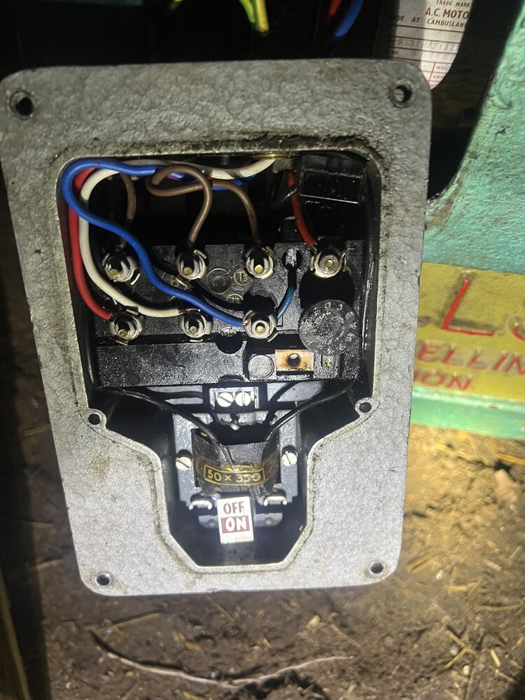

I do have a few small jobs and some teething problems to sort:

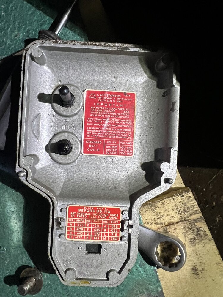

The 415V starter does not like the 240V motor, have to look at that probably disable the overload.
Fit the weight on the bow, I left it of for a test because it's sat on flimsy castors
Set up the oil damper
Recess the bottom faces of both of the vice jaws for better clamping. Right now they can turn too easily even when tight.
Find some better (braked) castors so that it doesn't dance all over the floor. Even without the weight fitted it was walking about the place.
Scrape in the remaining faces on the sliding ways. The geometry is good I just want the faces straightened up and retaining oil.

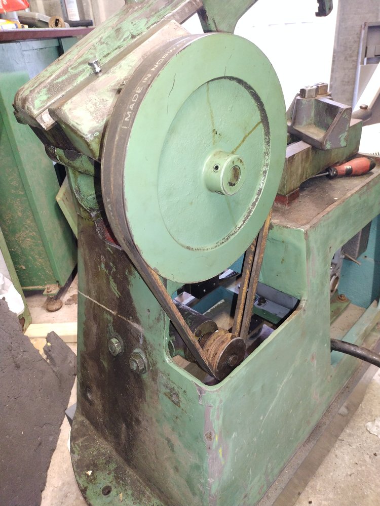

Very nice, could you please send a photo of the twin belt adjuster please.Lovely bit of kit
