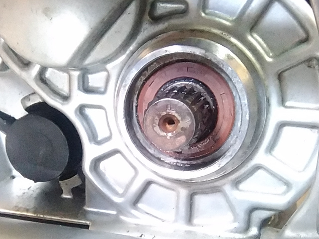

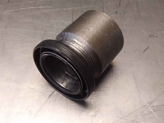

clever idea but whats up with mine?.Ah, might as well say - it's a tool for pulling the seal out of my bike's gearbox without stripping the bike down.

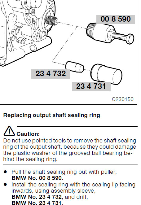

I love it when someone makes a factory tool..gives me great pleasure,good job mateyNothing I guess, though I don't know if the access would allow it. I just found a picture of the BMW tool and made something similar.
