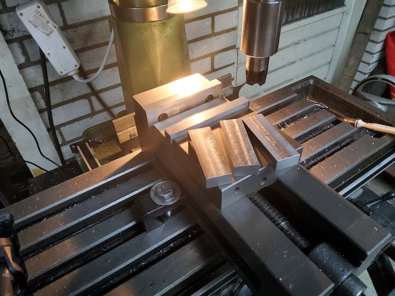

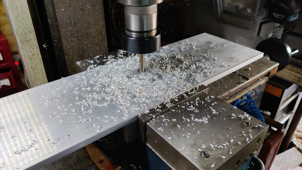

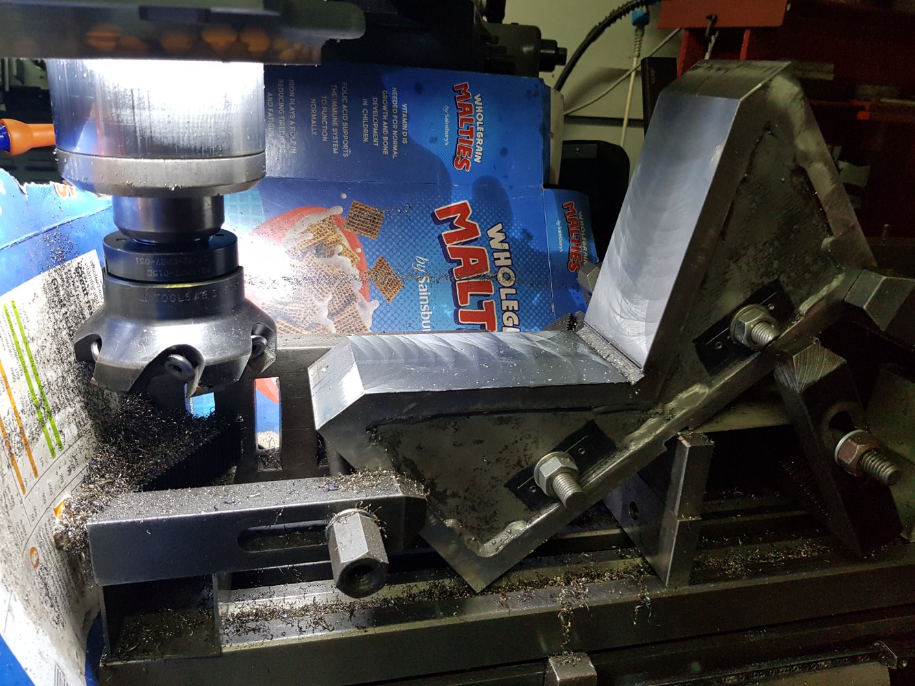

Someone needs some roof insulation....Some early-morning milling done at 4.30am before the heat of the day got too much to be down that end of the workshop:
Where would it go?! Every single joist in my garage is filled with clamps, french-cleat-mounted boxes of tools, various power tools, hammers & all sorts of other stuff. If I added roof insulation, it would have to go on top on the outside!Someone needs some roof insulation....

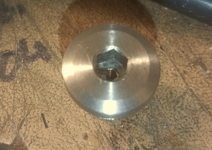

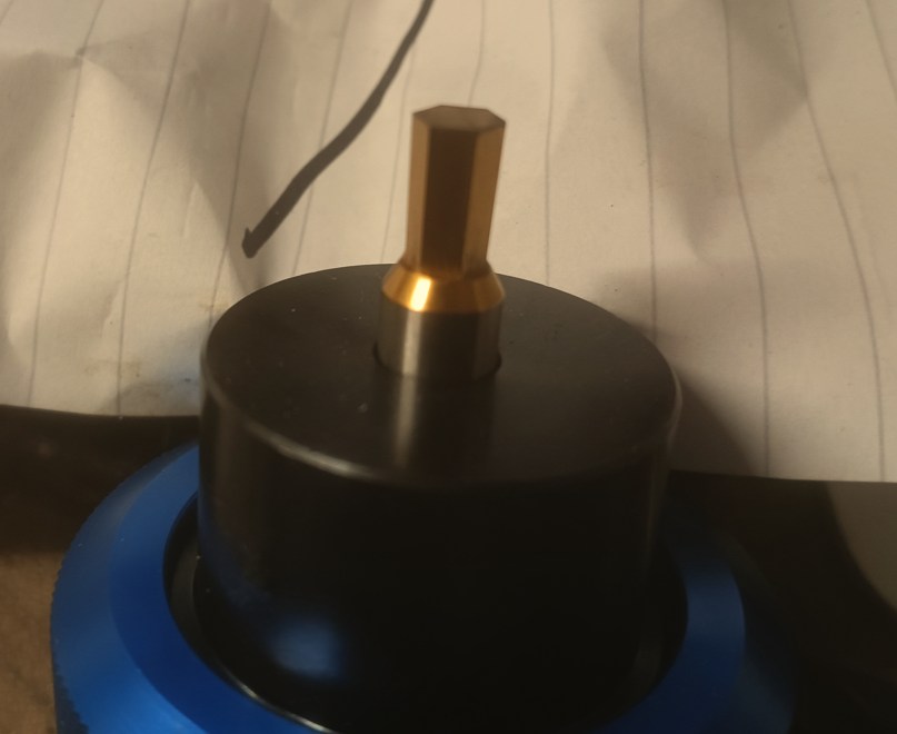

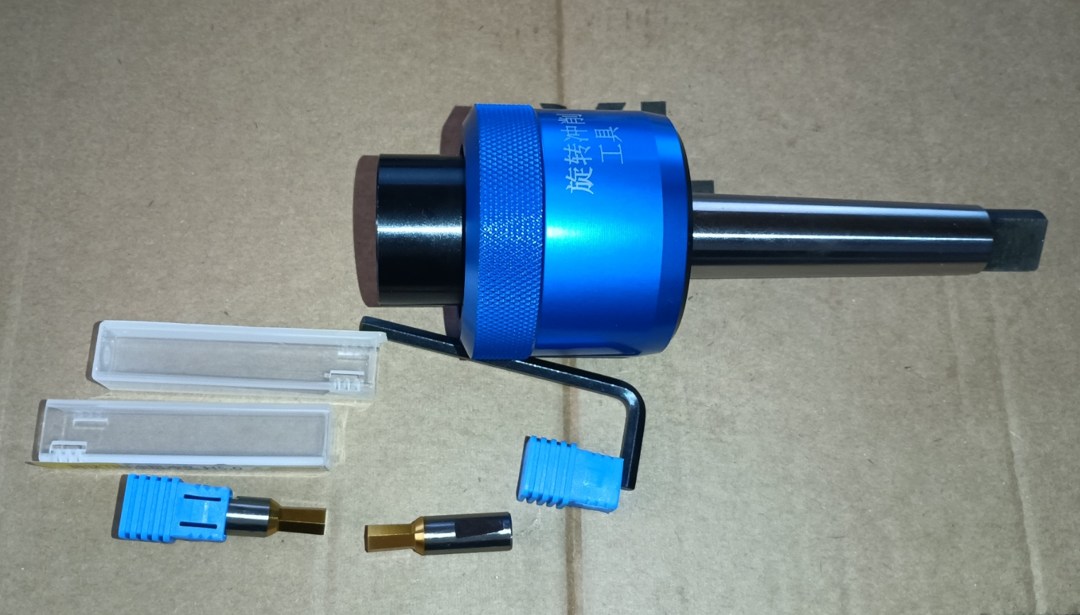

Please let v is know how it goes. Which make and model?The rotary broach and two 5mm hex broaches have arrived, they look/feel good but will they be up to the task of broaching a hex in 316 stainless? Time will tell
Not cheap by Chinese standards but if it works well then worth every penny.
No, there is cheaper about but this seems decent quality, fingers crossed it does as it is supposed toNot cheap by Chinese standards but if it works well then worth every penny.
Thats clever, excuse my ignorance but how does it work?Video
Pic of the hex.

Condition of broach seems fine.
My thoughts exactly, thank you for explaining @HoodThats clever, excuse my ignorance but how does it work?
That really doesnt look like it should work but it does!See here.
